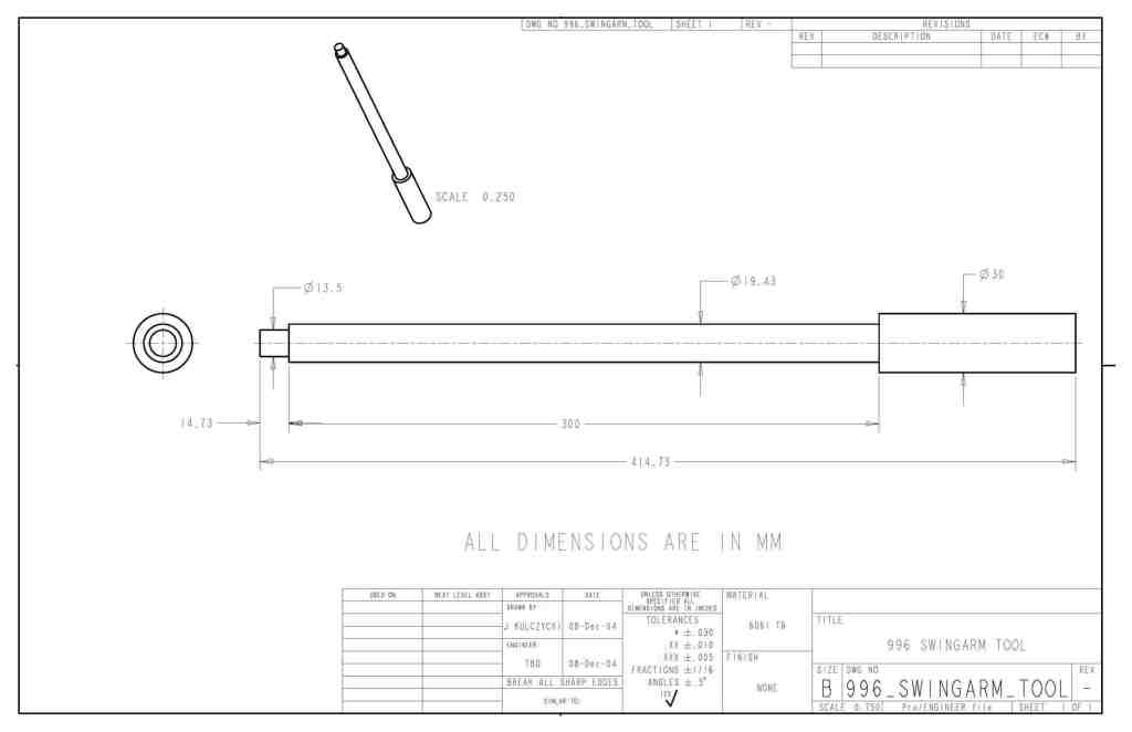

  5. The factory tool is aluminium. A steel drift flares the end of the axle and as it's a tolerance fit in the bearings and once flared, it ain't coming out other than towards you. If it's solid, then leave the bolt in, back it out a few turns and hit that to break the corrosion. Once it moves, it's pretty much job done. Most I've seen have been flared out of frustration and a steel drift..

  7. I have a local machinist making me a drift the same as this so hopefully it will do the trick while soaking it with some heavy duty penetrating oil over the weekend

  13. Hi Liam. How much and from what material please? Hopefully aluminium. Would he be open to making some more for us members? I have tried locally but no engineering shop is interested so far.
  14. I am having it made from stainless steel as that’s all I could get my hands on without buying a whole length of material. He’s doing it as a favour in his lunch break at work as he’s know my dad for years so unfortunately he wouldn’t be able to make them to order. I am surprised no machine shop near you will make one with it being such an easy job it’s a good money maker for them
  15. Ok no worries. I will keep trying locally unless @Jamie Clare is interested?

  17. See post 27. Is this something you could do on your lathe in aluminium? If so, stick a members price here and wait for the orders to come in. I would say there would be a reasonable demand if you check out the number of issues members have with stuck swing arm pivot bolts.

  20. How much would you pay for a tool like this and I’ll see if it’s viable.
