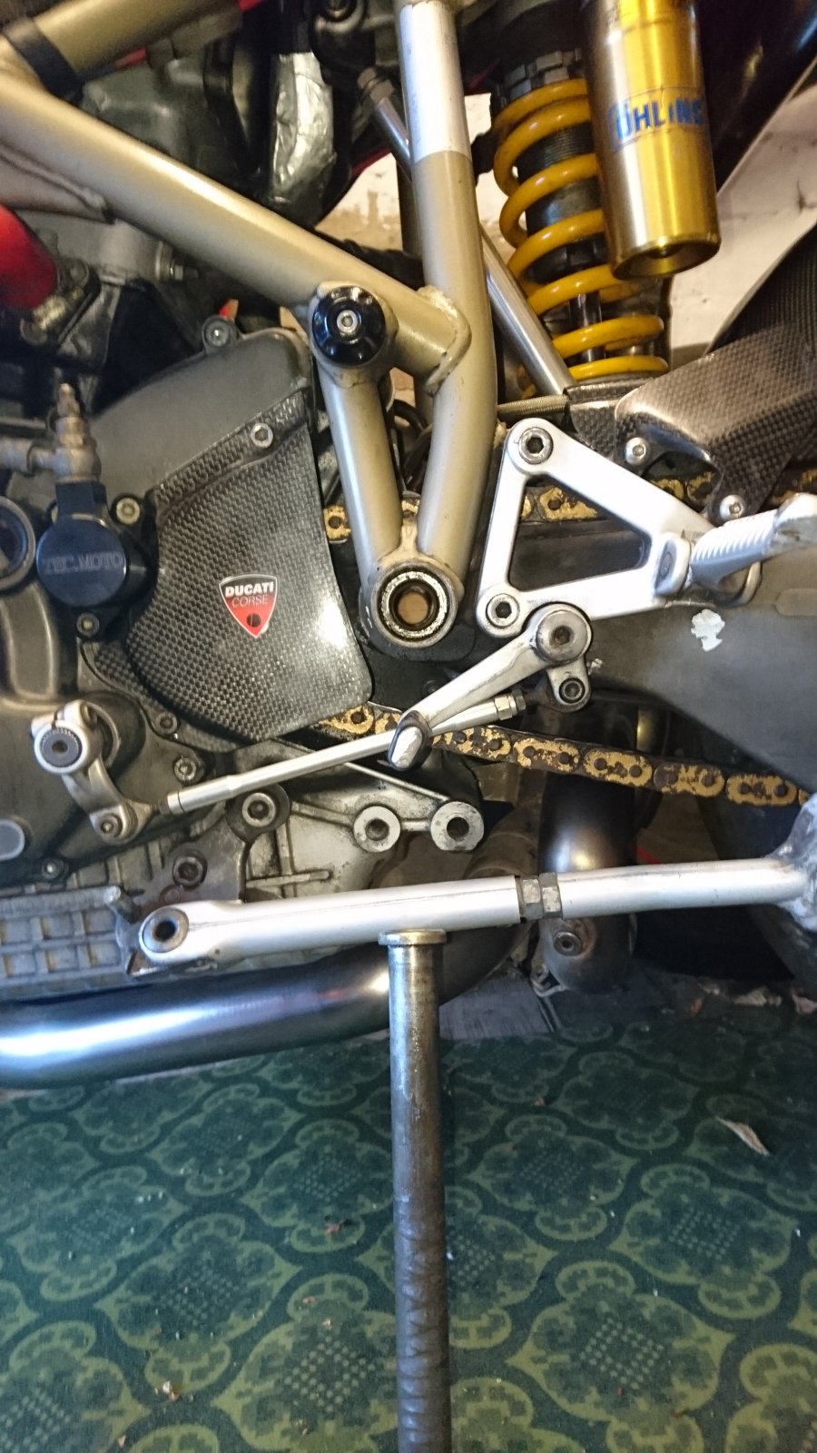

    Mine removed last service and it has had a new chain and sprockets since.
    Steve
