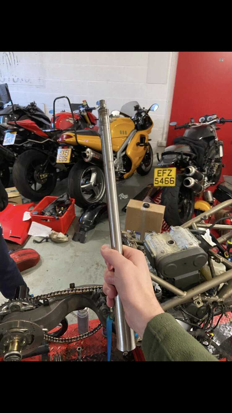

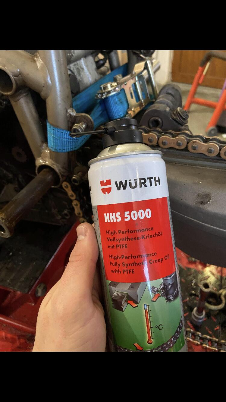

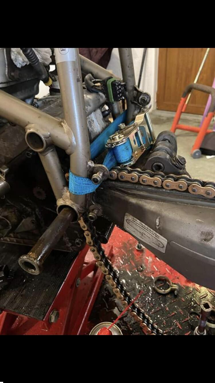

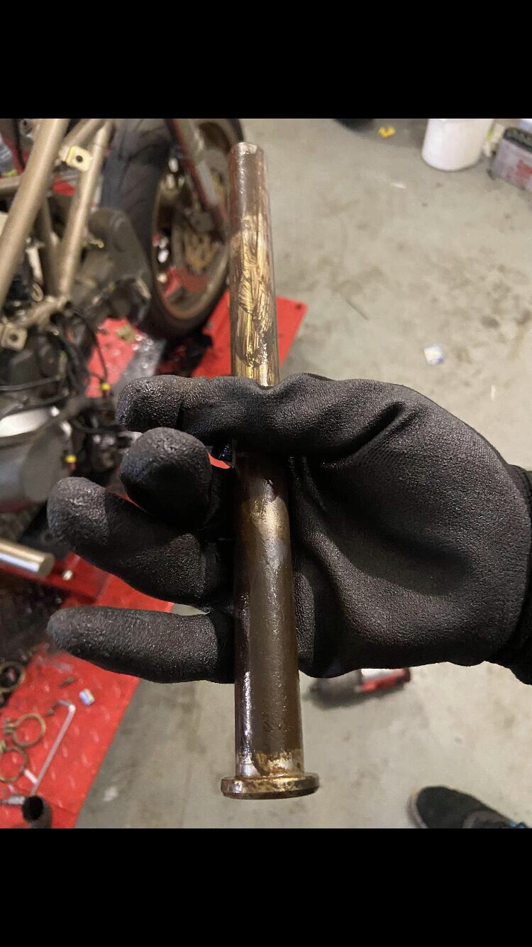

  5. VICTORY!!!! after a week of soaking with Wurth creep oil and a few good smacks with the new drift the swing arm bolt finally gave up with zero damage to the threads

  7. Looks as though it was ready for a bit of grease, now relax, that must be one of the worst jobs done.

  9. we can see how hard you've had to "lean on it", if not mistaken your punch looks belled at the end :upyeah:
  10. It has flared quite a bit Chris I am glad I had it made from stainless now
  11. Before you put that bolt back in Liam, make sure that you polish it. I used WD40 and 400 grit W&D paper. It cam up nice and shiny which is what you want.

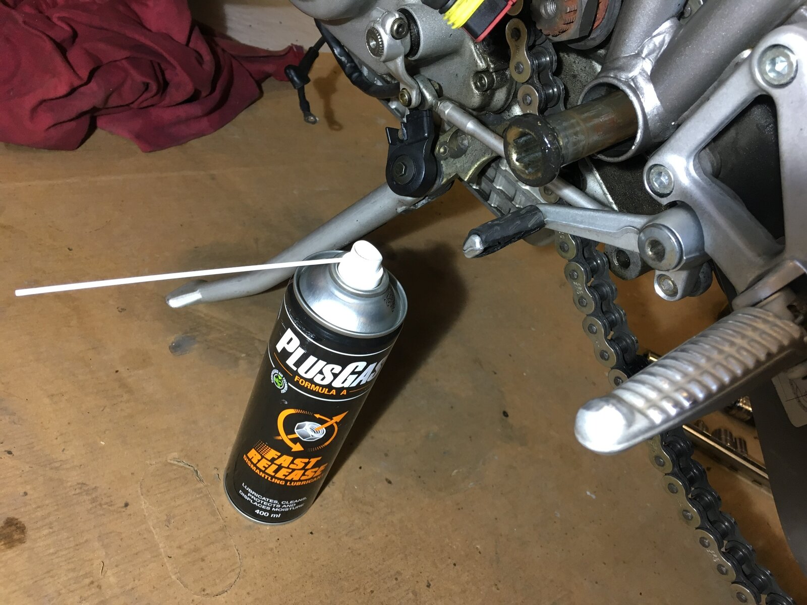

  12. I smell success.
    Plenty of plus gas. Bolt removed easily tapping out with 14mm socket on extension bar. I must be lucky.
