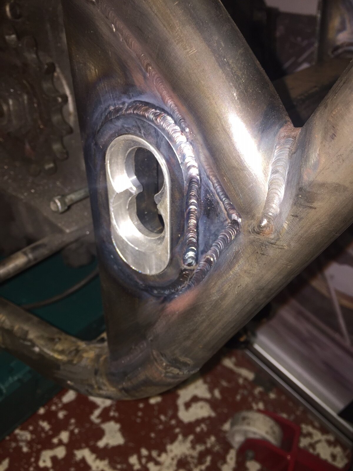

  1. My welding is pure perfection as Chad does it :yum - that is Iti welding :worried:
  2. And the frames may differ too - lets see what the op comes back with :):upyeah:
  3. yeah if in doubt look at what you have got:rolleyes::punch:;)

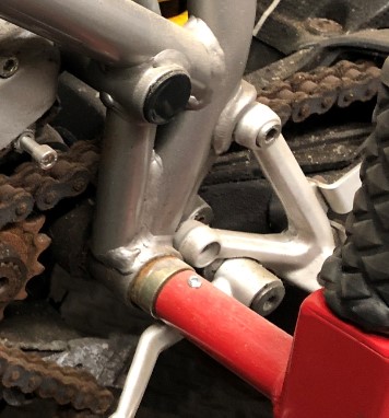

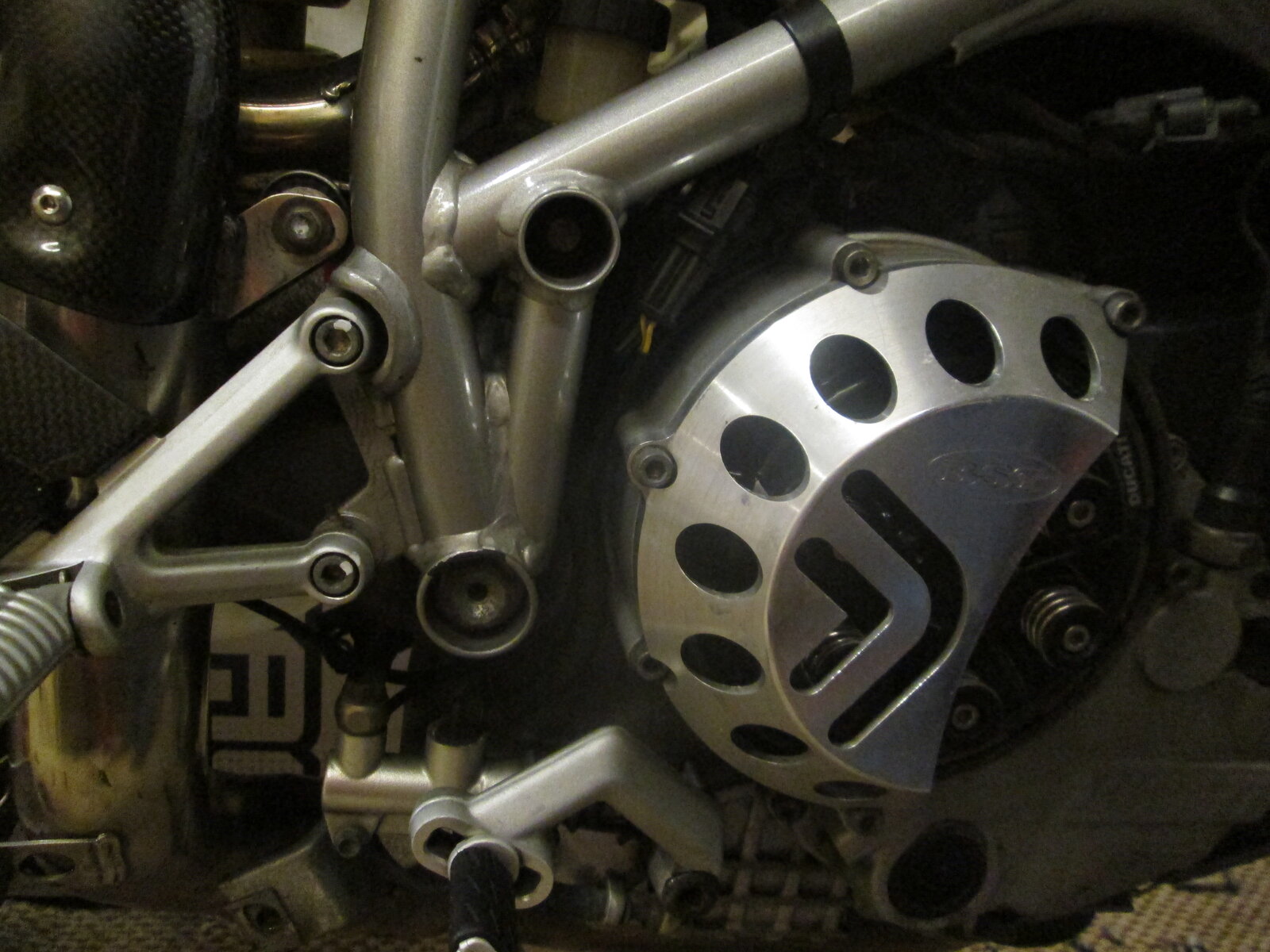

  4. Mine`s an early 2003 Bip and it has the round hole.
    No peg adjustment either, it`s like riding in the stone ages ;)
  5. if it helps the 999,1098 1198 swingers all fit into the 748 998 apertures and that has a round hole. there can be a difference in length of the pivot pin as on the later bikes you can remove the swingers on its own without having to lift the engine, the bearing spacers sit flat against the frame. i wonder if on those early 2003 bikes they had the old style pivot bearing sleeves?
    no worries in any case you could retro fit the later style sleeves by just using a spacer ring pressed into the frame...
  6. There is no adjustment on any of the 749/999 bikes since the cases aren't bored to allow that... :bucktooth:
  7. Bloody con artists them Italians :eek:
    Plenty of adjustment on my 4 position version :blush:
    • Drama Queen Drama Queen x 1
  8. I found an old pic on my phone, and judging by the Abba Stand its a round hole as per Pierre 66
  9. Lovely chain and sprocket
  10. So if the part listings are correct it should fit with your current pin and no spacers :thinkingface:
