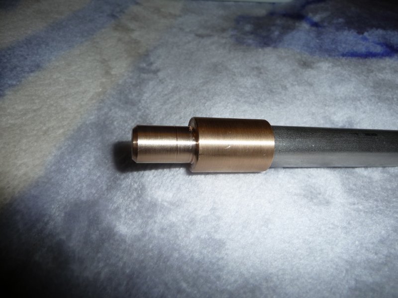

  1. I wouldn't bother with threading the brass, as this will put force into the thread when you hit the drift. Either damaging the spindle or getting the brass adaptor stuck in the spindle, or both.
  2. OK, just need to make a new end then and have another go..................
  3. Have you soaked it with Plus Gas, or similar?
  4. I would see if you can get it made from phosphor bronze. I don't think the brass end will be up to the task of taking sledge hammer blows.
  5. Yes, every week it has been sitting, I have given it a dose of penetrating oil spray into every place that looks like it would lead into the shaft somewhere..........
    Will see if I have some phos, didn't have it first time around in a piece small enough. All large pre-bored bush.

  10. Well............ will give it one more go, new design end made, phosphor bronze, 19.90 dia and square bashing face.

  13. This is what you need dimensions wise, sorry I was a bit slow on getting it. Thanks to Shazaam on Ducati.ms
    Ok that is a bit hard to read so dimensions are 13.5mm for the tip with a length of 14.73mm with square end(not sure if this is important) and 19.43mm for the shaft. This is what I had made out of aluminium and it worked perfectly.
    Just had another look at Brians pics and there is a difference in his measurements. The first shows 19.435mm as opposed to the second at 19.96mm. The first is consistent with Shazaams 19.43mm so may be another trip to Noel because you don't want to end up with your tool stuck! No pun intended lol.
    #33 Bront, Feb 26, 2014
  14. OK, easy to skim a bit off it in the lathe myself, he does all the bigger stuff for me and I do all the fiddly stuff and welding for him. Won't get my tool out until the weekend though...................... :biggrin:
