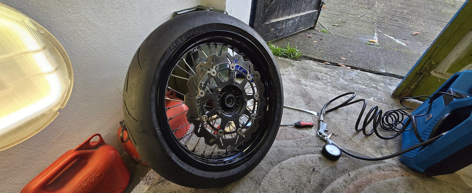

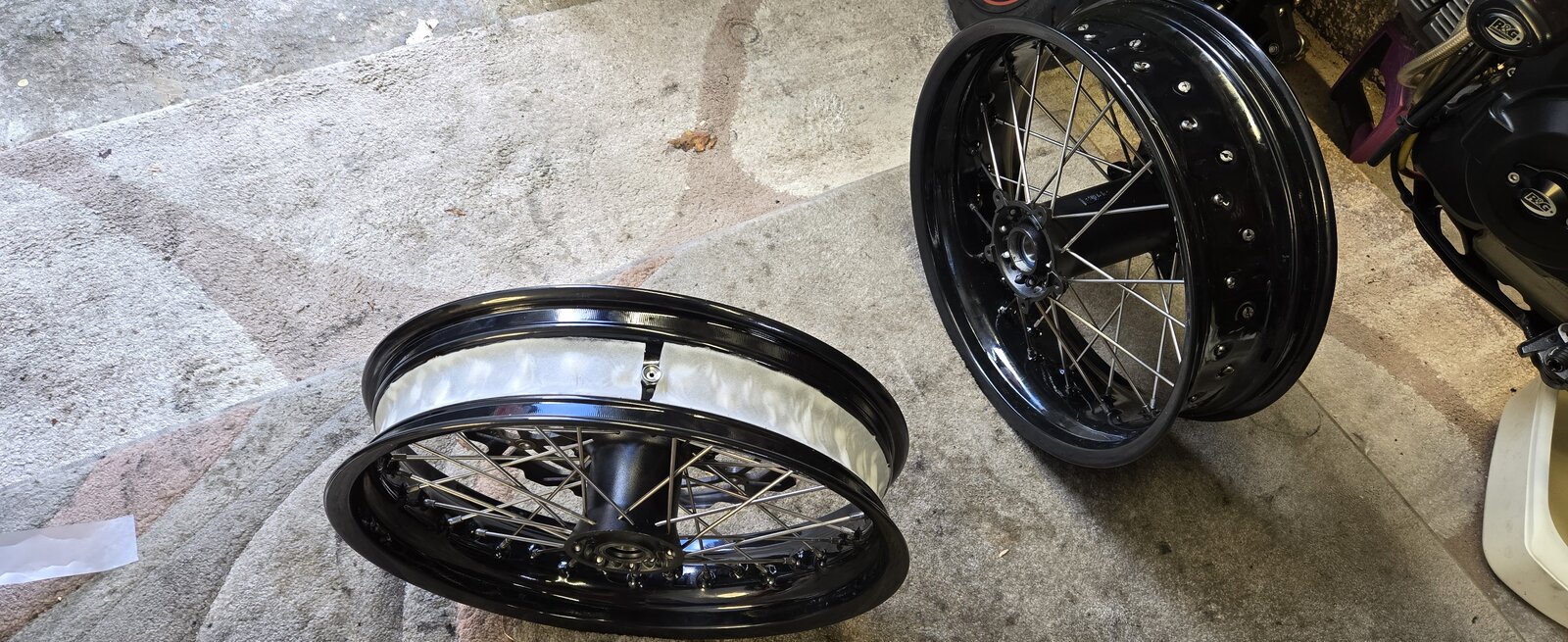

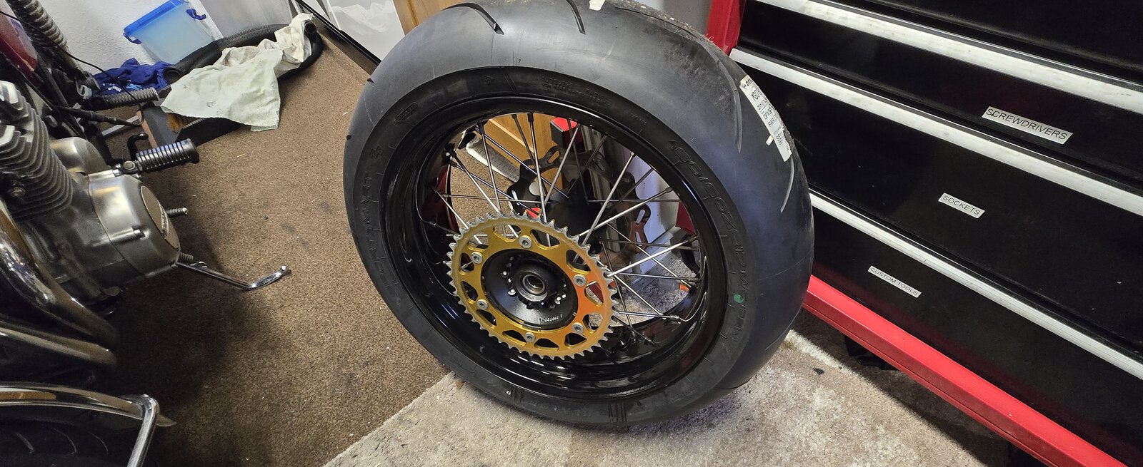

  9. Another good sunday in the garage. On the downside when i laced the wheels up i got a few spokes wrong on the rear wheel but stupidly thought "he'll sort that out..." he didnt so it came back "you got some spokes on the wrong side mate" - so relaced the wheel on saturday ready for it to be done this week at some point....
    The front wheel is now sealed with the tyre on so thats now running a tubeless tyre.

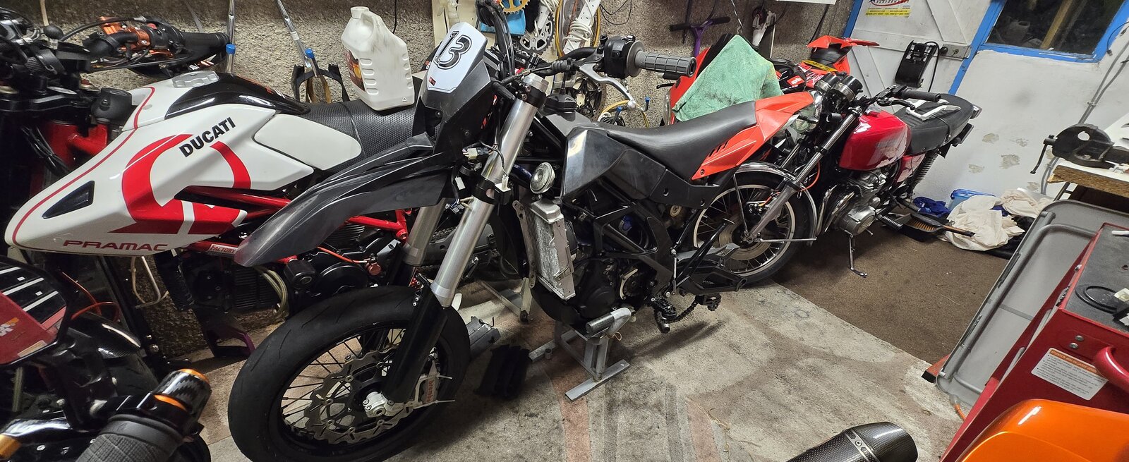

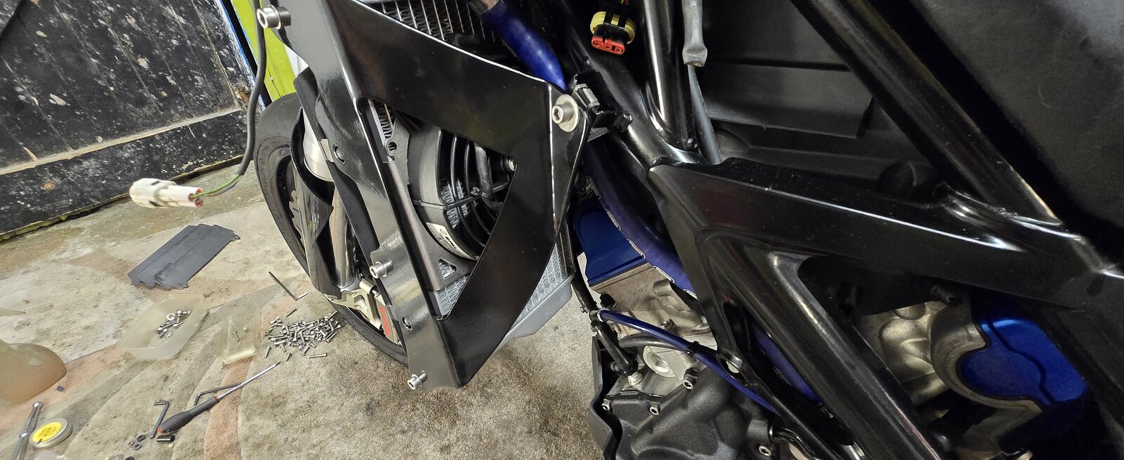

  10. Forks are in with the front wheel on. Removed a load more alloy for powder coating....Radiator fan guards, rear numberplate hanger. Stripped the rear caliper and the arrow tailsection are off for cerakoating.

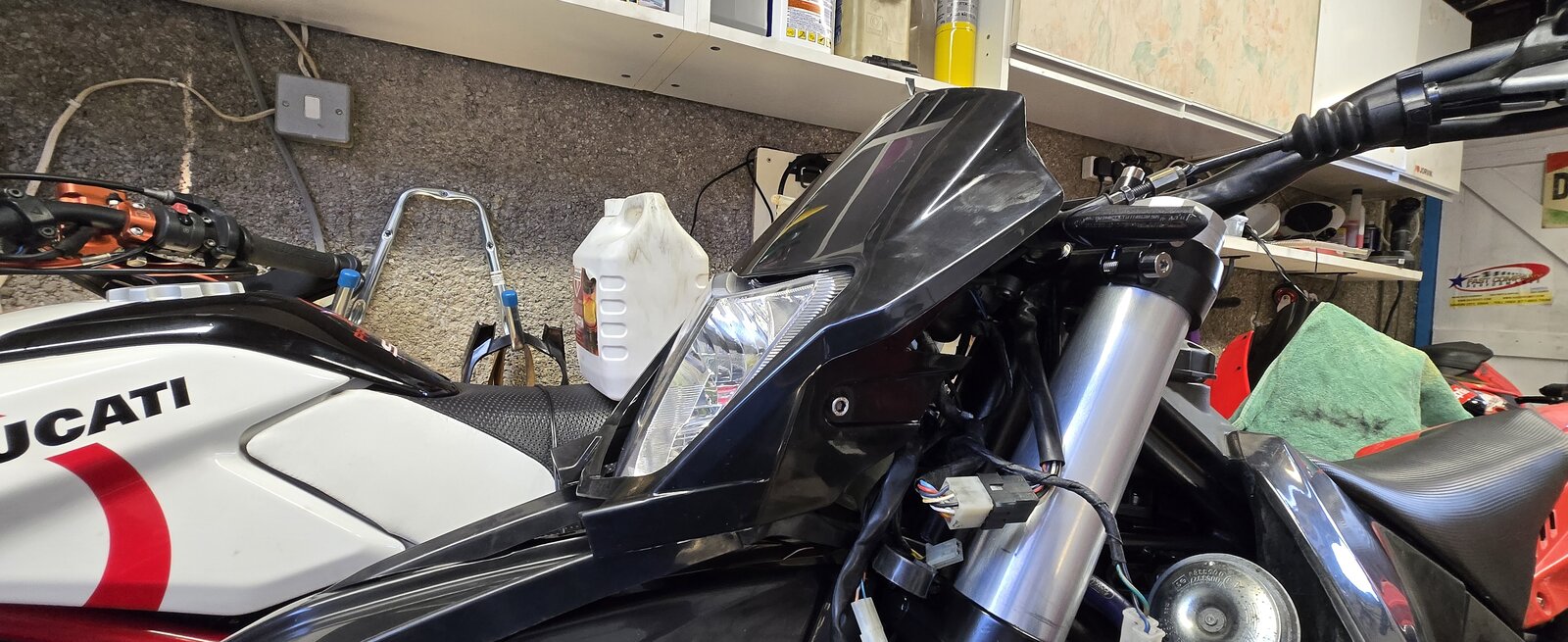

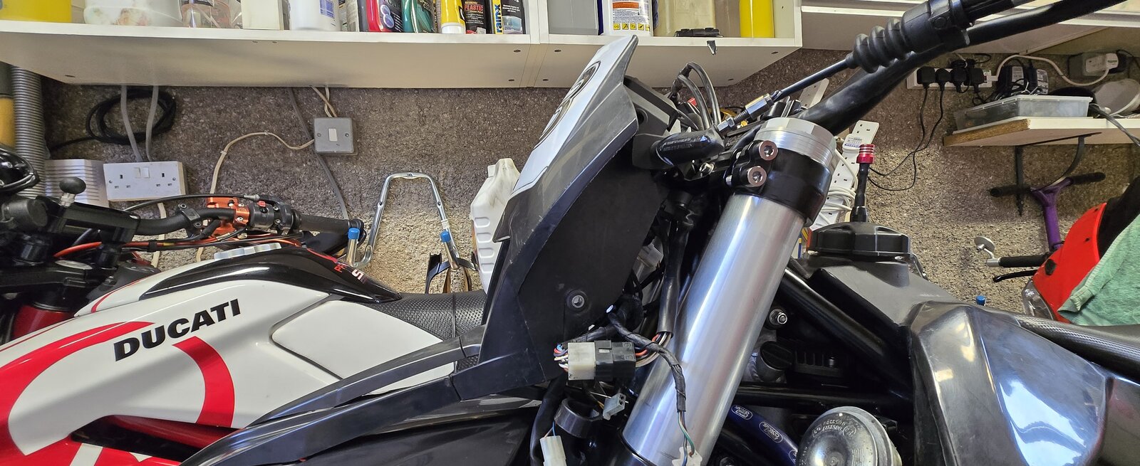

  11. Having a few issues with the front light...turns out theres a different sized "mudguard stay" for the two types of light...ive got the one for the old light...theyre like rocking horse shit so will have to run with the old light initially...
  12. Plan this weekend is to get the back wheel on - by which time i should have the rear caliper back along with the rear section of the exhaust but thatll have to wait until the headers turn up. Gonna leave the headers as bare ti so they "blue up" but the rear section will be cerakote black as that it virtually hidden but all you can see are the sides but if its blacked out it'll disappear into the look of the bike...
    New tyre on order for the rear wheel as the old one was fucked. Should be here on tuesday.
  13. Luckily theres still the headlight available for the old shroud so got that on order.

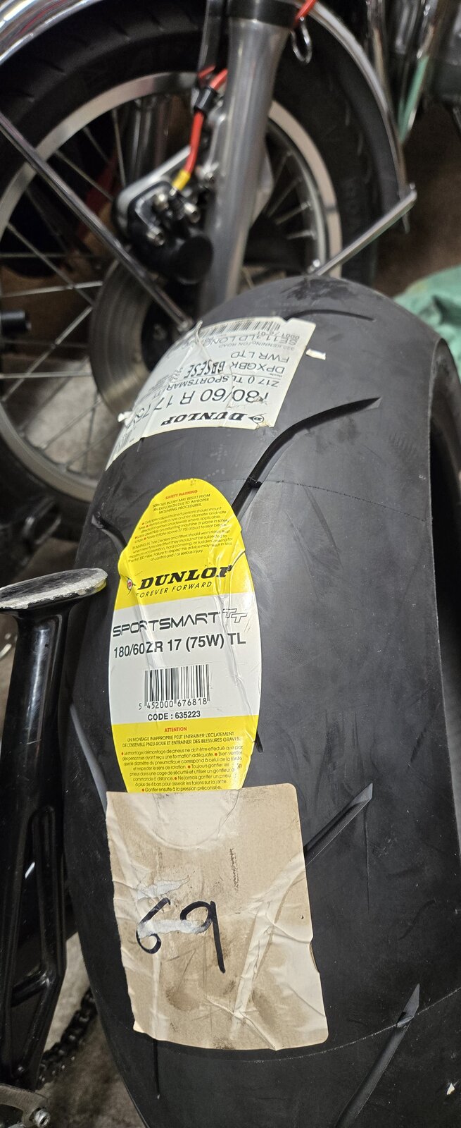

  14. Tyre arrived - 95 quid delivered for a 180/60/17 Dunlop....there are deals to be had on ebay.! Vdb stepped seat also arrived.. 20241029_175741.jpg 20241029_175748.jpg
  15. Rear body panels in the dishwasher on a hot wash to get all the glue off before i polish them up....rear wheel away being true'd up.

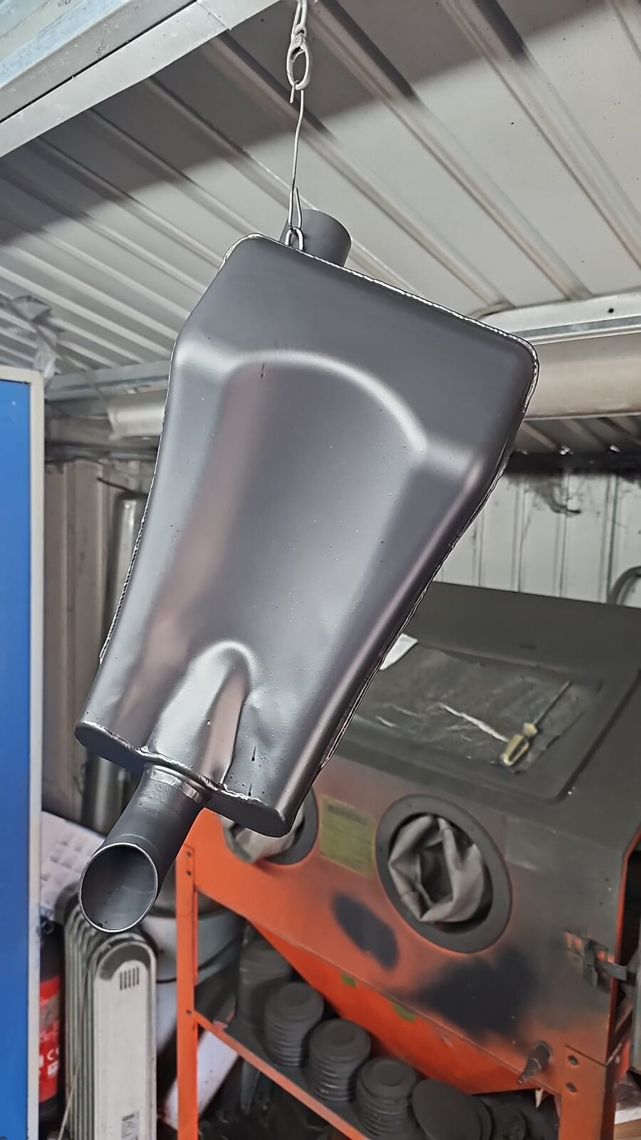

  16. Some cerakoting now ready...
    Edit - i think its the way the light is catching the tailpipe but it is black.!

  17. Not home yet but theres a load of stuff at home...got the wheel back this morning, stuff thats at home...

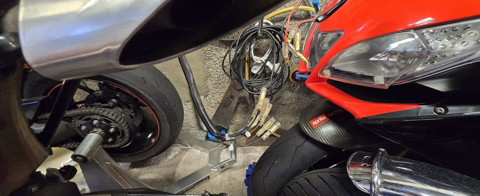

  18. Got the evening in the garage last night (wife had her mates round) so got to do a bit...
    Rad Guards back on,
    Ran the speedo cable - not connected yet.

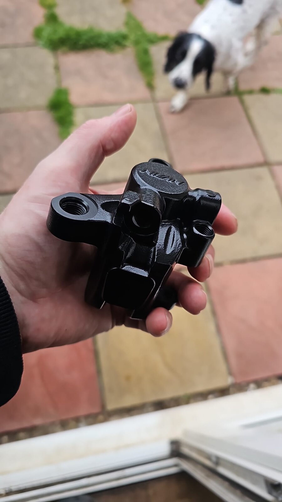

    rebuilt the rear brake caliper
    Renewed all of the rear light/indicator cabling (all the connectors were tired, crushed and coated in oil shit etc etc.)
    Got the rear tyre sealed with tape and the tyre on, but for the first time my compressor didnt have the legs to push the bead out as it got caught on the tape but, took it down the tyre place this morning and their compressor did the trick..."its done mate but fuck me we had to get the pressure right up to push it out" - so im happy with that.

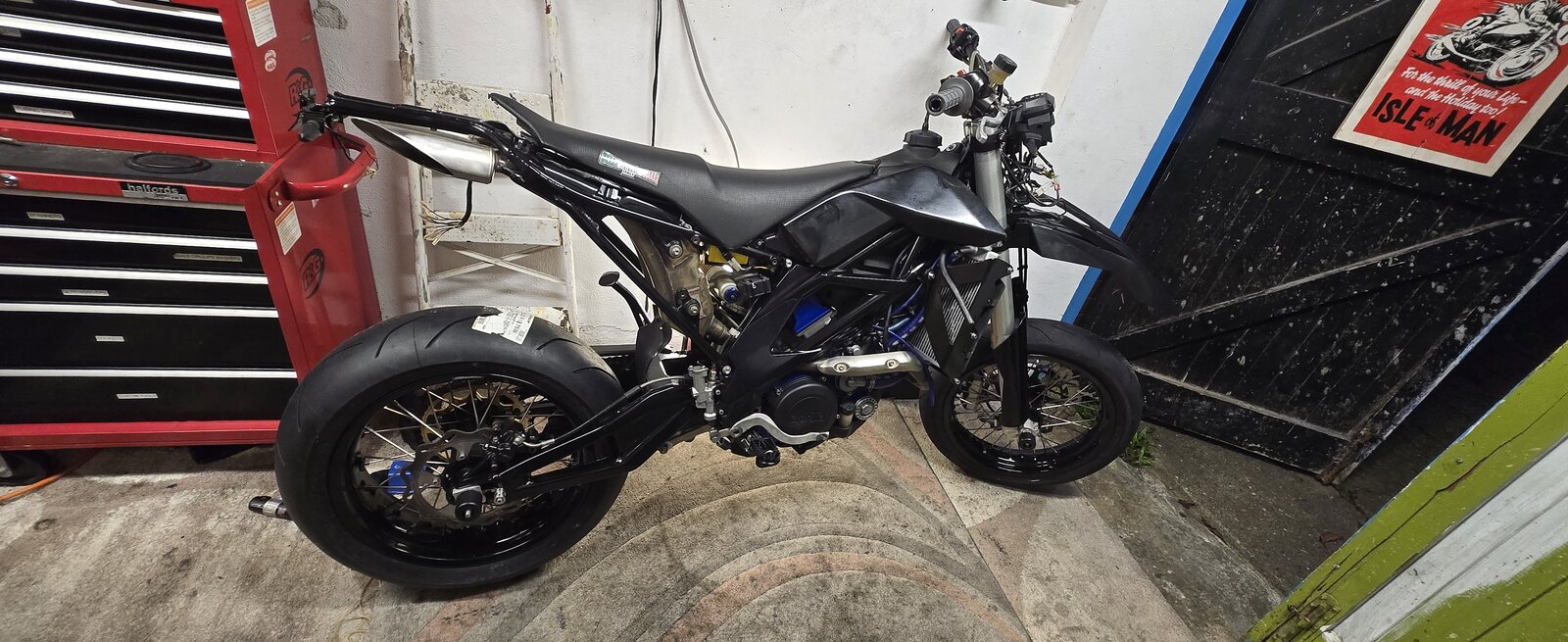

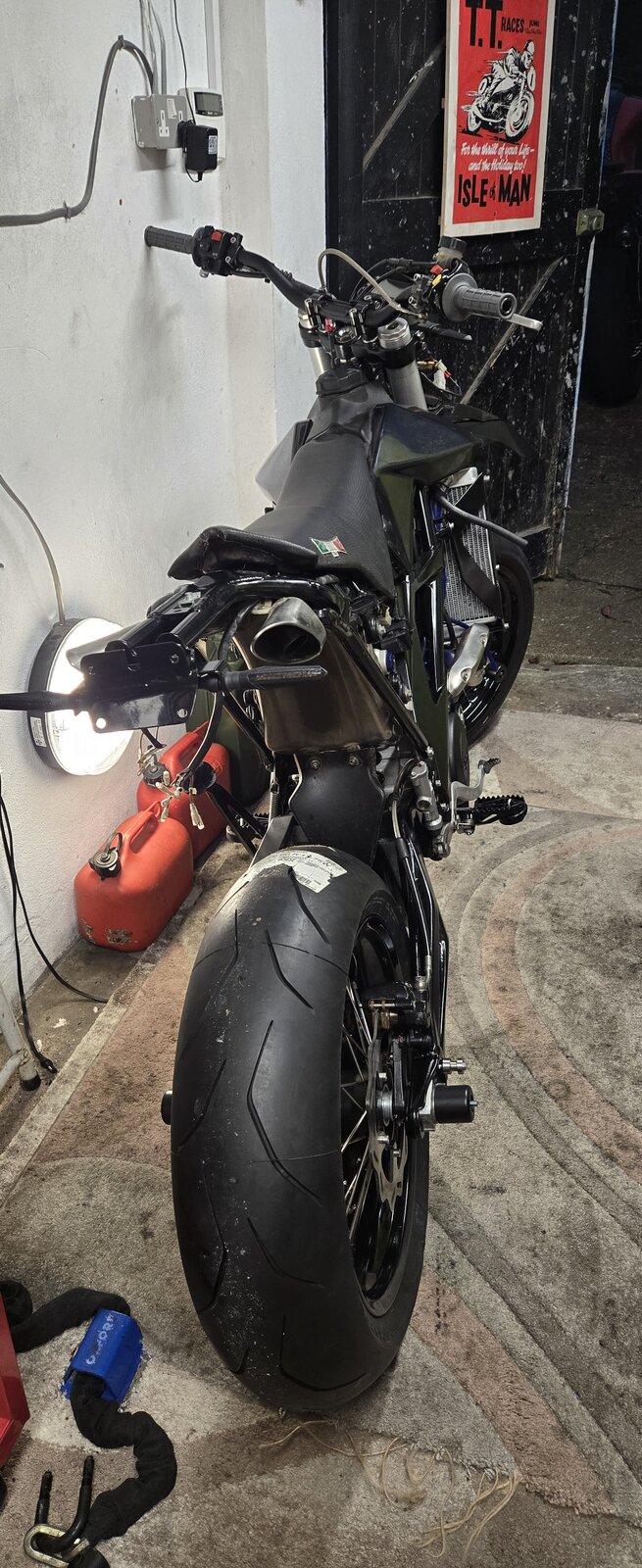

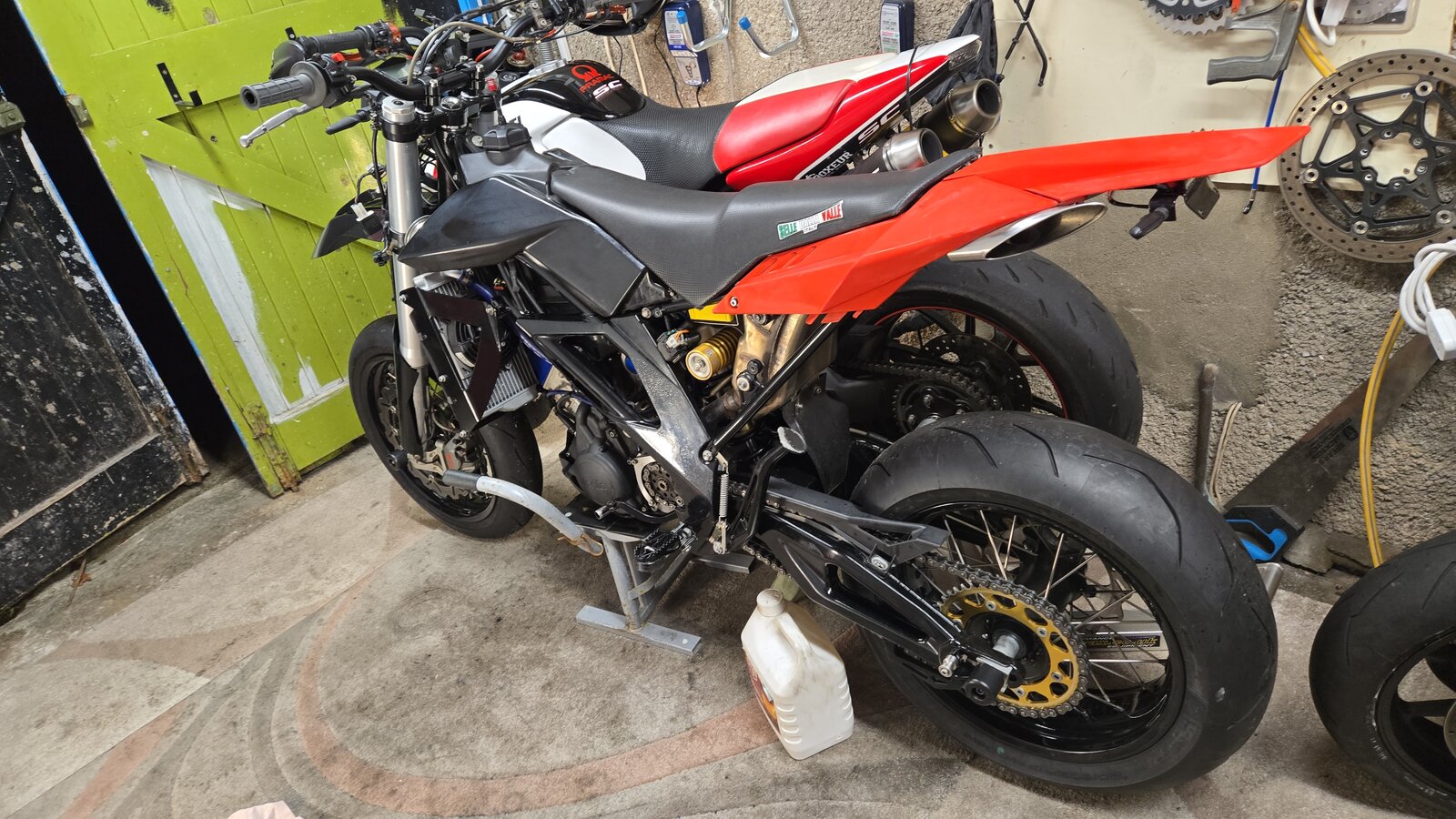

  19. Good day in the garage coupled with the fact that i forgot the wife was out so got to go back in the garage and, tonight shes working late so, im in there all night tonight as well.
    Wheels on.
    Re-routed tail end lighting wiring to protect it from the elements.
    fitted and bled front and rear brakes.
    Brash bungs and and paddock stand bobbins fitted.
    Optimate charging tail fitted.
    Started to remove all the glue from the panelling.
    Fitted speedo sensor to the front fork.
    Plan tonight is to carry on polishing up the panelling, Cut a replacement rear panel out for the back of the arrow tail section and time allowing fit a couple of bits to the Hyper also.
    That, is a fat rear end.....i think the only supermoto to date with a 180 section rear tyre as standard. Gotta hand it to Aprilia, this supermoto was way ahead of its time in styling...still the best looking one out there.
