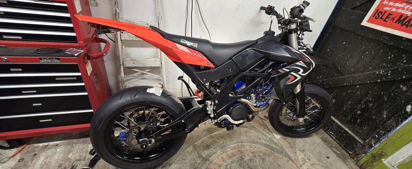

Featured Sxv550 Supermoto Build/refresh
Discussion in 'Builds & Projects' started by comfysofa, Oct 3, 2024.

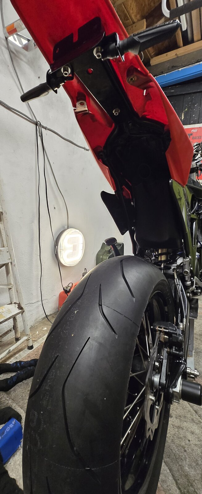

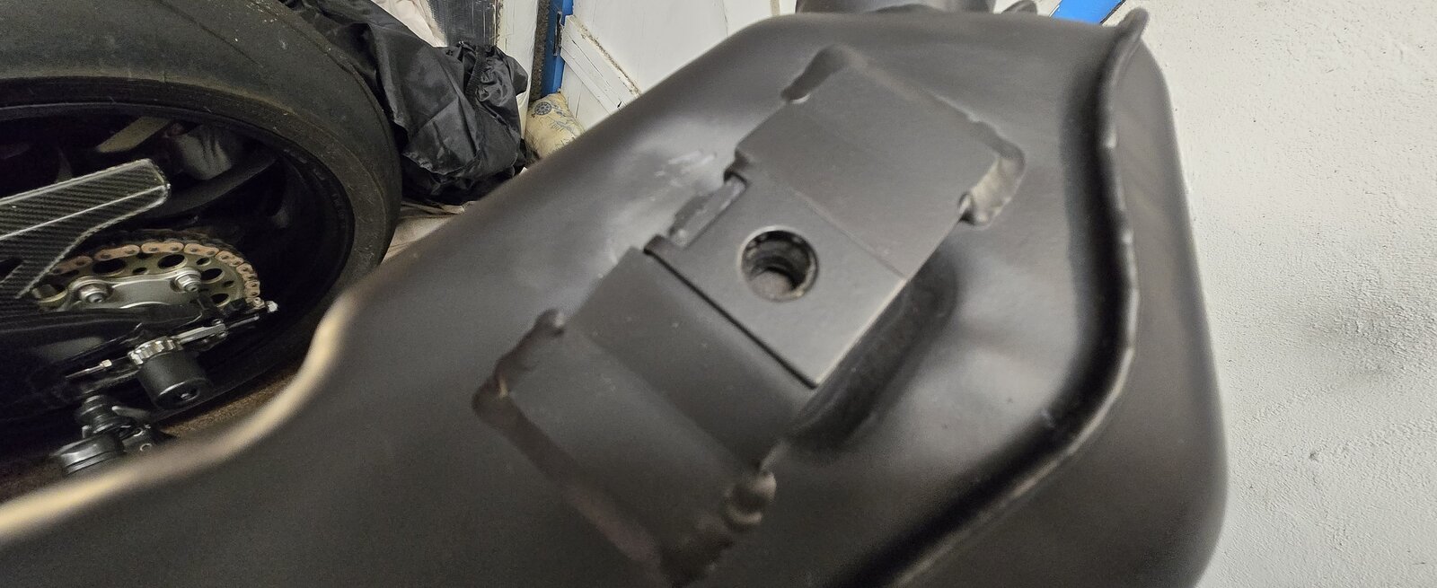

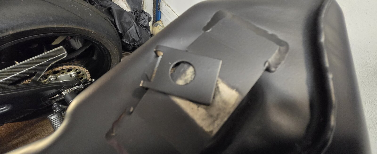

  6. Didnt have time to put anything up last night but as planned got the oem exhaust off test fitted the rear to see how the black colour disappears into the rear of the bike and id say thats perfect...just what i wanted. Never got to the polishing as i was chopping bolts and making a rear back panel for the exhaust (missing when i got it) but its just a rectangular panel...
    That last pic is of the guard which used to connect to the OEM pipe but on the oem there were two bolt holes...not on the arrow....have to work something out...

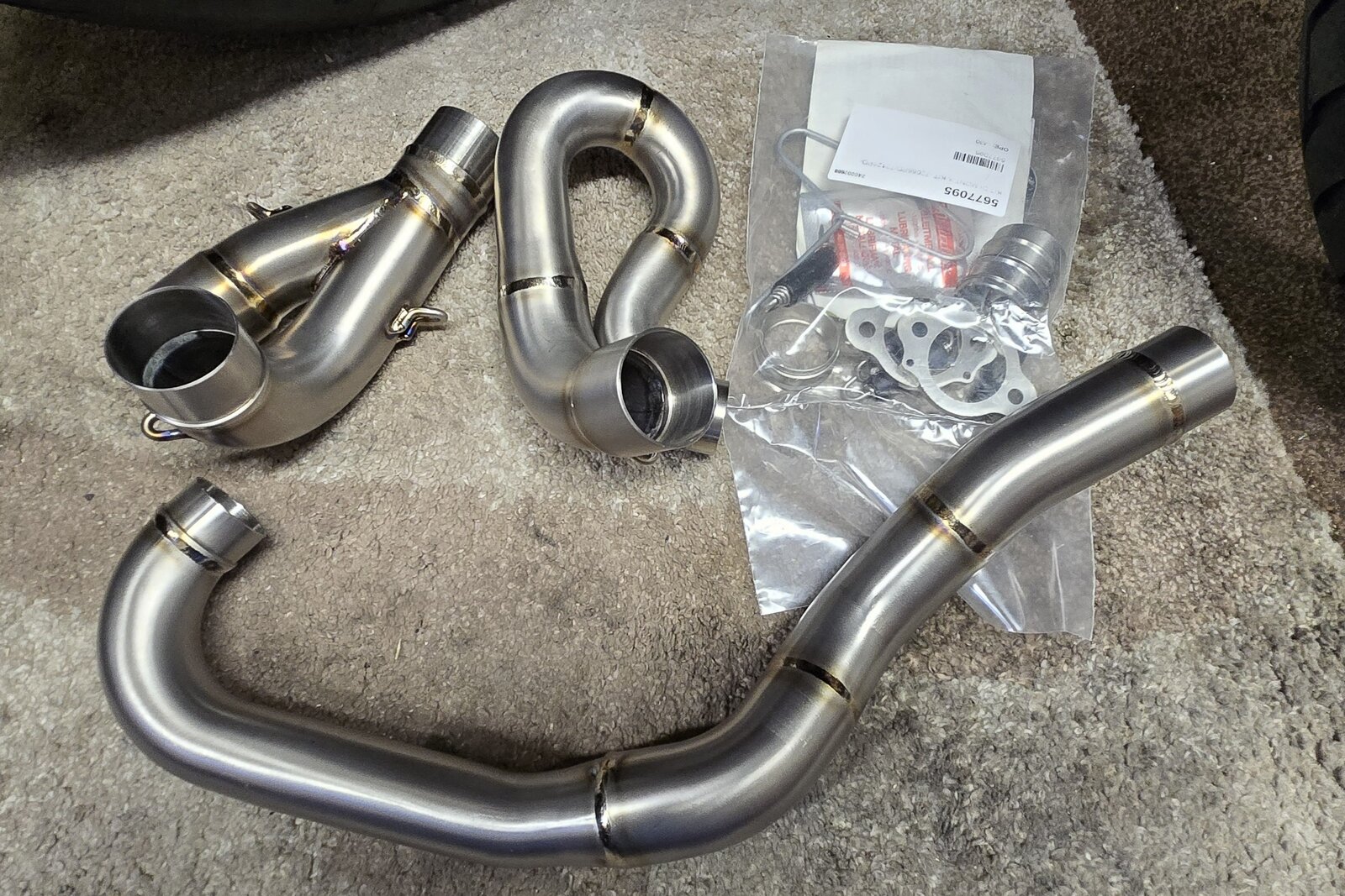

  12. At last...should have a good day tomorrow!
  13. Exhaust fitted yesterday.....fuck me its loud - started it in the garage which definately amplifies the noise by a factor of id say 40% or so - its got a button on the throttle that when you start it, locks the throttle slightly open (3k revs) - we were shouting at each other and couldnt hear each other....atall...its got the correct mapping on it for the exhaust (sparks and flames out the back) - its a bit deeper than the oem system but not louder which is a good thing. Couldnt get the rear light working then found out after 2 hours of tracing cabling with a meter that the engine has to be running...rookie mistake. The wiring loom is a bit scrappy so im making a start on replacing plugs, shortening cabling, retaping sections of the loom as electrical pvc tape has been used over various parts and gone all gooey....
    Todays delivery will be the HEL brake lines. Ordered a metal Arrow exhaust system sticker for the backbox (thatll go down on the back by the back wheel) - i like subtle stuff...less is more for me...

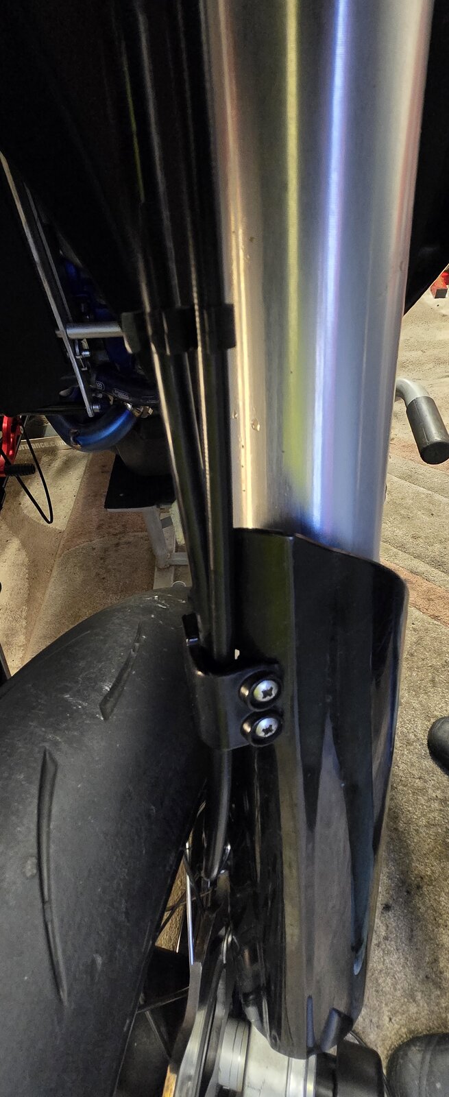

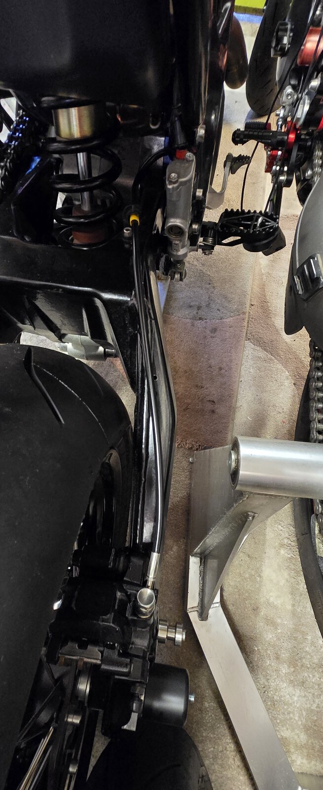

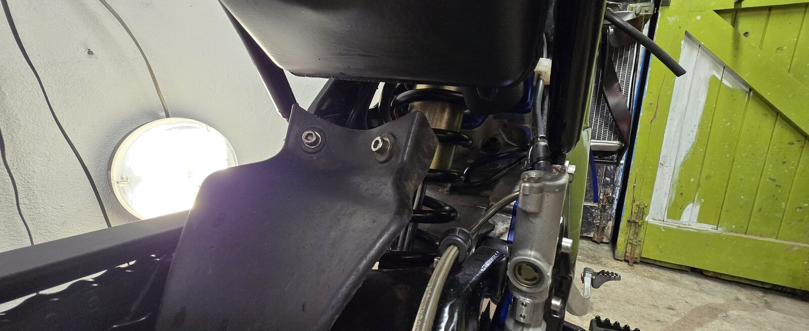

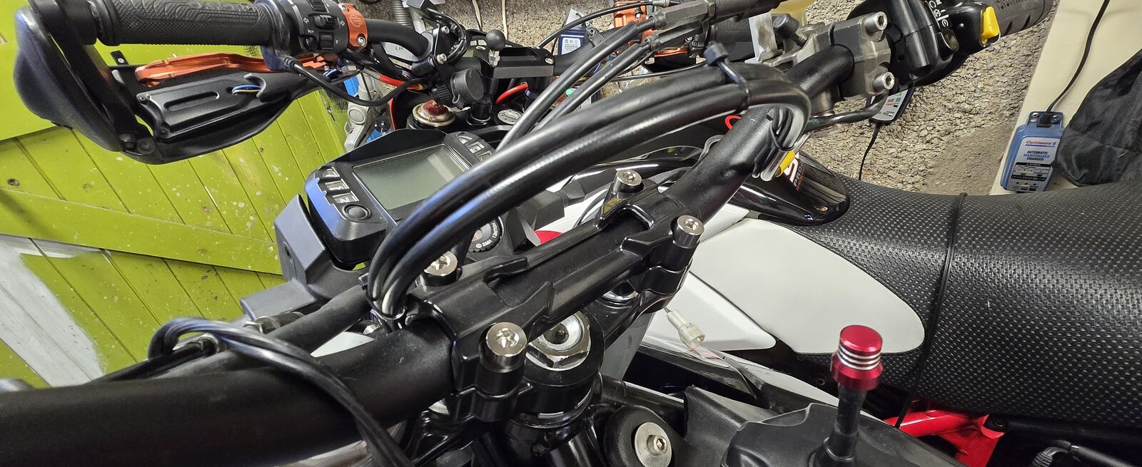

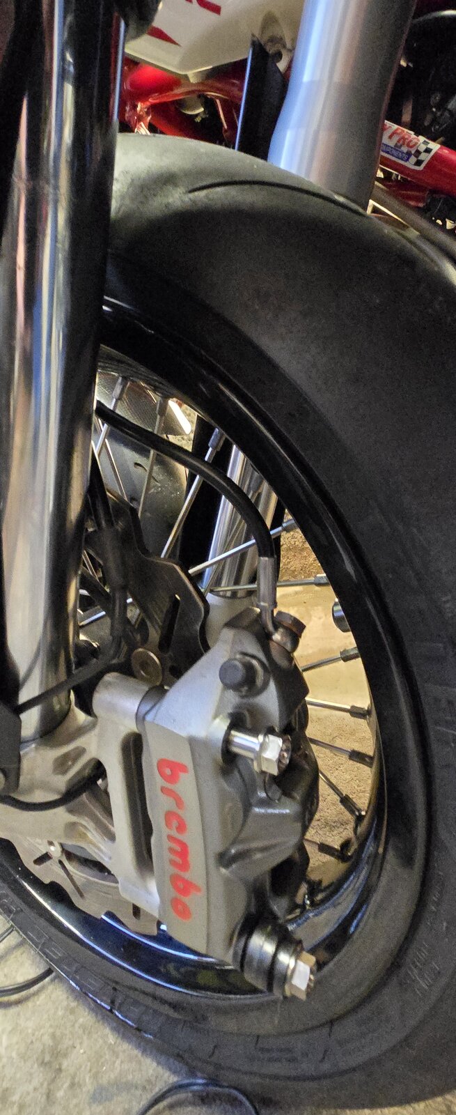

  16. Fitted the brake lines last night.....way better than the oem ones. The rear was easier to route and as they're Hel lines you can make adjustments. The front even better ( a custom line as its got an M4 caliper now ) and doesnt stress the mount on the fork guard...very pleased.
    20241113_074103.jpg 20241113_074053.jpg 20241113_074045.jpg 20241113_074036.jpg
    Edit - yes the ti bolts are technically wrong at the moment....just waiting for payday so i can get a roadlok to fit to it...
