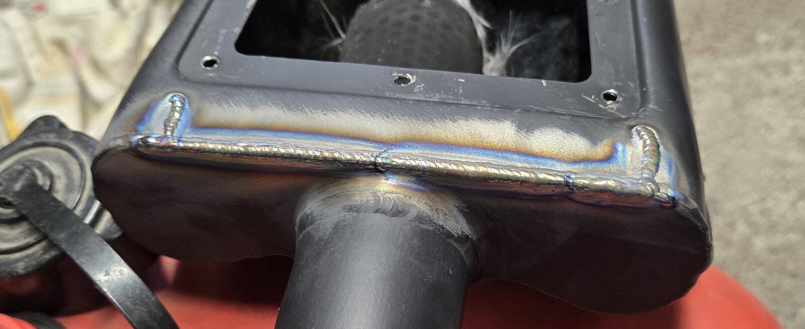

  4. Little bit of a step back....after getting the tail section cerakoted ive noticed there was a hairline crack across the top of the pipe so had to take it to a local ti welded to get it patched up....not the end of the world but itll need to be recoated at somepoint.
  5. On the plus side - now ive got a good fitting plate to fit the exhaust and repacked it. It sounds tons better.

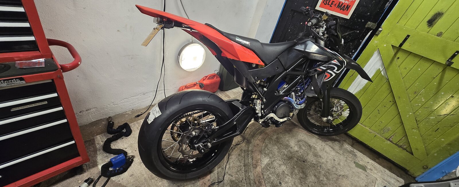

  8. Very good day yesterday - very good... a little thing but finally got the rear brake light working....a combination of factors i think... tail section of the loom was pretty ropey. One of my cheap chinese lights didnt work/ was faulty, blown fuse which i didnt realize ran the front headlight (it wasnt connected while i was testing) and also ran the brake light circuit as well..

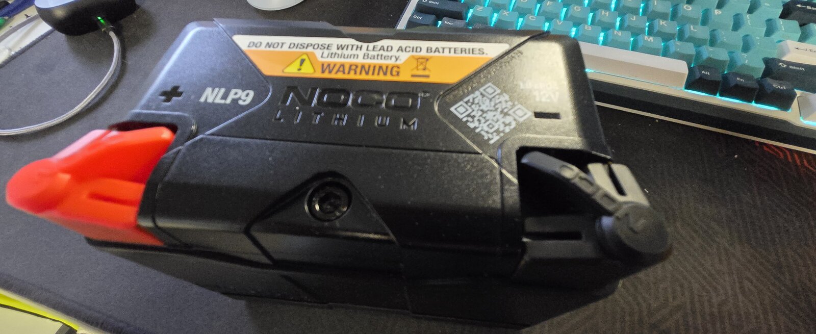

    So, thats done now - will be moving on to tidying up wiring and panelling. Just scored a NOCO lithium battery brand new for 70 quid...i was hanging out til the end of the month but saved about 50 quid so the card took it on the chin for that one...

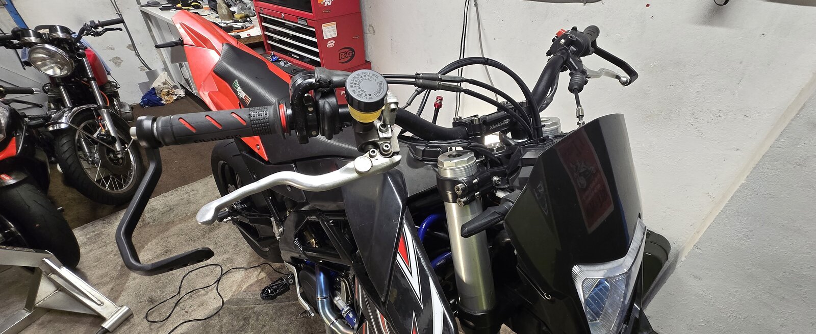

    Also from a styling point of view i was 50 50 on lever guards or handguards....went with lever guards as i got a set of brand new (but never used by the seller) solid alloy guard for 30 quid...anyone that uses the (you only need one leverguard) argument....i challenge that when you get a windmirror to the fist at 30 plus....
    Anyway...exhaust re-assembled (not tackled the recoating but that can wait..) - fuck me it sounds better...still loud as fuck but sounds great.

  11. Noco lithium just turned up...70 quid delivered...chuffed about that!
  12. Good price! I recently bought a LiFePO4 BC battery and also thought the prices had come down. :upyeah:
  13. Yeah - i know...one of the lads gave me the Model Number - apparently the NOCO's have very very high cranking amps...i currently use JMPs on all my other bikes but the NOCO was more than twice the amount...searched on ebay and a private seller had a brand new one...sent an offer which he accepted...i was lucky.! i think these noco's are supposed to be 100 - 120....i will say though im really really impressed with the build quality - and the multiple mounting points of the terminals....very heavy duty...

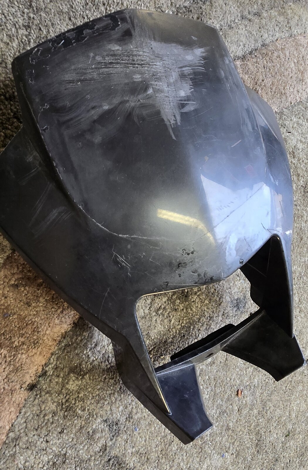

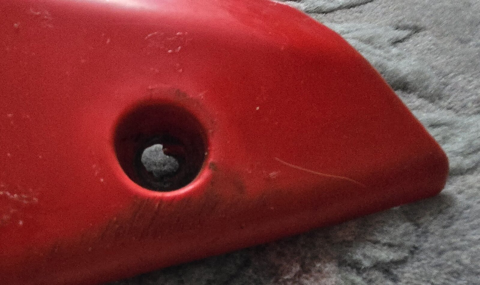

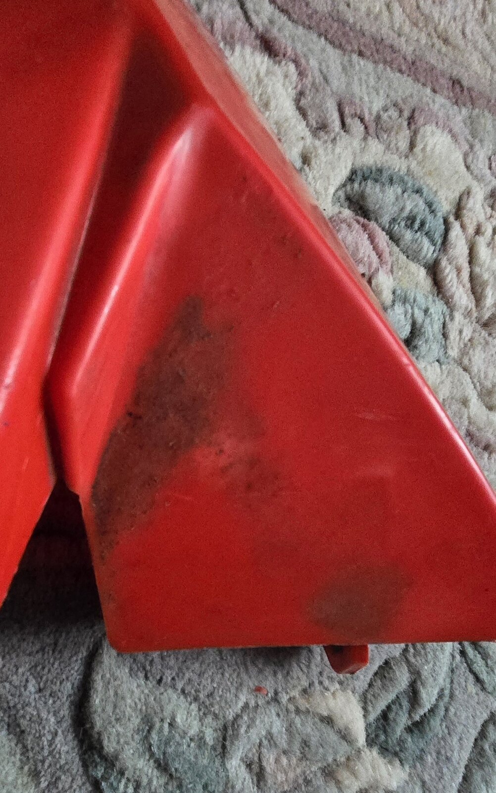

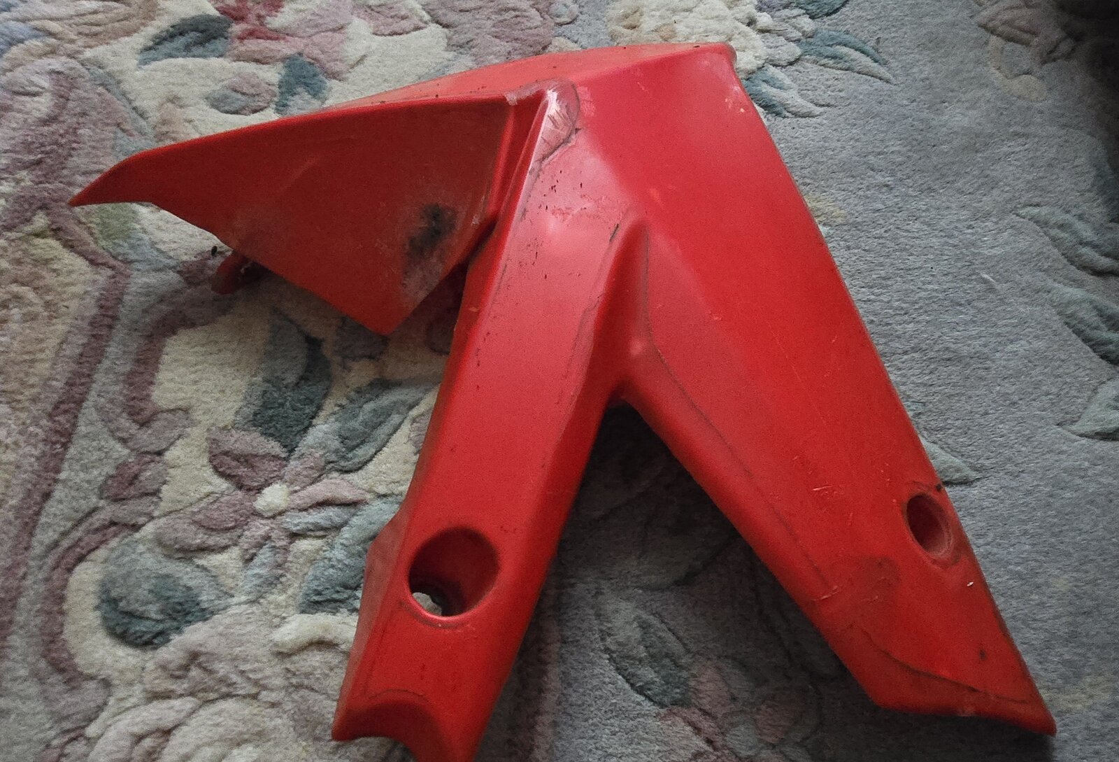

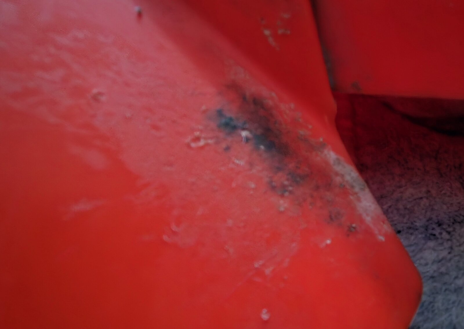

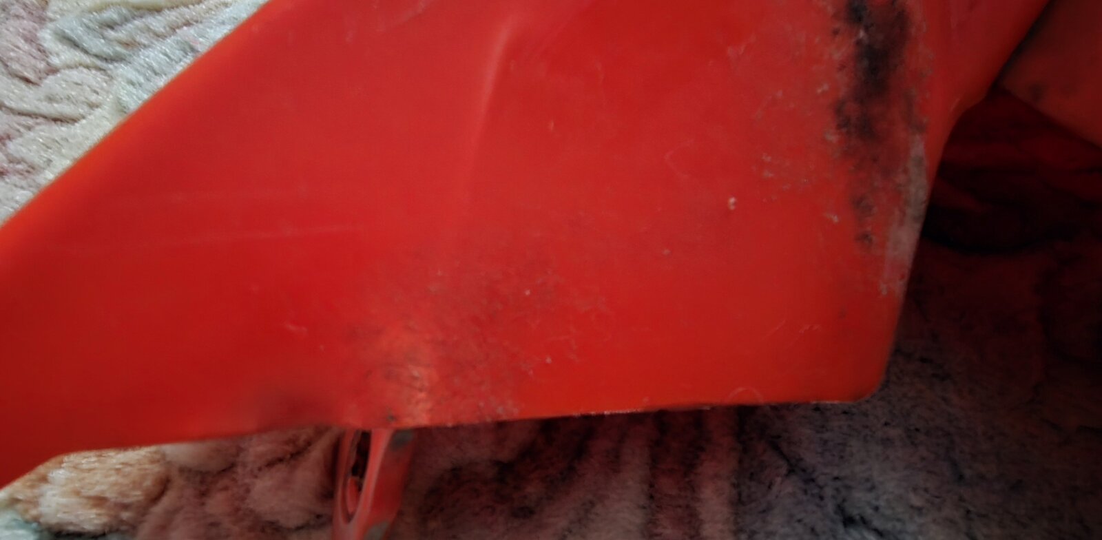

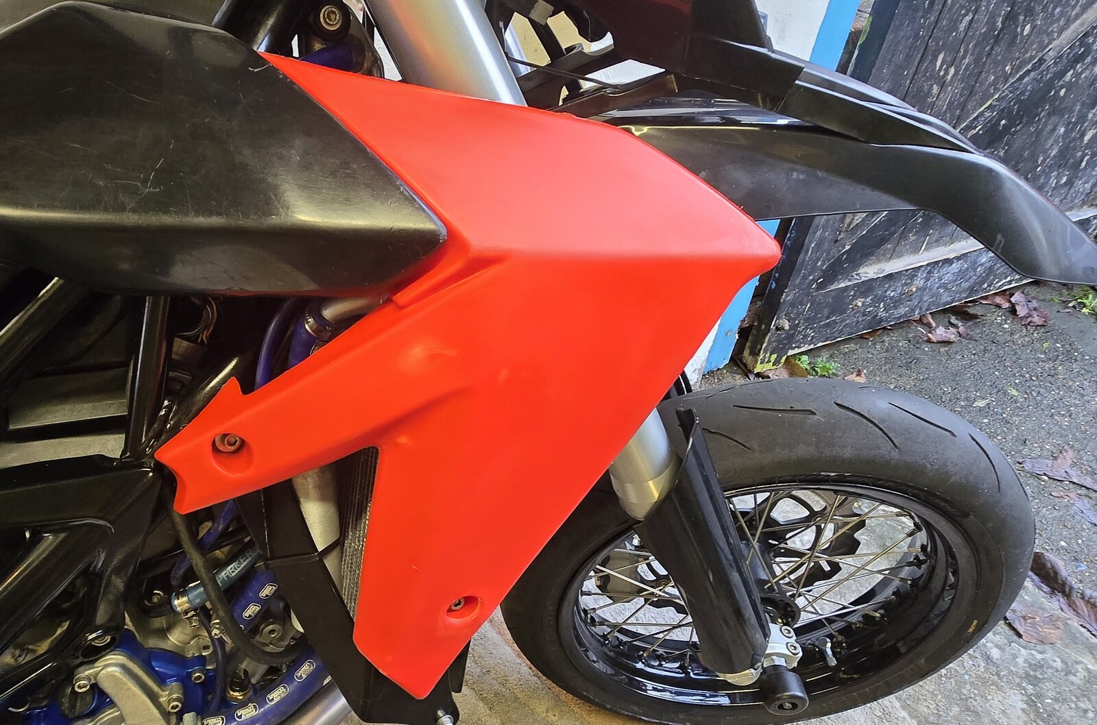

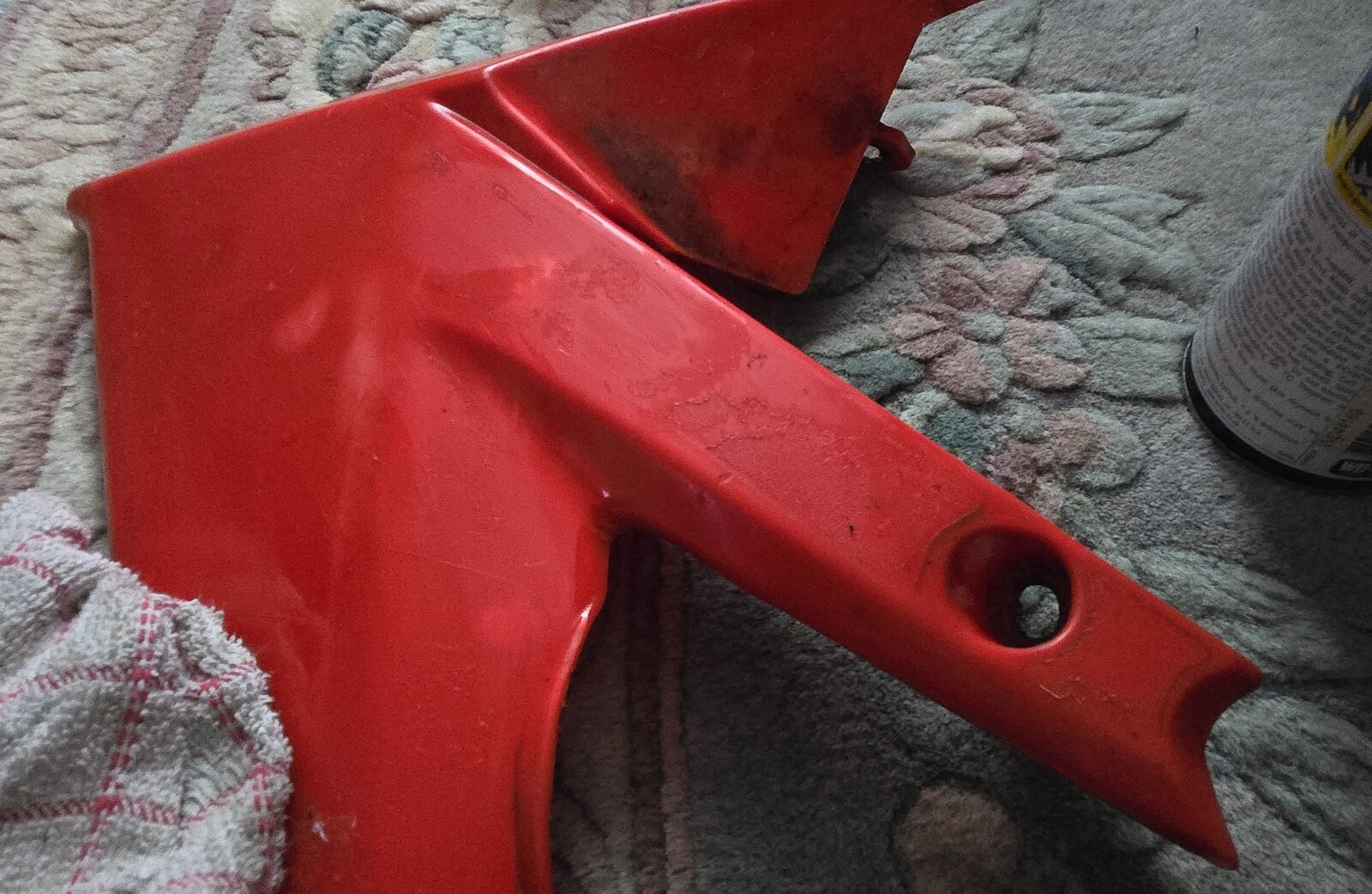

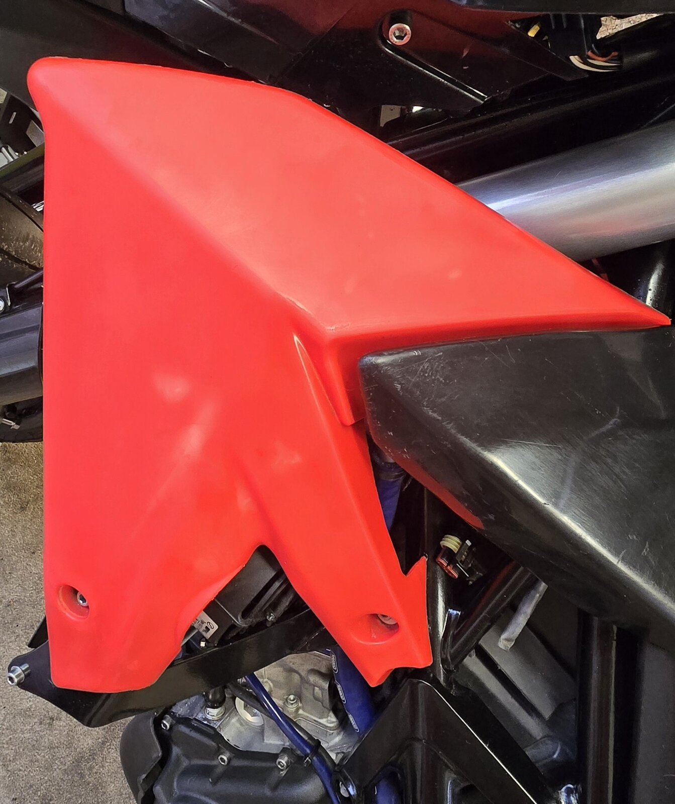

  16. Polishing duties yesterday - itll be a bit of a picture overload....but essentially i was working with wet and dry only from a 400 grade to get rid of some really deep scratches on an old headlight mask (im not going to use it) so thought it was a good test....to my red sidepanels that came with the bike but had some old stickers on them....which came of pretty clean so i was happy about that. I would say i had moderate to good results. Im in there again tonight as while the wet and dry worked very well, using the cream and the sponge based buffing pads gave the rear mudguard clearly the best finish...brace for the photos....!
    20241201_123613.jpg 20241201_134928.jpg 20241201_133810.jpg 20241130_145106.jpg 20241130_145058.jpg 20241130_145049.jpg 20241130_145040.jpg 20241130_142542.jpg 20241130_142534.jpg
  17. So pretty horrible but, as i say with a mixture of various grades ive gotten to a smooth finish - if i get chance tonight (whic i hope to) gonna try to get a deeper finish with the sponge mops and the polishing cream (ooh er madam)
