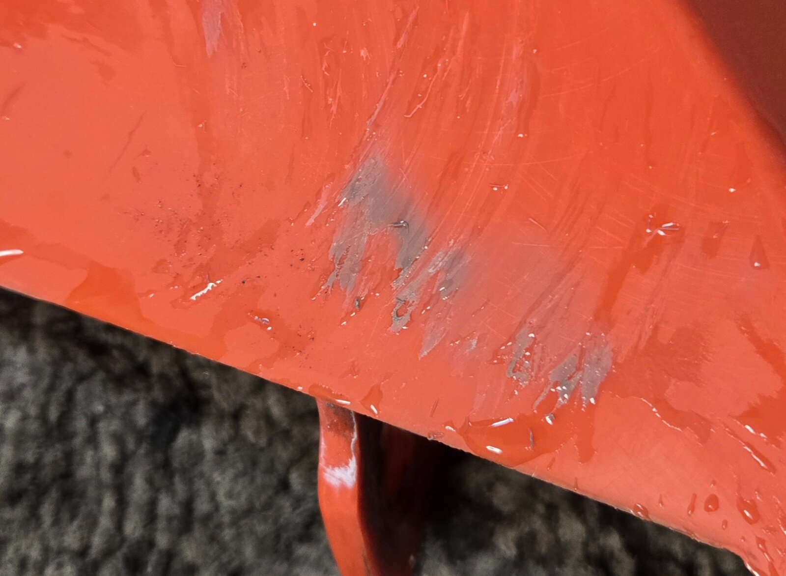

  1. Did a little bit tonight on the LH Front side panel...experimented with some 2000grade Wet & Dry....moderate results (definately better) one thing im noticing (and im not sure if im correct in saying this) but i think theres an amount of glue thats almost ingrained into the plastic.....if i get a bit of speed up on the drill you can literally see the glue appear...stop, clean with WD40 and then repeat but i think i got it a bit better...

  2. had about an hour last night messing around with different grades of wet and dry and the buffing paste/cream/whatever....not bad...
    Was concentrating on the top section and got that better....at the moment im leaning to just going with the wet and dry but very fine (that was 2000 grade) just by hand to finish and the drill and disc to start...

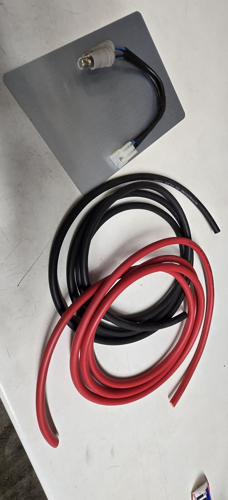

  5. Parts turning up for weekend work. New battery cables for me to make up a set (the ones on there are pretty tatty) had enough left to make one up.....ill get some proper ones eventually but need to take these off to measure them first any way and work out the route. Metal plate number plate turned also along with the front side light loom. Roadlok has turned up at work (got the day off today) - Cheers Billy Big Roy. Just waiting on the ends for the battery cables now.

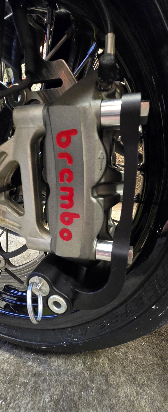

  6. The gamble paid off....Ordered a roadlok. There is no official fitting for an SXV (the caliper is a bit of a weird shape) so ordered an M4 that i found on ebay for 90 quid. Roadlok fits perfectly.

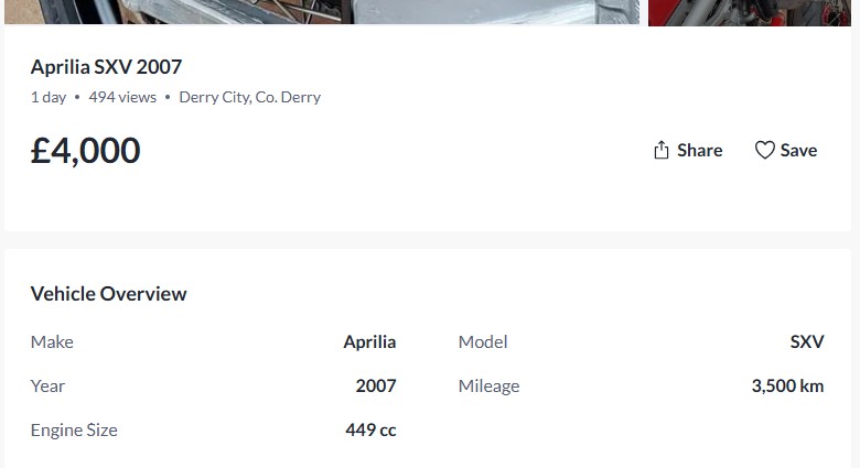

  7. Not a bad price but it is a 450....also id be interested to know if those excel wheels (well the back one) is the correct width as the sxv takes a 180 section rear (which i think equates to a 5 1/4" rim) - that rear rim could be a 5"....not the end of the world as excel rims are fucking nice (had some on my 525)
  8. Says 550cc in the detail of the ad. What’s yours? What’s normal? I’m not familiar with them. There was/is a guy in Dublin has one for sale, he offered it in our Italian bike owners group, got laughed at and slated due to the service intervals. How many hrs between oil changes and why so often if it’s only being used on the road?

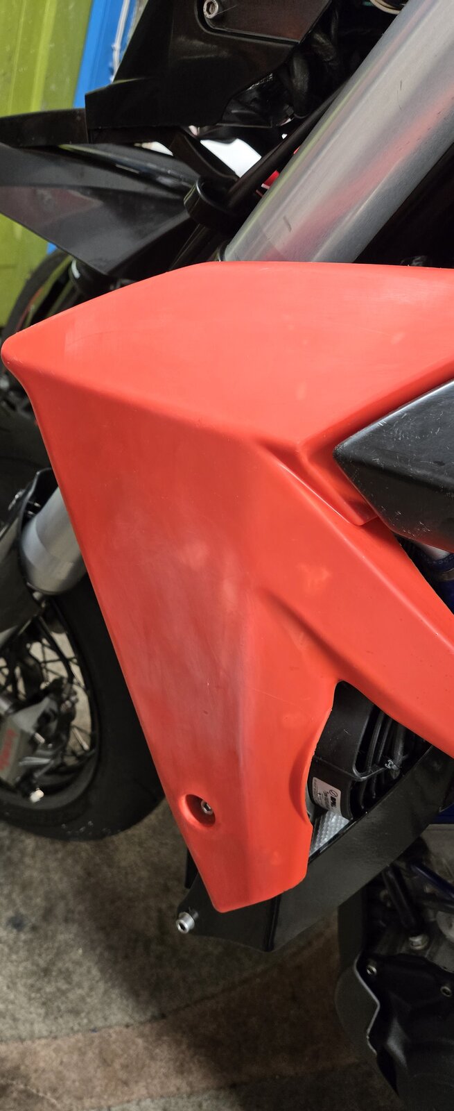

  13. Back in the garage tomorrow......light stuff...running fresh battery cables, fitting the new catch tanks, new numberplate...question...i finally got the set of black rear panels out of the lad i bought them from "6 weeks later"! - anyway....they were rattlecan sprayed and really badly - is there an easy way of getting the paint off....im guessing paint stripper will just dissolve them...im thinking wet and dry at the moment..?
  14. Try soaking them in white spirit for a day or so. It might soften it up enough to scrape it off.
  15. I found heat on my Sons Aprilia lifted the paint from the panels, obviously start off with gentle heat at distance not full blast psycho killer mode from the off.
    Failing that on other panels very coarse sanding discs, then we plastic primed and undercoated flatting off as we went. Time consuming but got the job done in the end.
    As you’re aware most quality paint finishes require good prep which is time consuming.
