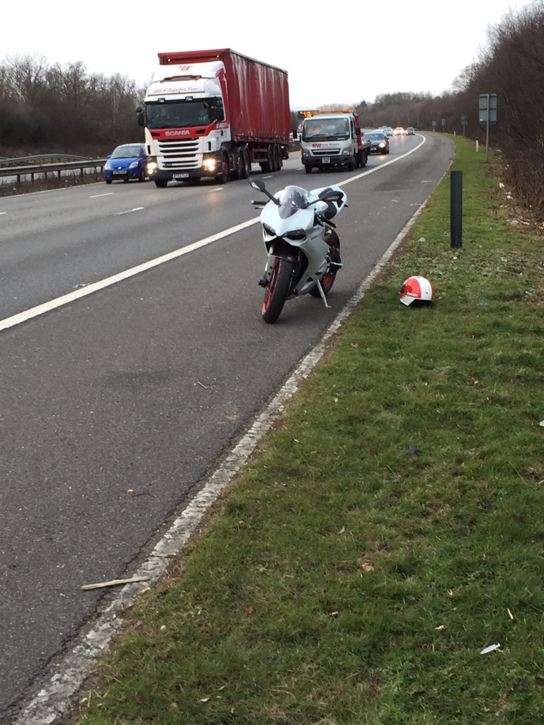

  6. The bike gave a little warning that it was about to run out so I went over to lane 1 and as I did it conked out, fortunately I pulled over to the hard shoulder.
    Law of sods was I was about 50 yards from the exit off the motorway so was laughing as I thought serves me right for being lazy and not stopping earlier.
    As expected no one stopped to help!

    R[​IMG]
  7. And I thought she'd pushed you to a gas station.
    I'll keep her in mind if I ever need fuel delivering.
    Not so keen on the Earl Grey, prefer Builders, white with one.
    How many miles did you do on reserve before taking the picture? Presumably more than 25 if that's your limit now.

  10. Conked out on 25 :(
