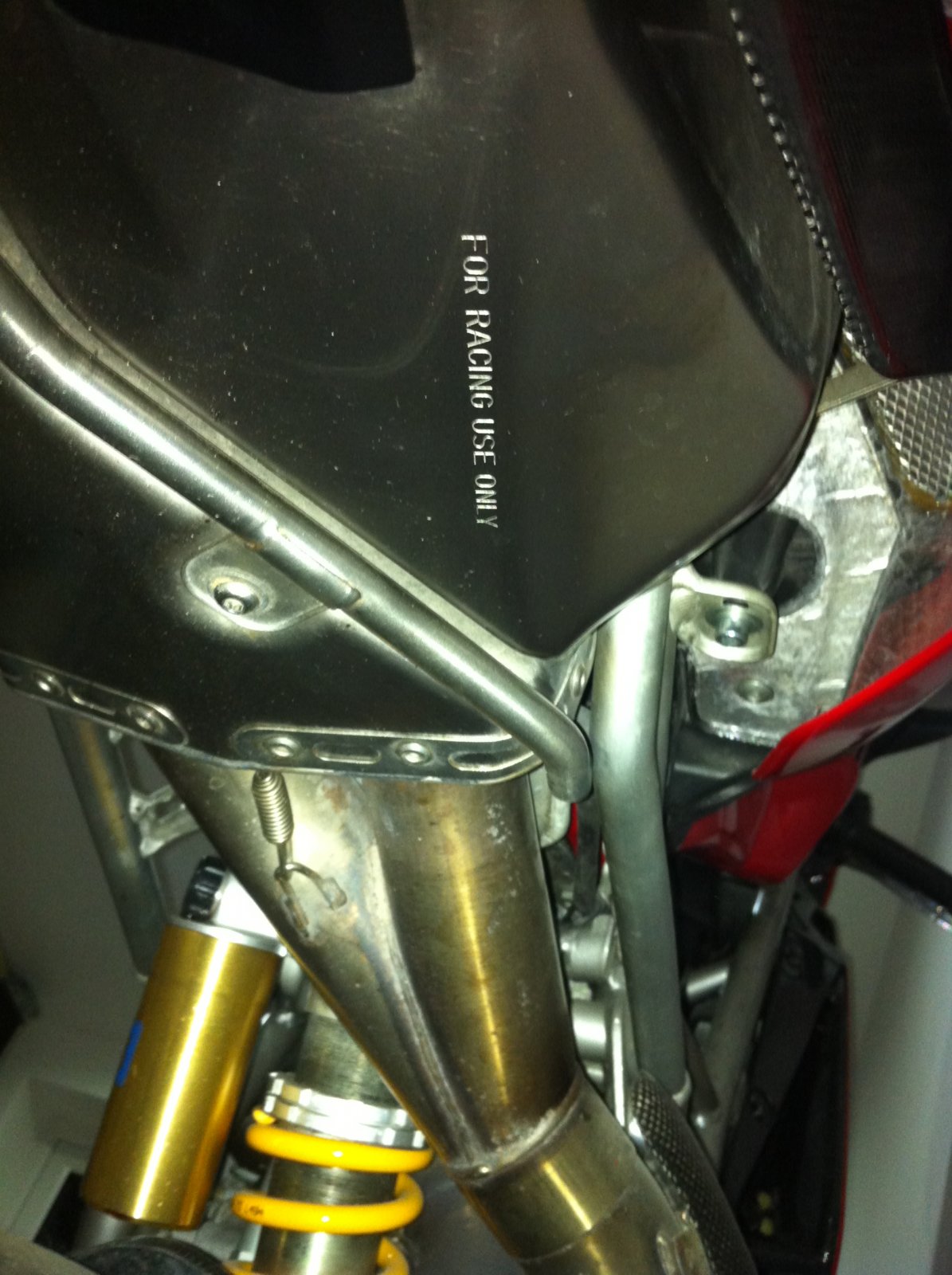

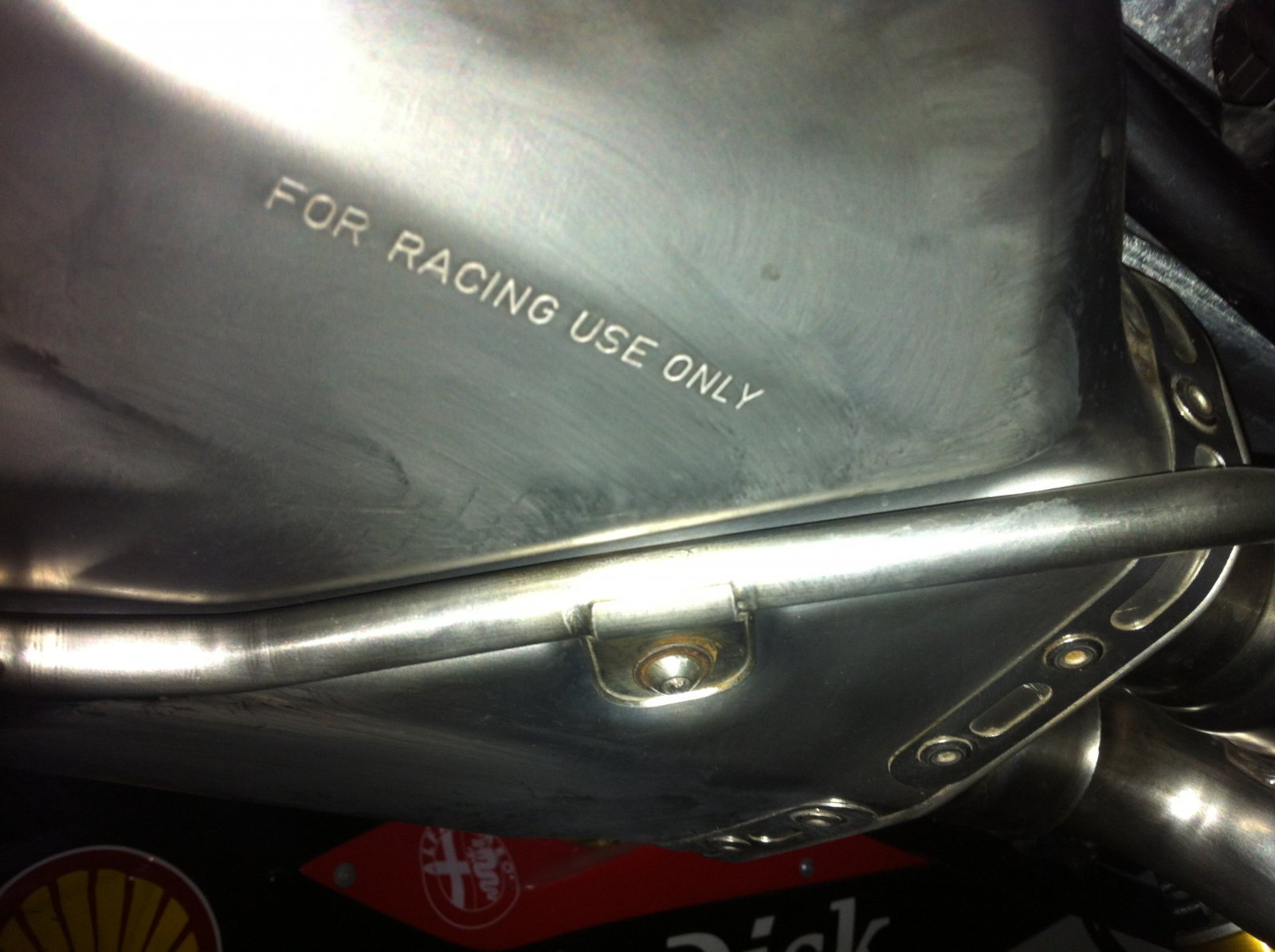

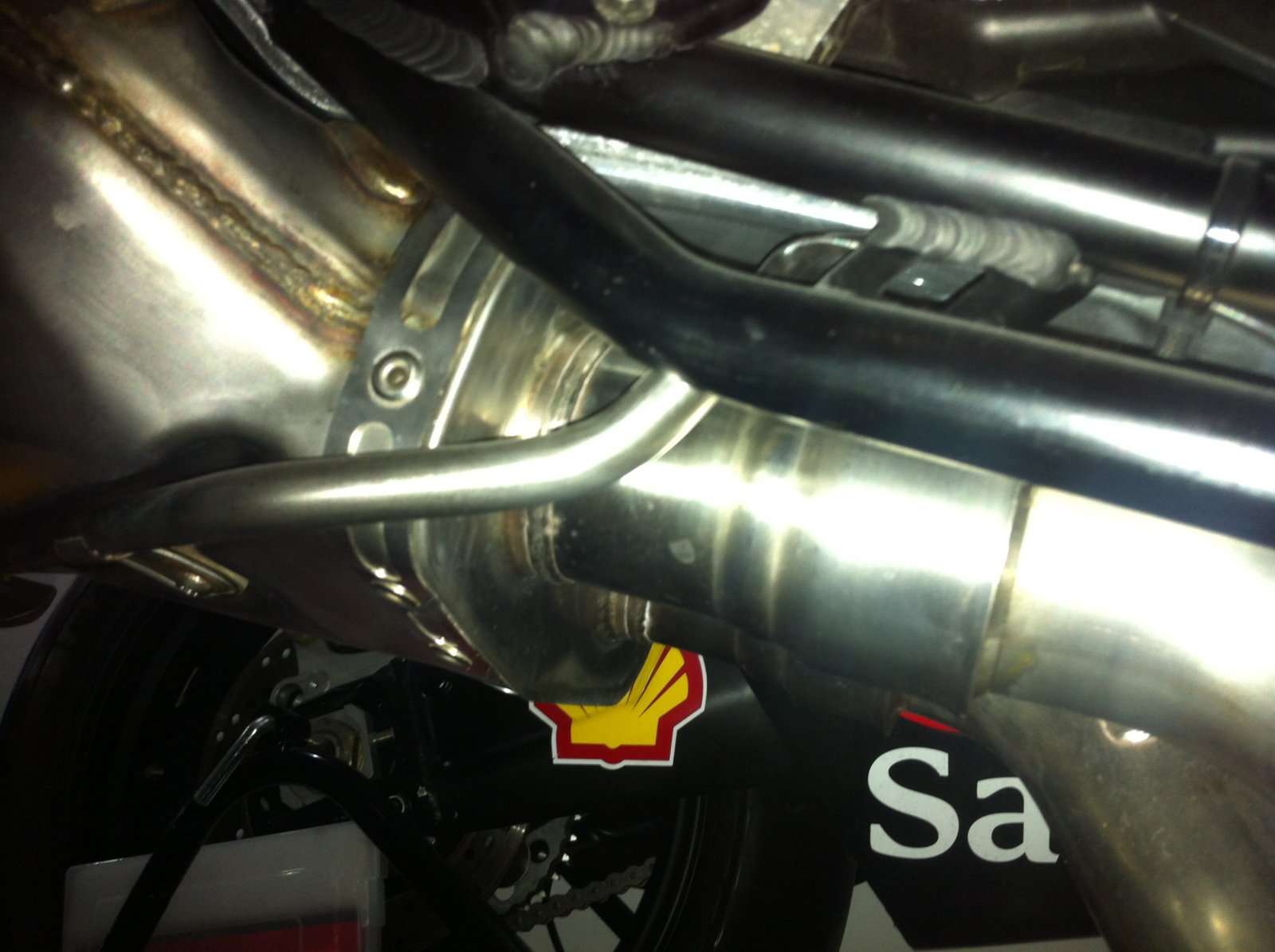

  8. I thought you said they changed after 03/04? My Fila is number 155 and was produced in July 2003...
  9. Not sure if it's a Ti box - it was on the bike when I bought it :)
  10. It's a few years now lol, I had a brand new 999s in 2003 and my buddy had the r, and I changed the exhausts for him to the non cat system supplied with the bike, and I'm sure the open can was the same as the standard as they both used the self locking nuts that sheared off the studs as they were poorly manufactured at the time. And I had to remove the nuts to fit the open 'race' pipe...
  11. Never heard that they were but someone may come along soon who has an earlier bike, my other R is a Jan 2003 but as above, had the 57mm system on when I bought it and I also got the standard Ducati can but not the original Termi half system - wasn't bothered with it having the full Termi system :)

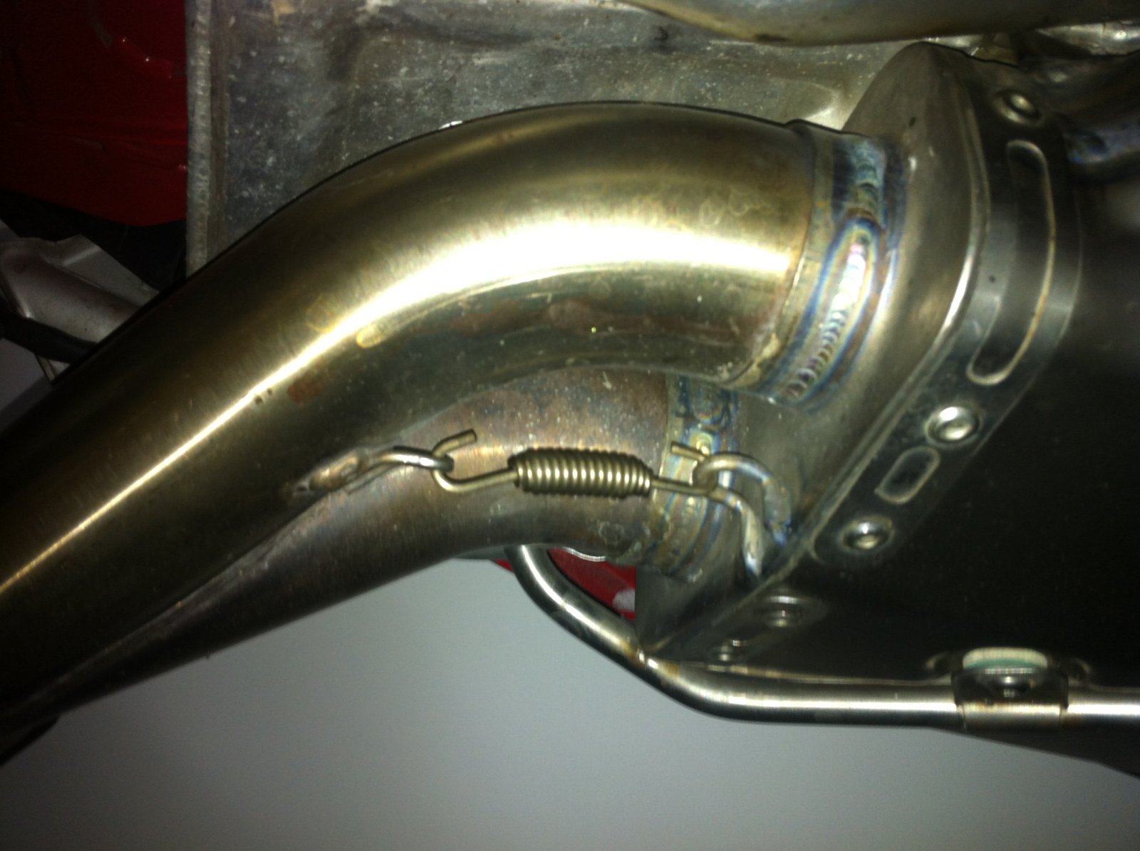

  12. [​IMG]
    This is the 57mm steel box and you can see the weld discolouration on yours and the rust on mine lol..
    I had the Ti end box on my previous 999 and ended up reclaiming the box on guarantee 7 times..!
    At 1800 euros a shot the dealer always going nuts, make sure that the box is not fatigued around the upper main bolt bracket as that's where mine always failed. I believe a different/ modified box was released at some point to reduce flex in the body of the silencer.

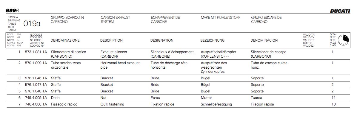

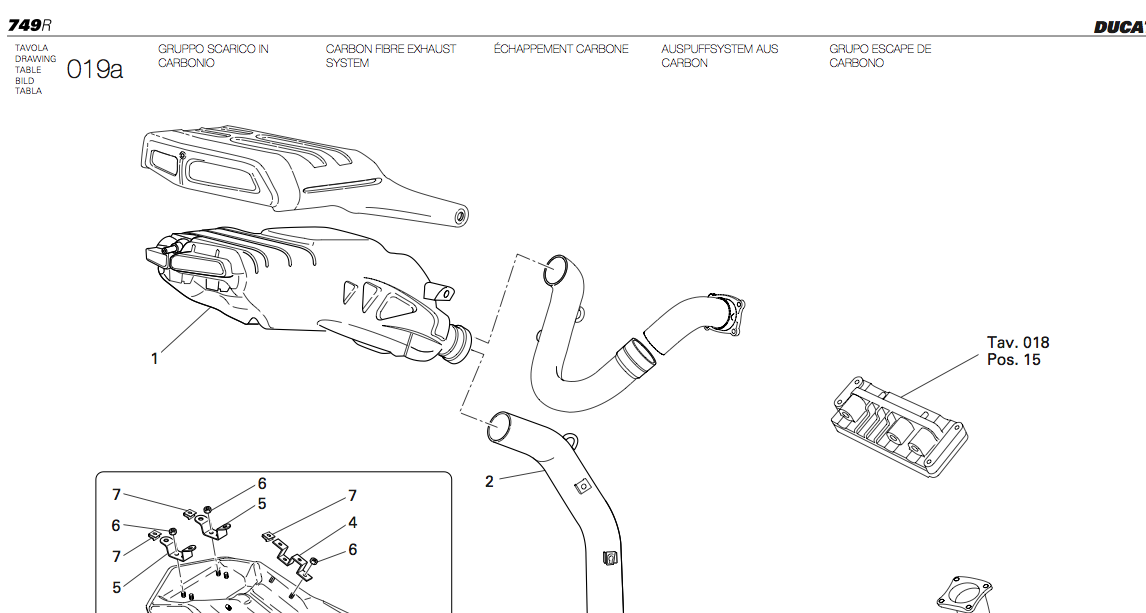

  13. Just to throw a little more confusion into your plight I checked your numbers too and came up with this.
    Oh and this is from the 05 year parts list.

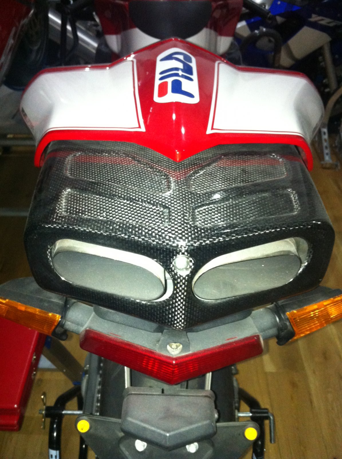

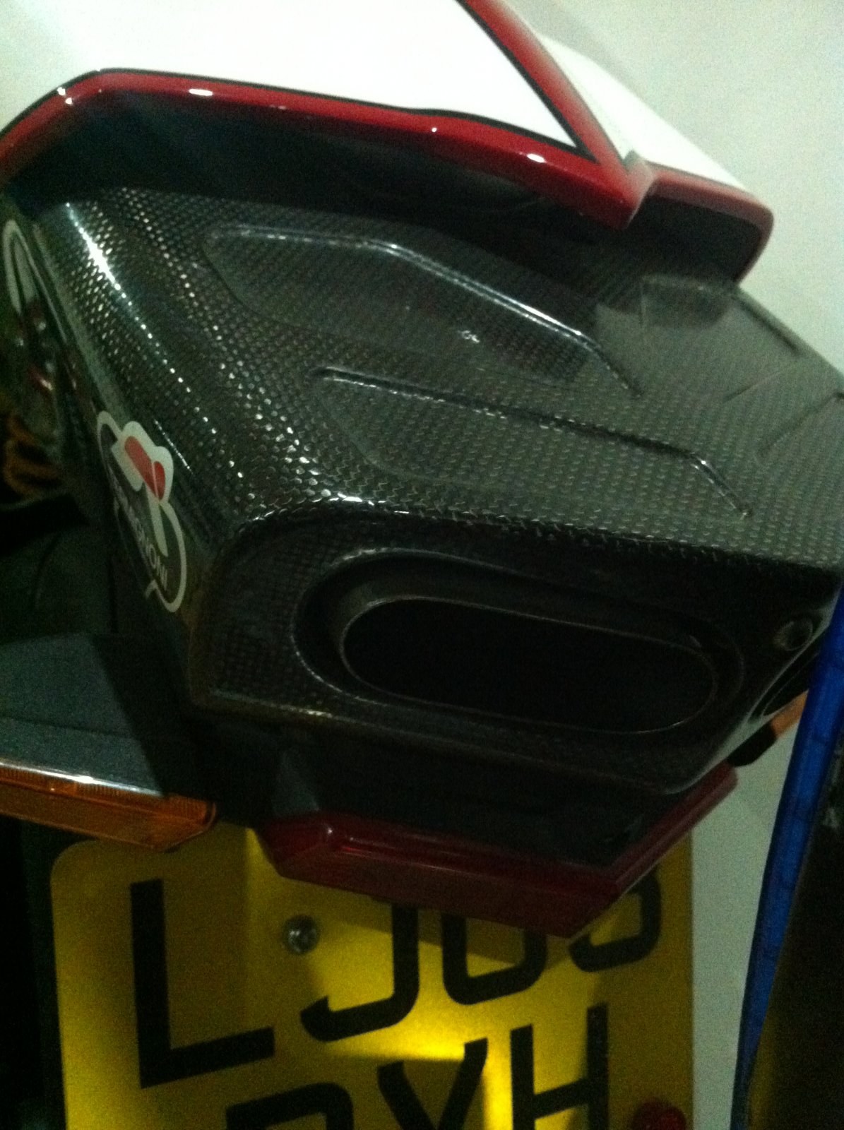

  14. Well mine is definitely not carbon fibre... Has anyone ever heard of one??
  15. I guess the carbon is reference the heat shield ??

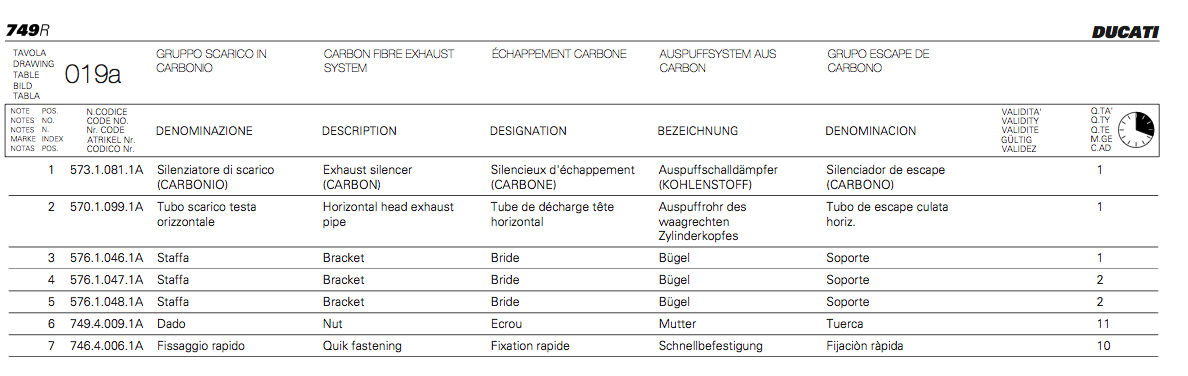

  18. Its refering to the carbon cover . Heres the one from a 2004 999R . Same number so the number riders of bridgewater are stating is the wrong one for whatever can it is .
