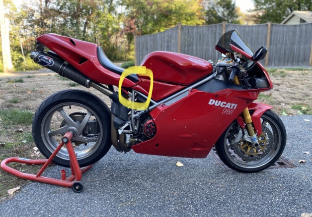

  1. At the time I took this picture: no, they were not correctly mounted. The previous owner used the wrong hardware to secure the silencers, and there was a cascading effect of everything being out of place.
    Take a look at this post from the build (well, restoration) thread I started. Do you think the subframe is original? If so, what color is it supposed to be?
  2. as in my previous post. Its original…
  3. Blimey, that link took me back in time. Red is not an original colour, iirc biposto subframes were the same colour as the frame, monoposto subframes are a bare aluminium alloy colour. Someone could have painted it I suppose. Without comparing the two side by side it’s impossible to tell (ignoring the colour). However, it’s what’s on your bike so you have to work with it.
  4. Thanks guys. The bike has a load of non-original bits (most of which I am removing) so I would not be surprised if the subframe was painted. I haven't decided if I want to strip the paint and clear it, or paint it silver (like the subframe on my HM1100S).

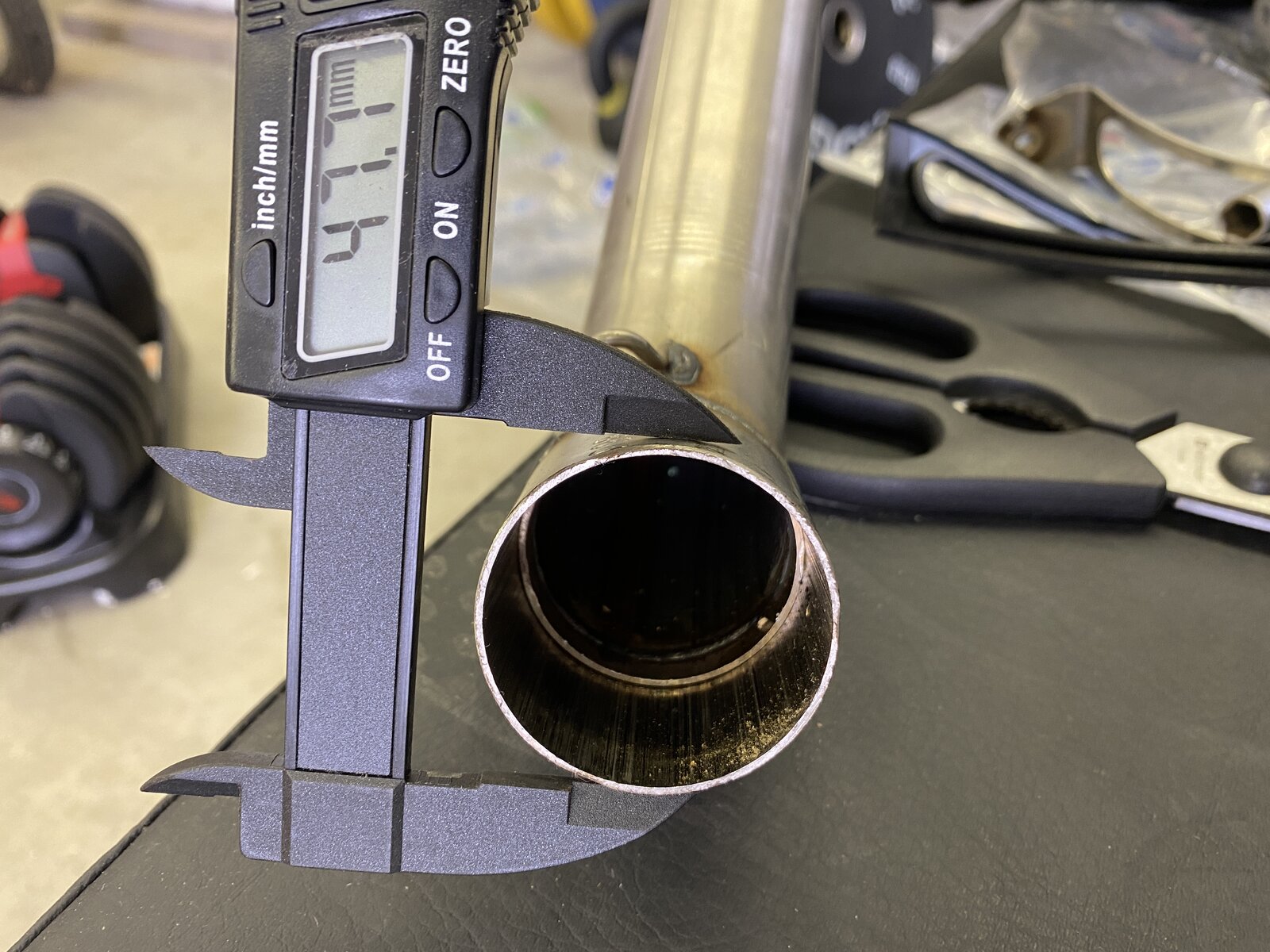

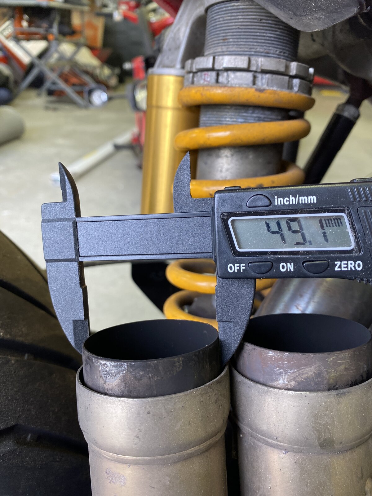

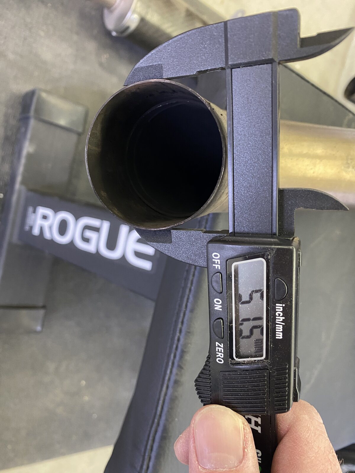

    Oh, last but not least I threw a set of verniers on the pipes and they were 49.9mm right before the existing CF silencers.
  5. Are you’re titanium silencers 45mm or 50mm then? If the current CF ones are 50mm you obviously have a 45/50 link pipe.

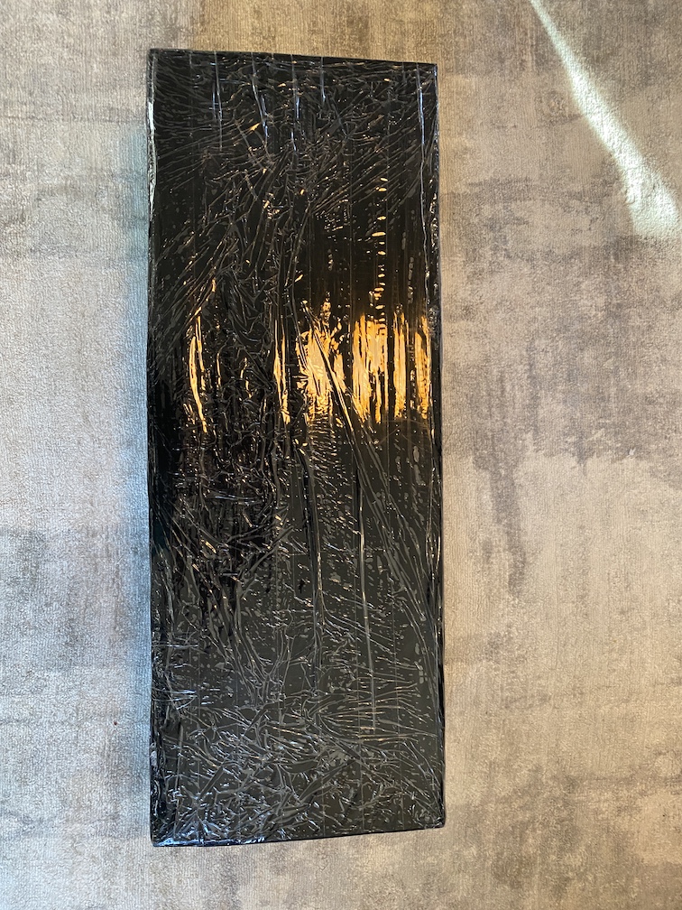

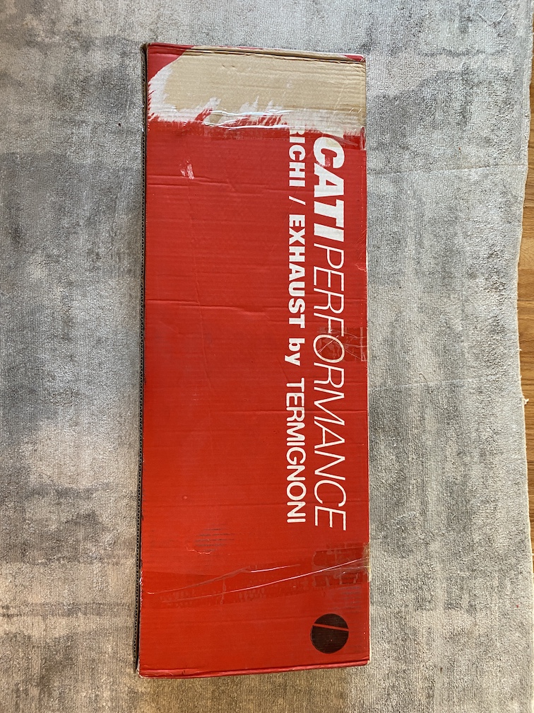

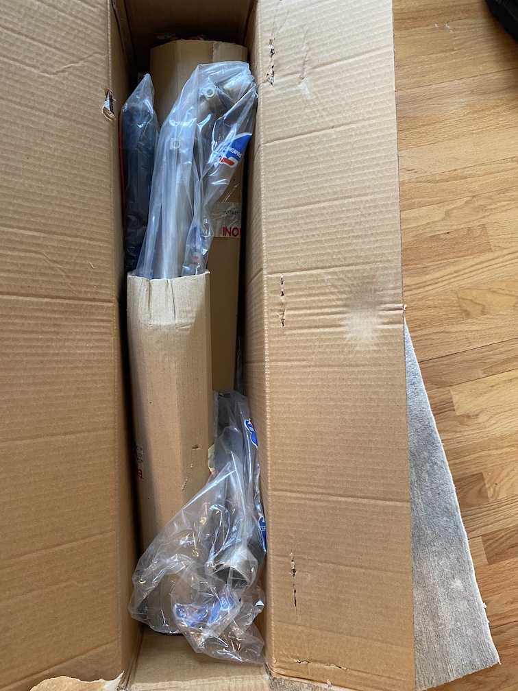

  7. Judging by the Ducati part number, the Ti cans are 50mm. They come with a Ducati ECU as well. Speaking of which.. :)
    What's this then?
    As my mother would say, it's all Greek to me:
    The moment we've all been waiting for
    As far as I can tell, it's a NOS exhaust. I'm not even sure the box had ever been opened! Weirdly, it came with a little Dainese bag in there as well. I didn't unpack anything further as I didn't want to scratch anything. I'll try and install it on the bike this weekend.

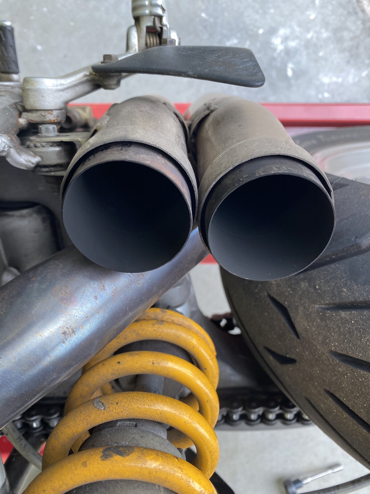

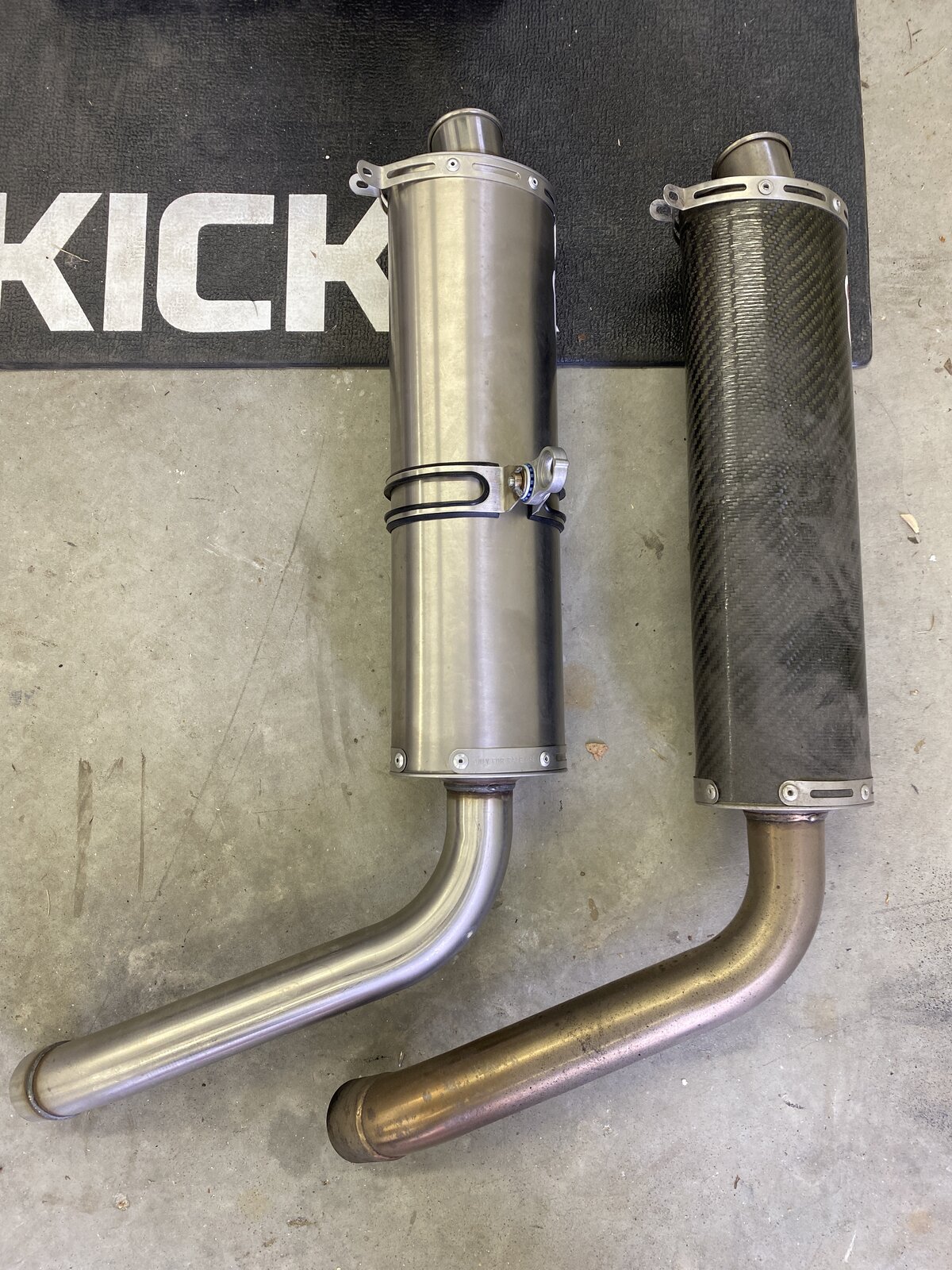

  11. I think we've had a bit of a cock-up. The new exhaust clearly doesn't fit, as the Ti exhaust has a smaller OD than the outgoing CF exhaust. Sigh.
    New an old exhausts, side by side:
    Old headers:
    OD on the new Ti silencer is approximately 48mm:
    OD on the old CF silencer is approximately 51mm:

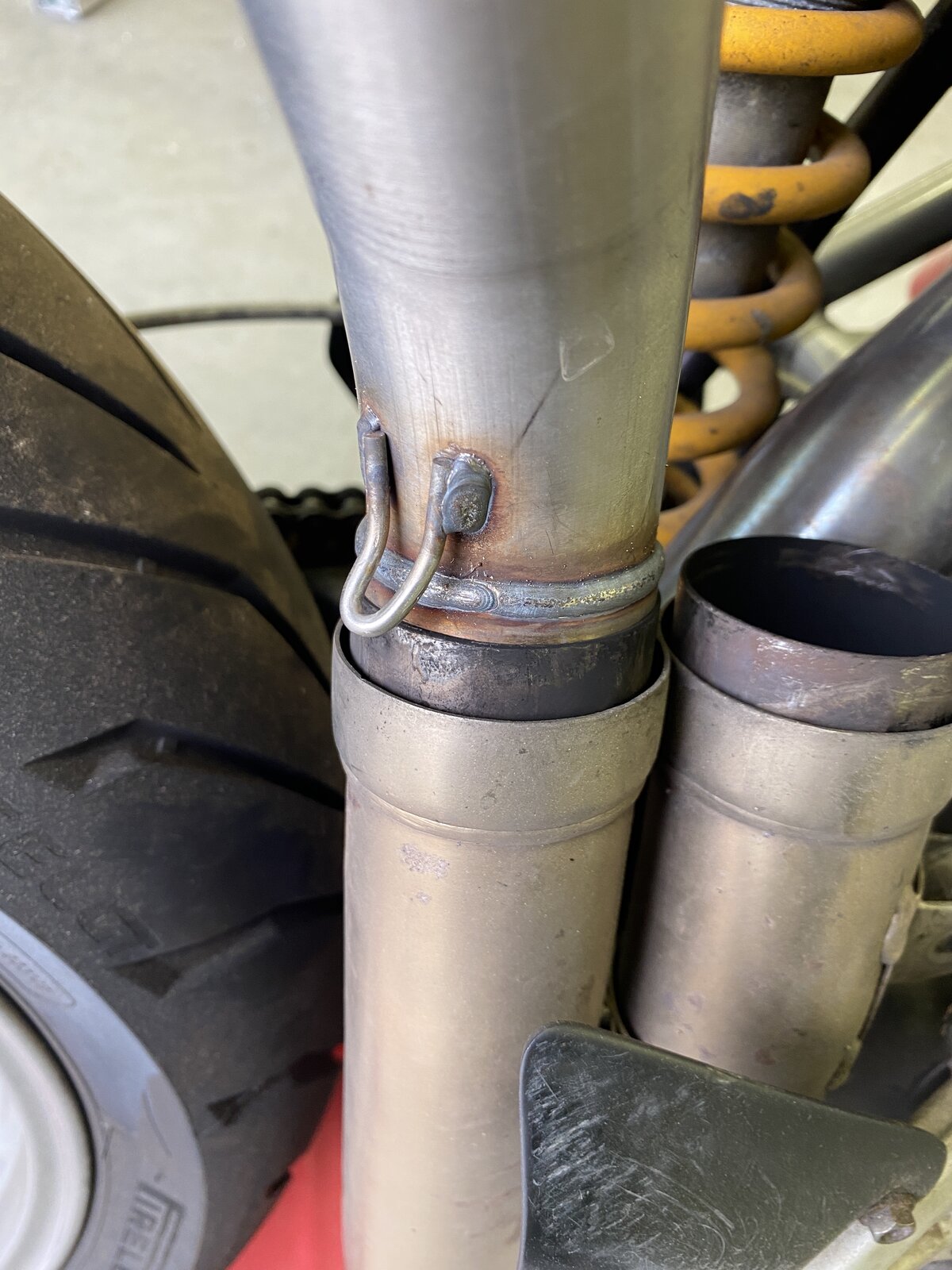

    Fitting the new Ti silencer. On the old CF silencer, it would fit into this joint:
    I feel like an idiot. What can I do to fix this that doesn't involve chopping up anything? My guess is that I have a 45mm-50mm link pipe for the CF system and what I need is a 45mm-45mm instead for the Ti system.

  12. You’ve been sold 45mm Ti pipes and you have a 45/50mm link pipe :(.
    Yes, the stock 998 link pipe will work as that’s 45/45 and yes that’s the correct part number.
    You may have to change the heat shields you have too as different link pipes have the mounting holes in different places.

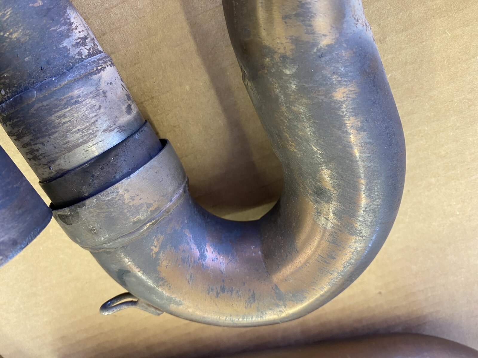

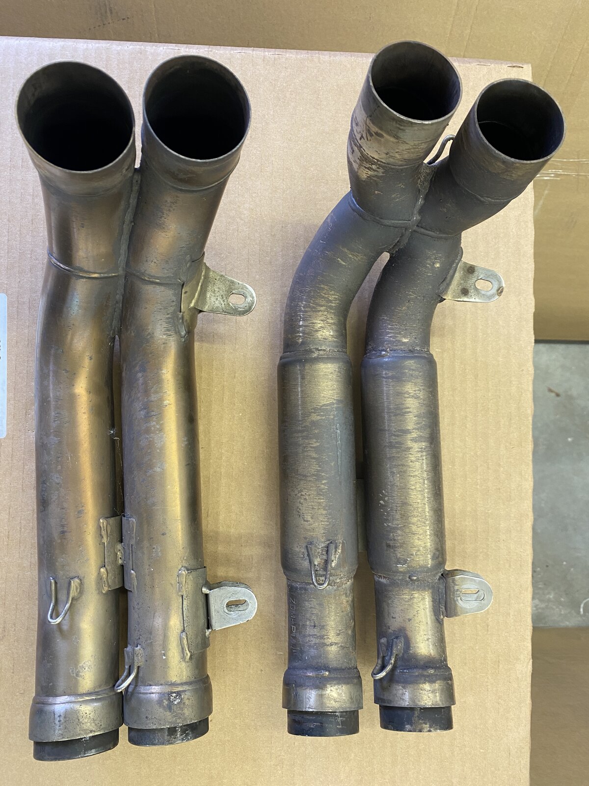

  15. This has turned into a bit of a farce. The new (used) OEM 45mm-to-45mm link pipe arrived today, and it doesn't seem to fit either. I think my issue must be that the existing CF system is actually a full system, not just silencers?
    Here are the link pipes side by side:
    And here's what happens when I try and install the 45-to-45 link pipe on the existing headers:
    You can see that the 45mm link pipe fits in the "inner" part of the header, but not the "outer" part. Can I use the system like it is, or do I need to get OEM headers as well? At this point I'm seriously considering punting things. I guess the other thing would be to find a local exhaust shop to convert the OEM 45-to-45 link pipe into a 50-to-45... but that seems a bit Heath Robinson

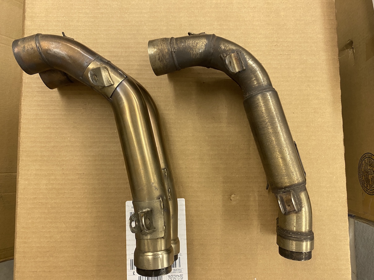

  16. This is quickly turning into farce. I should have seen this problem coming, but I didn't: I had a local exhaust shop enlarge the inlets of the 45-to-45mm link pipe to turn it into a 50-to-45 link pipe. So far so good. But what I didn't realize at the time was that the geometry of the OEM 45-to-45 (now 50-to-45) link pipe and the Termi 50-to-50 link pipe are quite different. I had assumed that Termi headers would run in the exact same locations as OEM pipes, but they don't.
    Because of this, and even if you ignore the size of the ports, the shapes are different and the overall dimensions are different. You can see them side-by-side here:
    The camera distorted the perspective a bit, but the 50-to-50 pipe is clearly taller and "wider" than the newly-resized 50-to-45 pipe. Once it's installed, it doesn't really fit: the silencers connect to the link pipe, but the headers are in the wrong place and it turns into a dog's breakfast.
