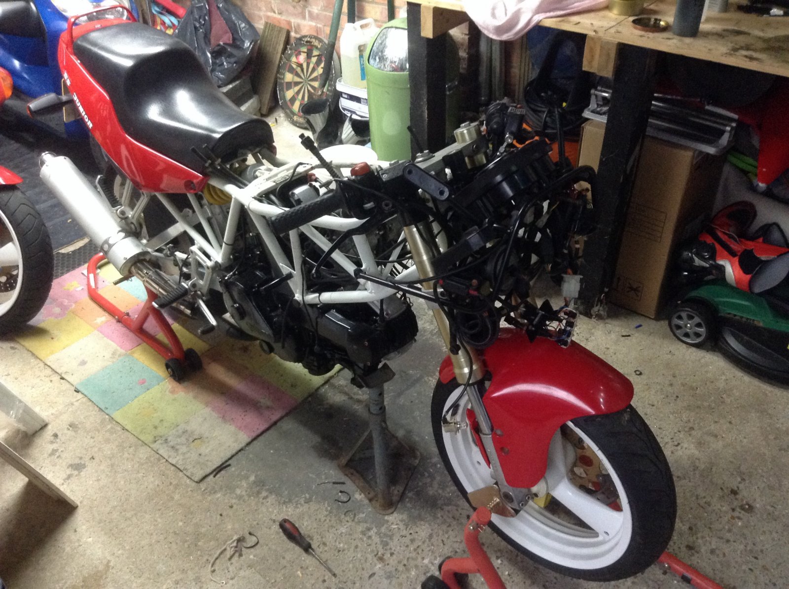

  13. Quick up date, nearly back togeather, carbs are done and will be refitted. just need to sort out service parts and order new brushes for the starter motor. I also need new cables, anyone recoment somwhere for non gen parts??
  14. things are going to go a bit quite on this for a while, new kitchen to fit, yay!!
  15. yes, nice looking bike but not a hope in hell of achieving that price ^
  16. Quick update. The kitchen took over last year so little done. I have fitted new belts (supplied by a very nice man on here) and turned the engine over with a battery for the first time. Have been all over the electrics, new oil pressure and neutral switch needed. Small amount of re- wiring needed on the ignition system, and I need to get fuel cap seals. Apart from this and a new rear tyre I'm nearly ready to start up, note to self, must put some oil in the engine before starting.
