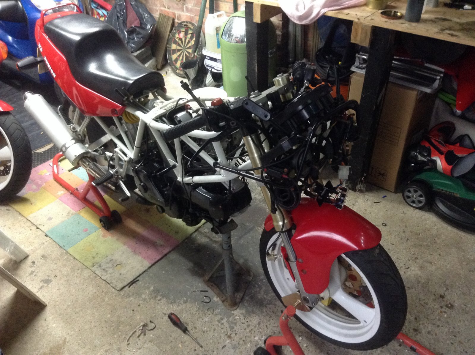

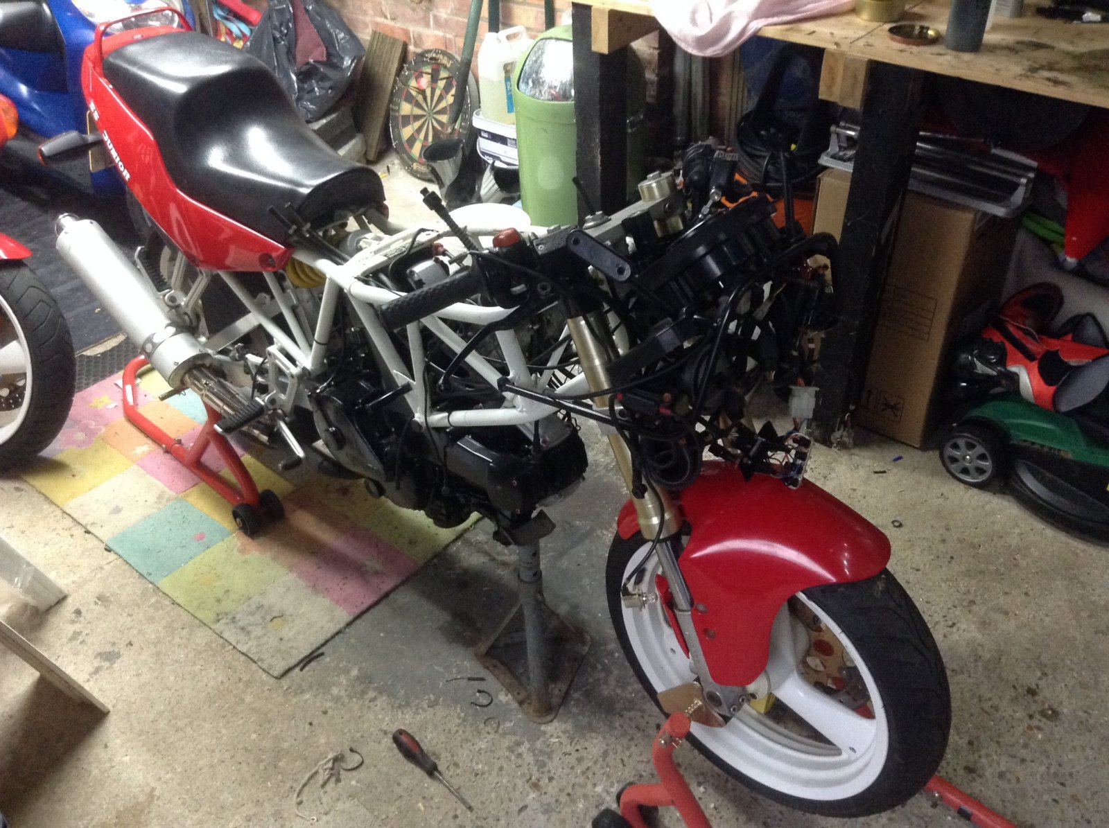

  1. Come on get a move on please :)
  2. Thanks all. We're going on holiday soon so I'm trying to get it nearly there before then. So all electrics have been through and seem to be good, spark at both cylinder. So just need the two switches, oil and filter, seals for the fuel cap and a rear tyre and a lot of luck, the old girl might start. I might rig up some fuel supply and give her a try, just to see if there is life.

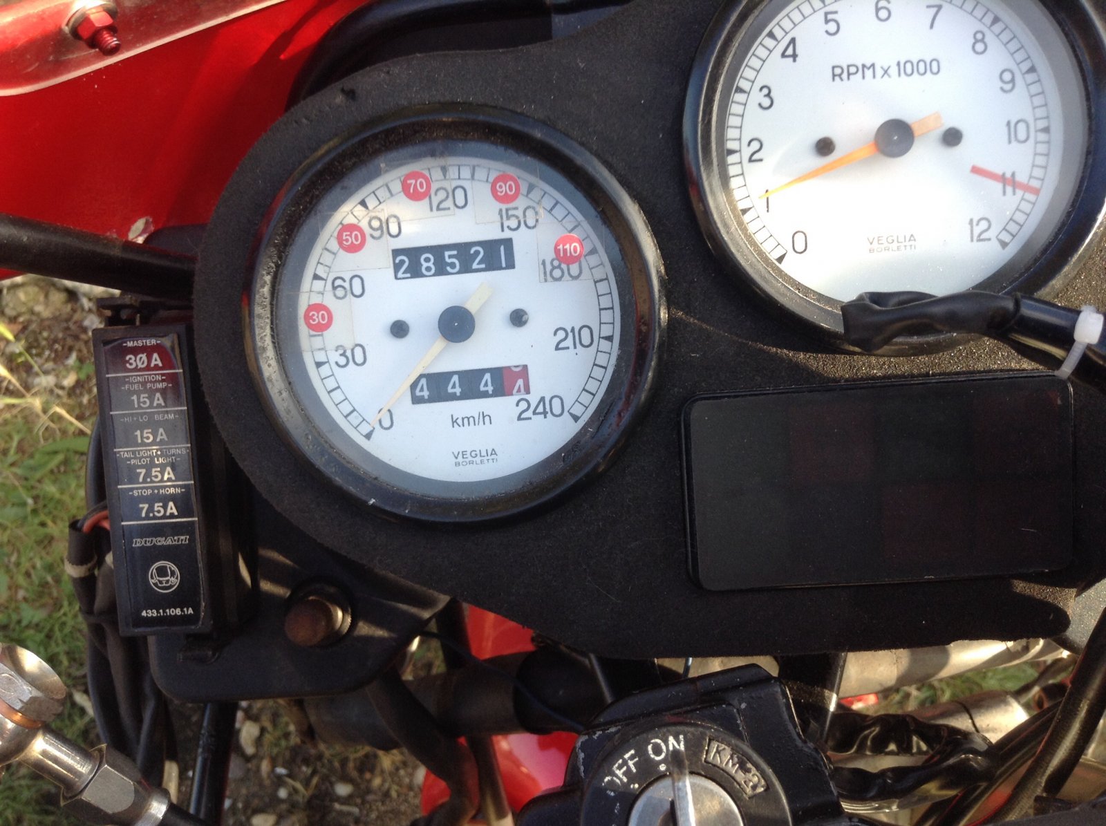

  3. It lives!! Before I put the battery back onto my other ss (tomorrow is definitely a Ducati day for getting to work)I couldn't resist putting a little petroleum down the carbs and hitting the start button, and low and behold if she didn't run for a few seconds. Hope to have a full start up the weekend after next, it I get my figure out and order the few bits I need, better start to talk nicely to the wife!
  5. Thanks, amazing it started better than my 750 did, considering it hadn't run for 10 years, and the sound is amazing too, even the wife said it sounded nice!!
