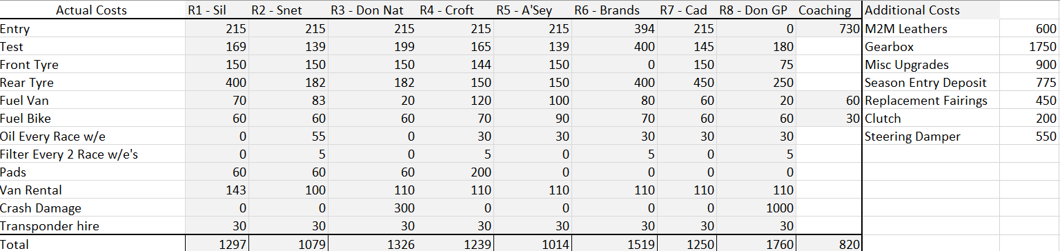

  1. Thanks for letting me know im too poor for the sport!:joy:

    Finished my first season racing with NLR this year in 1000 newcomer on my RSV4. If you want to be at the thick end of things £20-25k is a fair estimate.
    Also depends if you are including the cost of the bike and will go further north if you drop it more than a couple of times.
    Happy to share a full breakdown of my costs if it’s helpful.
  7. Really interesting seeing everything tallied up. On the pads, what did you change from and to and out interest? I've seen others mention about the longer life of z04 being considerably better but the cost is obviously a chunk more. Or is this now considered racing secrets? haha!
  8. If racing, I’d say Z04’s are a bite the bullet item. I was staggered by how much better they were than what I was using before. Which I can’t remember :laughing:
  9. It's actually a brand called ZCOO and they are called Racing Ceramic Sintered Brake Pads Type C as Brembo don't make a Z04 for my bike. Not a brand you'll see an abundance of in the UK. I was using SBS Dual Carbons before and they pretty much melted before my very eyes. Always had to have 2 full spare sets. Good pads performance wise, just no longevity.
