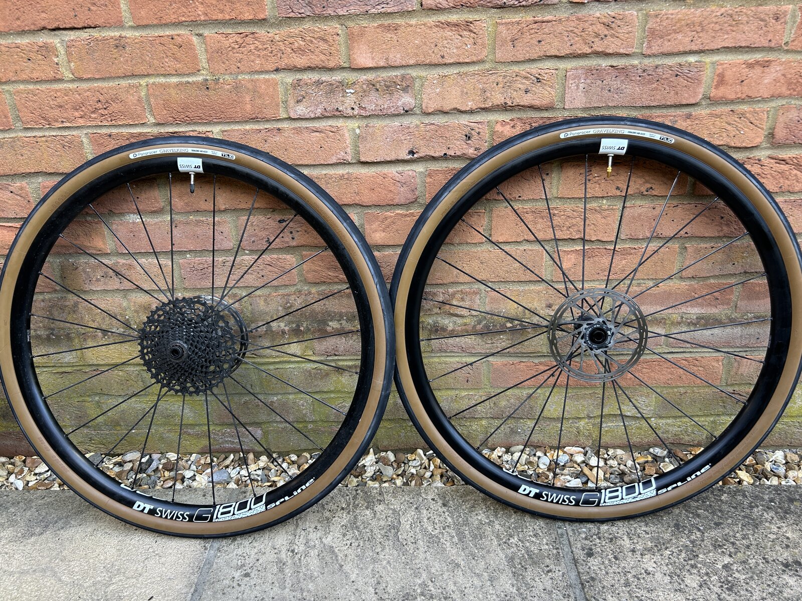

  6. Took the virtually worn out winter tyres 45mm schwalbe off the winter/commuter bike and put on the panaracer gravel king 38mm . I spent ages with the compressor but they just wouldn't seat tubeless. I used them last year and they were a pain then. Had to put tubes in, I won't ever use them again when they come off.
  7. Try running a ratchet strap around the circumference of the tyre, compresses the bead to make an air seal. Blast from the compressor can sometimes give you the desired pop.
    Tubeless tyres can be tricky to use multiple times, the initial stretch and seat seems not to lend itself to subsequent refitting.

  8. Thanks for the tip. Frustrating as popped a tube in and pumped up with a track pump and the beads pinged in seconds

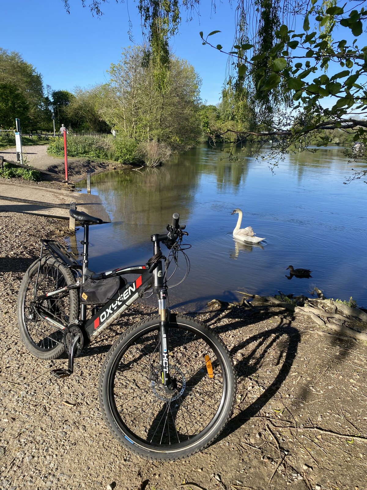

  15. first assisted trip on the spare bike.

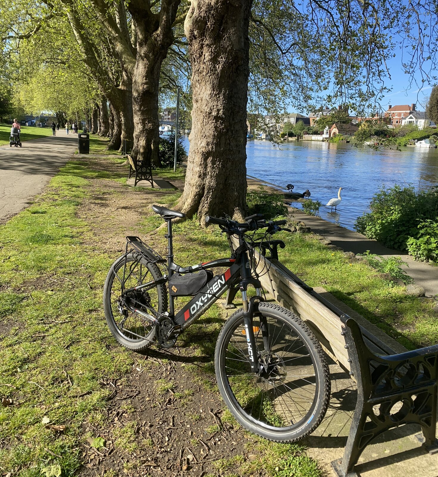

    sometimes you have to pinch yourself Gary don't you? Very little pains today so just seized it. Hope you are not too bad mate. Handlebars too low on this one so just resting my palms on the top and trying to relax.
