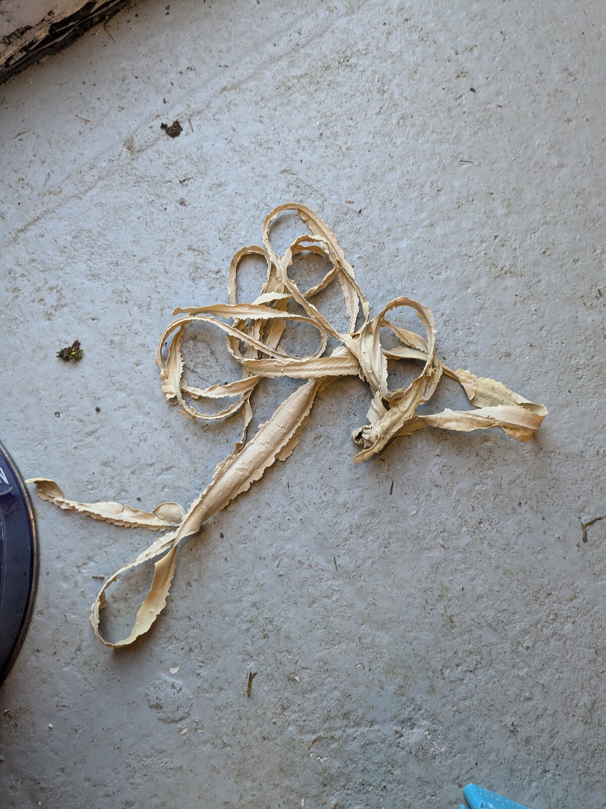

  8. Cleaned out the old sealant in my nice Ribble gravel bike in readiness for using it in better weather, wishful thinking I reckon. Tyres went on fine and blew up tubeless first time 10 mins job.
    The old winter/commuter pinnacle bike has had tubes in since fitting winter tyres and I've had 3 punctures in 2 weeks. Enough of that so set that up tubeless again . What a pain , sealant leaking and tyres not sealing. Cheap shit rims ,hours in the garage messing about just checked them and they have stayed up overnight and all day so should be good for the ride to work tomorrow.

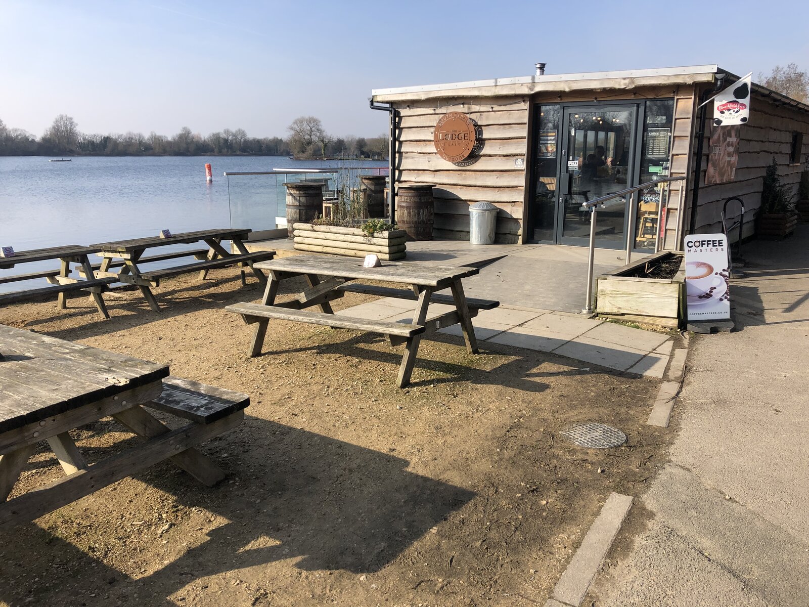

  17. Modest 25 mile season opener up to the Cotswold Water Park.
