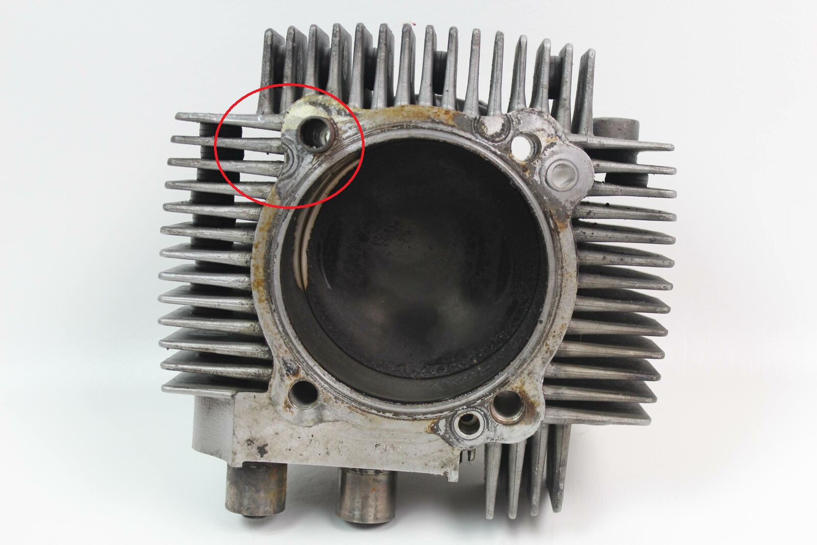

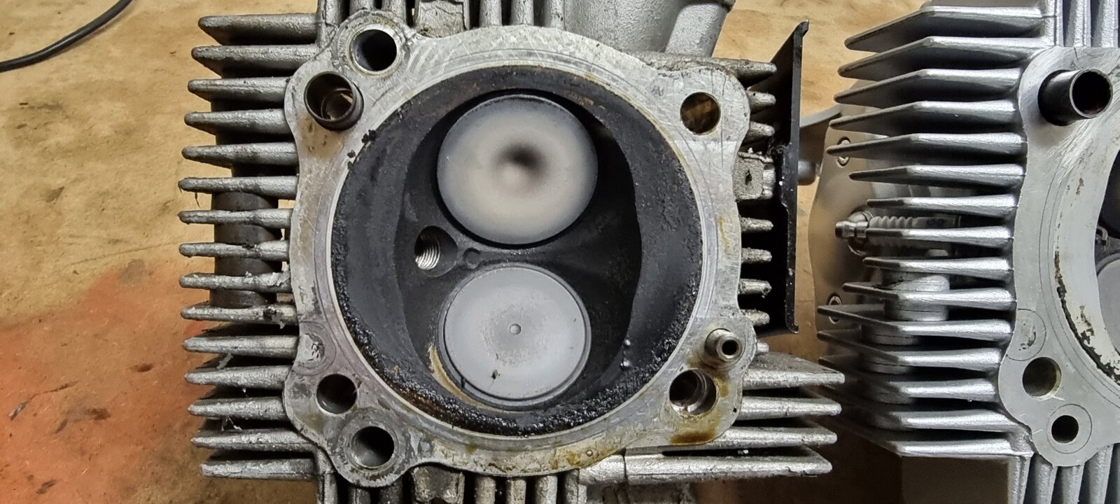

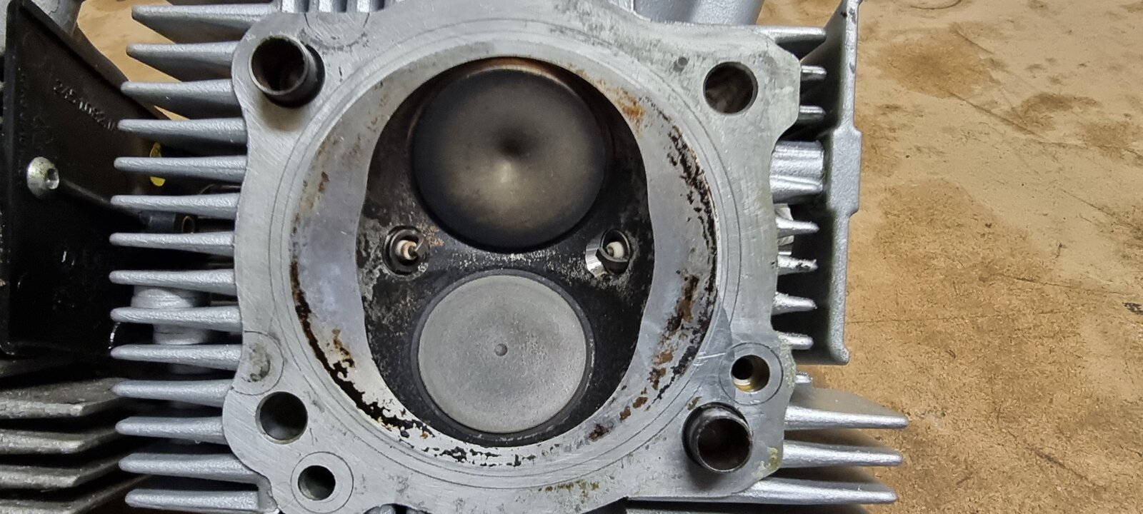

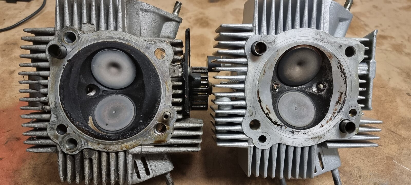

  12. Just spoke to someone who races these engines. He told me you can swap these barrels and pistons, evo and ds, horizontal an vertical, even mixed. He says the bigger and extra oil channel in the horizontal is not necessary.
  13. 20211019_233146.jpg Hi,
    Correct! You can mix the cylinders.
    But you need to handle the extra oil channel becasue it is there, even if it is not necessary.
    In your pictures you can see that if you on the horiz cylinder mount a DS cylinder head on a Evo engine, you will have an issue.
    Because the DS head will not block the passage from the cylinder so you will end up with open passage from the crankcase. Which will give you a oil mist from there.
    In the other picture you can see that if you on the horiz cylinder mount a Evo cylinder head on a DS engine, you will have an issue.
    Because the DS cylinder will not block the passage from the Evo cylinder head so you will end up with open passage from the head. Which will give you a oil mist from there.
    When I mounted my CJS ported DS head on my M1100 EVO engine I got the Oil mist and ended up threading the oil return passage in the evo cylinder with M12 and screwed in a M12 stop screw to block the passage. Which works fine for me.

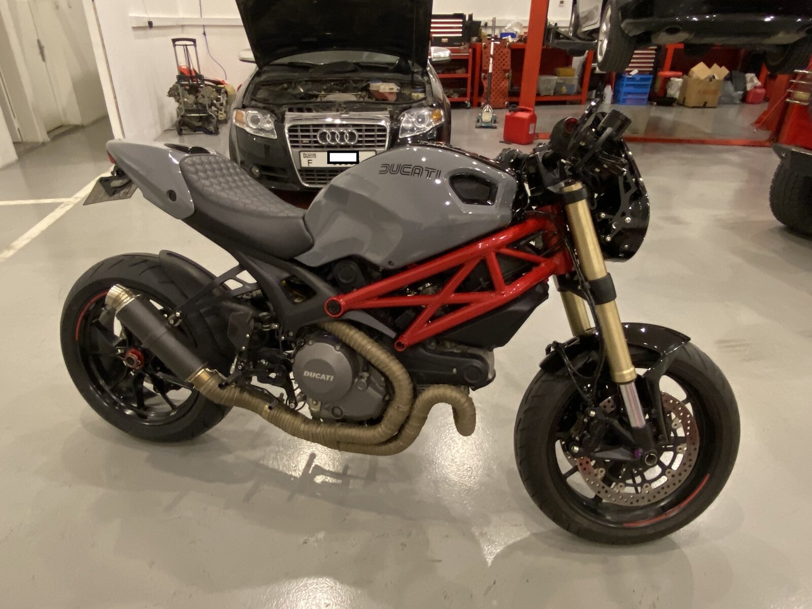

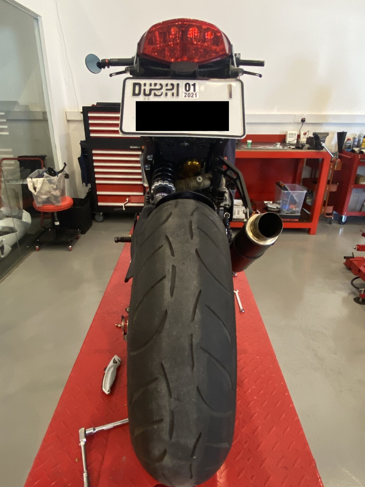

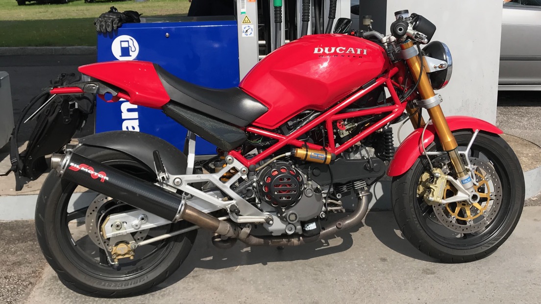

  15. Hi shirt
    My monster has a Werks slip on fitted but do not really like the looking it, noticed you have fitted an SC slip on to yours are you happy with it as I am thinking of buying one, did you buy an Evotech mount for it also ?
    Also noticed you have taken off O2 sensors and exhaust valve, how easy are these to remove ? And is it 100% essential to then have the ECU reflashed
    Thanks
    Steve
    Any photos may help
  16. Hi Steve,
    I must admit I didn't try it without the reflash. I sent the ecu away, ordered the parts I needed, then went away for a bit with work, putting it all together on my return. I still have a DP ecu, might be worth swapping them over next time its in bits.
    Yes I'm very happy with the SC slip on [GP-M2]. Its bloody loud, to the extent I've got a db killer on its way. I usually ride with custom earplugs and it doesn't bother me tbh, just I ride to work and back through winter and I can't sneak in and out the car park with the SC on! Its notably louder [barkier, not as deep rumble] than the shotgun termis.
    Yes, got the evotech hanger and would deffo recommend it. 02 sensors were easy to remove. I got an eliminator kit with the bungs and plugs, dead easy. Valve you can disable with various company's tuning boxes, but I went the whole hog. Removed the flap from the exhaust and welded up the holes, removed the servo and the bits under the seat.
    Not many pics with me but you can see the 02 bung on the first one. Don't think about wrapping the exhaust. Looks great, but means taking the subframe off to refit it in one piece.
    ETA: SC's customer service is shocking btw. I ordered the db killer via Conquest Racing just so I didn't have to bother with the factory again.
