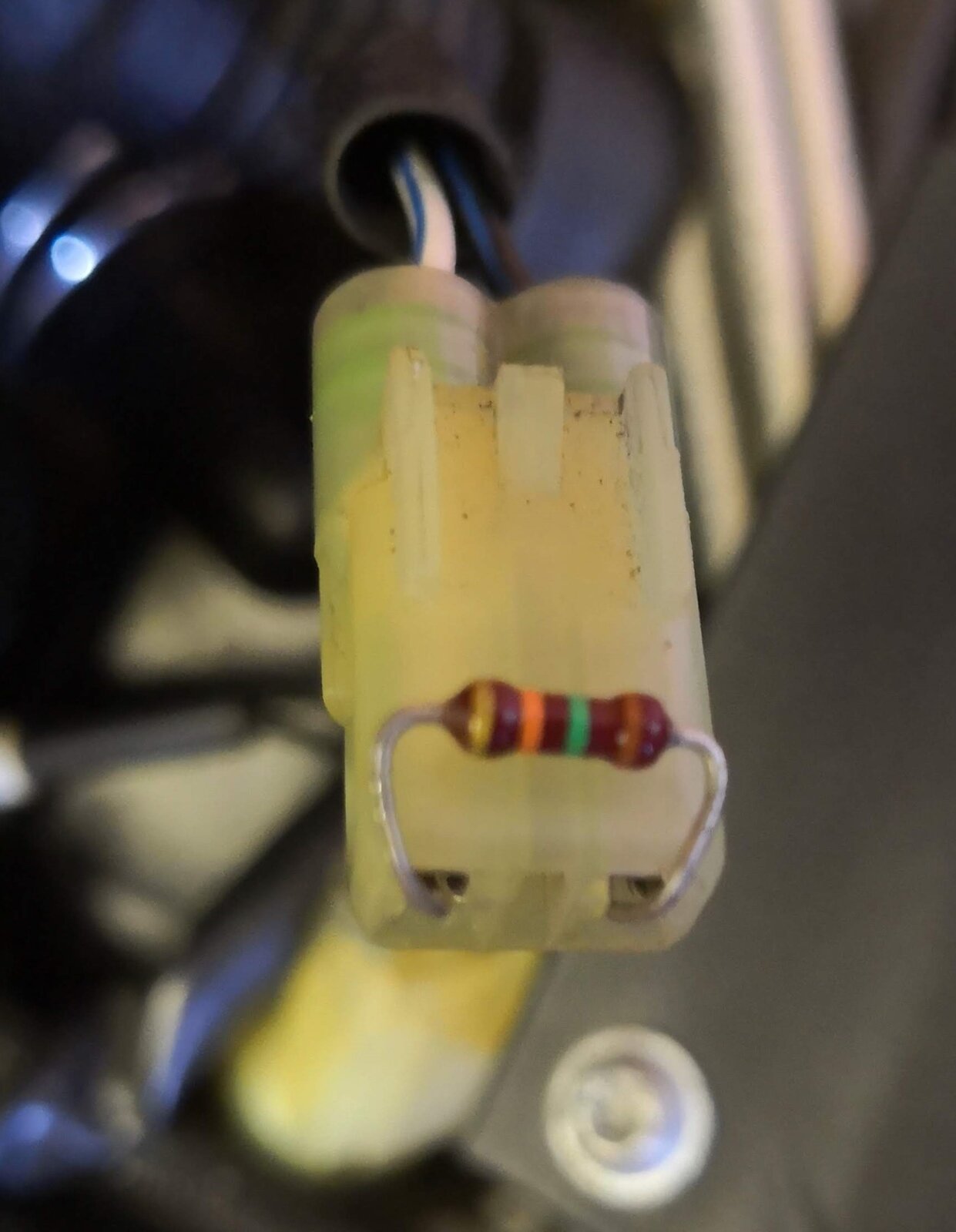

  16. 2014 Multi, have had occasional stickyness for over a year that cleared on restart / while riding. Then full on sender error, engine warning light, low fuel & flashing gauge. I have asked if there is any goodwill available - waiting for a reply. Temporary solution to the warnings & flashing is to fit a resister. 2.5Kohm = 2 bars indication does not clear low fuel light. 15KOhm = 3/4 full indication, fuel light cleared. 50KOhm = full indication, light cleared.
    If nothing else it clears the sender error, engine warning light & flashing dash indicator.
    At your own risk naturally.
    Mike
    #36 mikele, Aug 2, 2020
