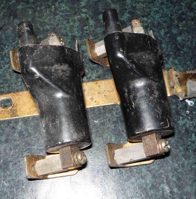

  13. They may not be the sealed ones, just a wipe of silicone round them..............if they look like these, they should be screw-in leads....

  14. Thanks Al, no mine are not the same as the pic they are grey and look smaller. Will have a play tomorrow if i can, I'll start at 2 1/2 then work from there. Float height are both at 14mm. Never thought about taking the top of the box will try that too. My fuel light is on, could this be a problem(lack of fuel intraining air?). Might have to ask you to come and have a look Al, it could just be me doing something stupid!!
  15. I have some spare coils........
