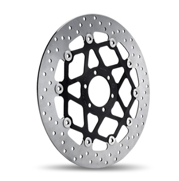

  10. Fully floating look like this with the bobbins (should be fitted to your 848) and you can spend lots to upgrade if not already fitted;
  11. Yes, that’s what mine look like.
  12. yip, familiar with them.
  13. Yours?;
    I guess semi-floating so still need to be cleaned and free somehow
  14. aye, thats more like em. i toyed with removing em the other day when i had the forks out. but...
  15. Not sure about the semi-floating ones but I believe you have to drill out the fully floating ones :confused: maybe liberal soaking with brake cleaner and 'wiggling' may get them suitably free? I don't think there should be much movement as they are only there to take up heat expansion during spirited braking :upyeah:
