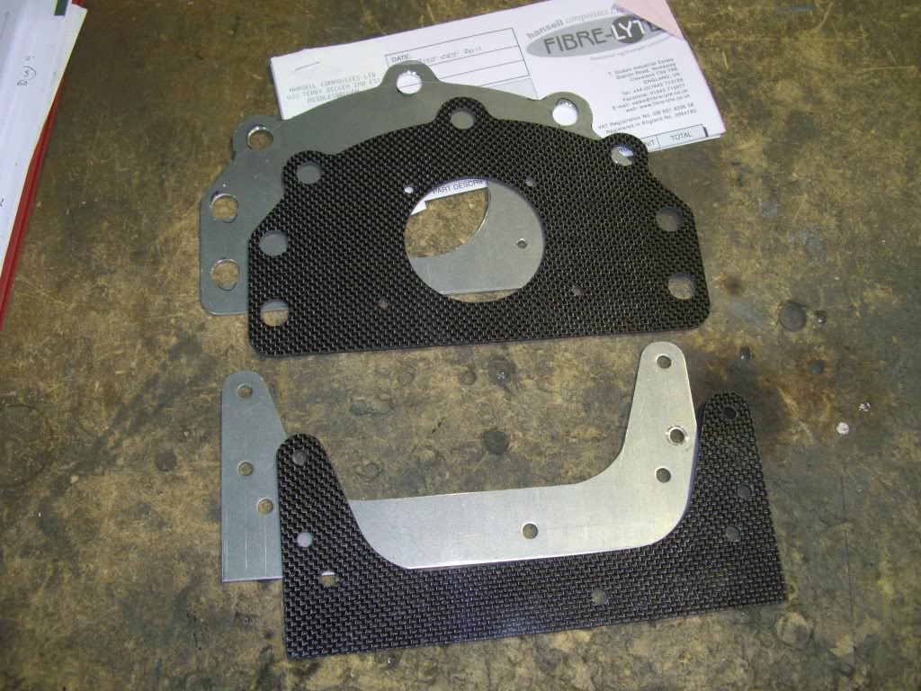

    I made a couple of versions of a carbon bracket to hold the Translogic dash. the first one I was never really happy with:-
    You will notice the cnc top yoke I had. I thought this was great as the one with the bike had previously had a plaque that had been removed, badly. Then 'rossdj' on here got a 916 and I fell in love with the standard top yoke, so sourced a better condition one. The new dash bracket I have is this:-
    The patterns I made in aluminium to prove the design, then the carbon version is from Fiberlyte.

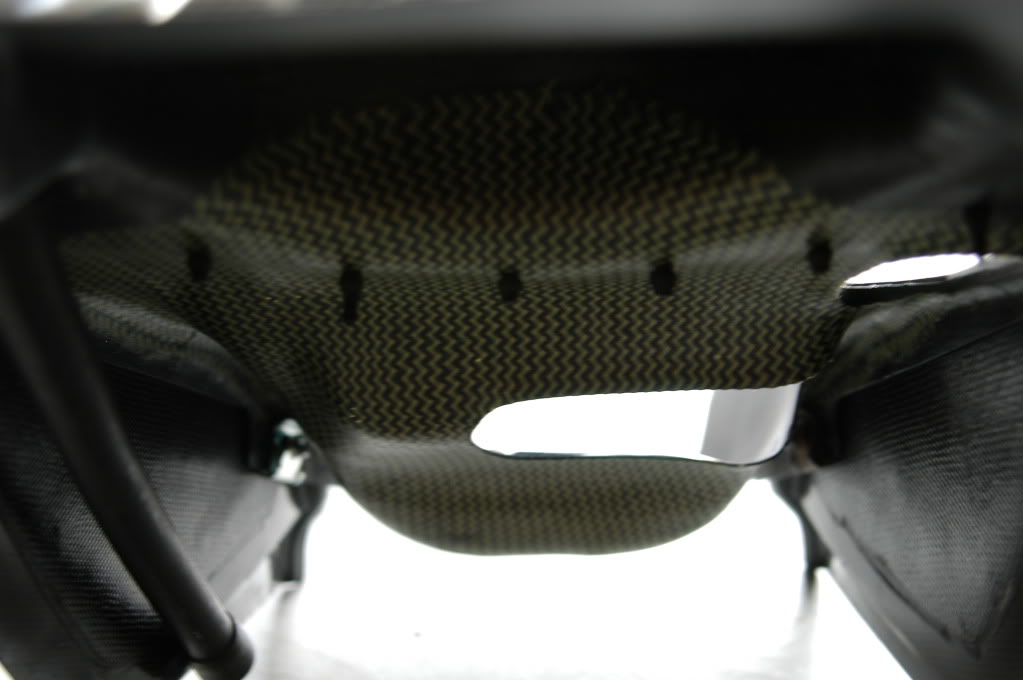

    Clutch spring holder used as a mounting point on the air tubes. The factory I have found out since use a threaded bobbin, but I prefer the simplicity of a rivet.
    The rubber band is an o-ring we use at work, which happens to be the perfect length.

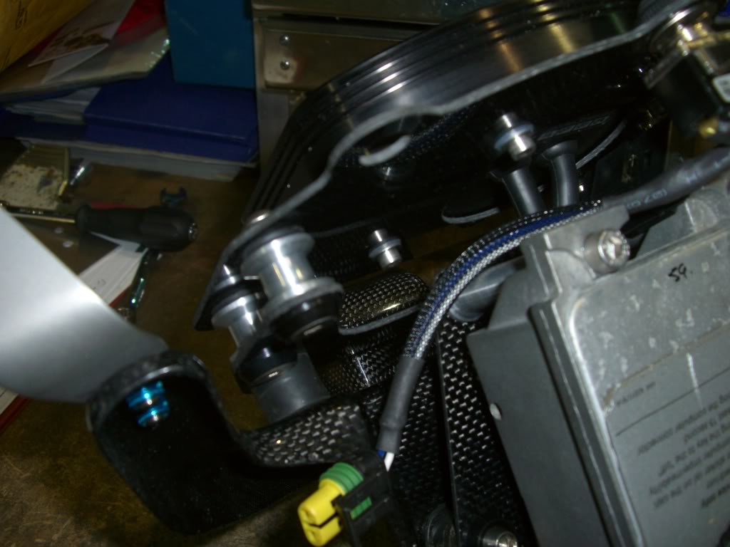

    The bits I made for the dash were anodised black:-
    And fitted:-

    Interesting how you've mounted the dash. I used the original mounting points onto a carbon backing plate then bolted the dash to that (via some rubber stand-offs) so it can be used in road trim.
