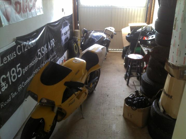

  8. Very rare bike you are the second member to pick up one this year. What year is it?
  9. 1999 - seems legit on HPI and has all the bits, although it has been sat for 3 years (Looks like it has been sat outside!) Got it from northern Ireland and landed with me last weekend!

  13. cheers guys. i really havent done anything more to the bike, its just sat under a dust cover. i do have a couple more images tho, if thats any good?
