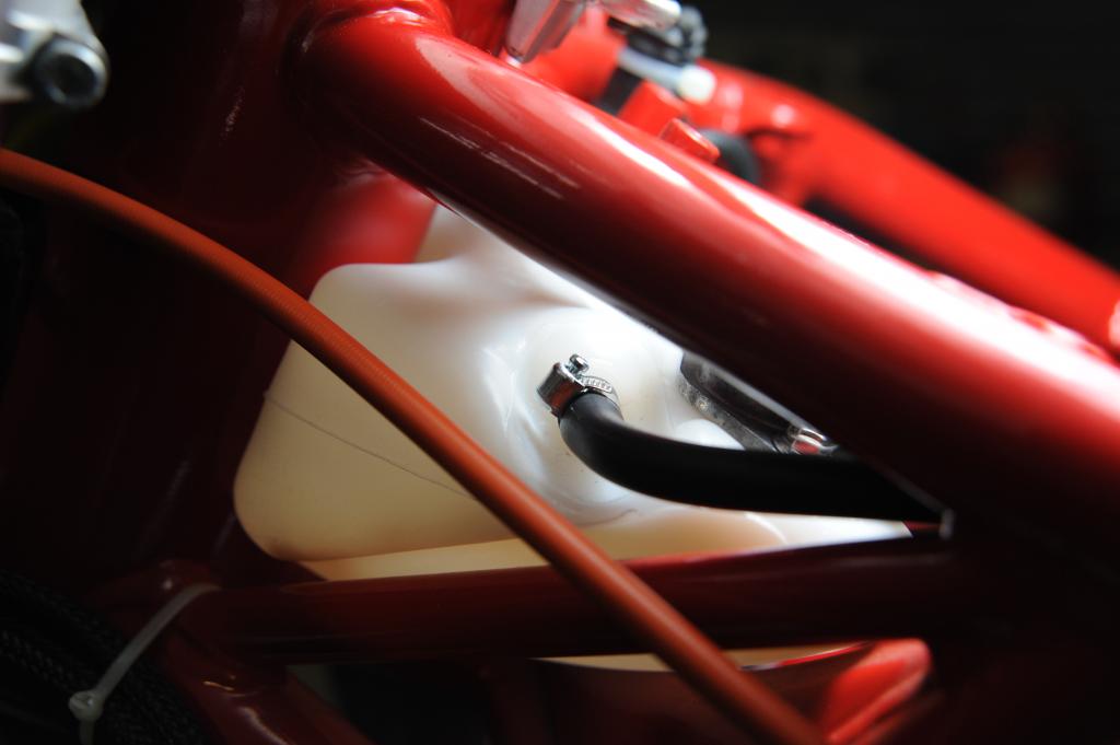

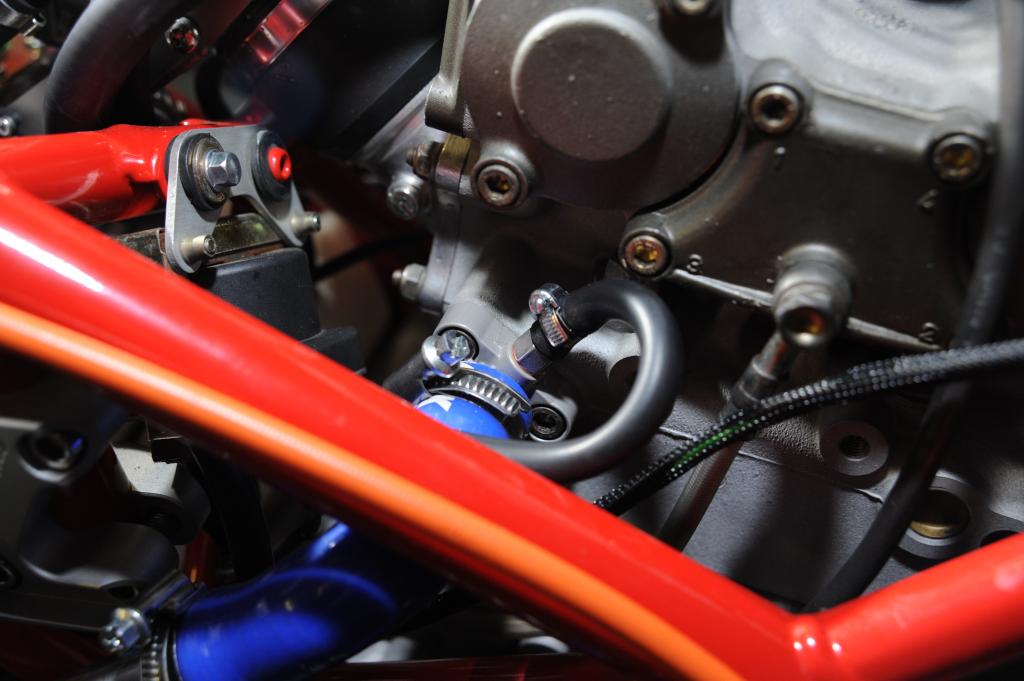

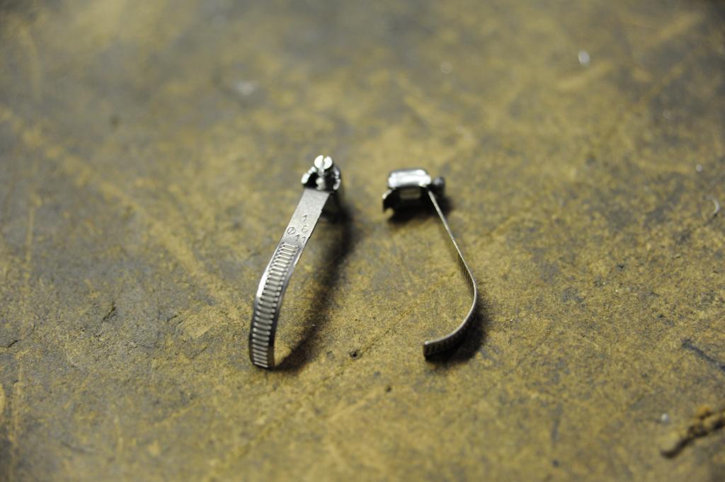

  8. Well, I have been back at work for two weeks, and had precisely half an hour spare to myself during that time. So today I have devoted the whole day to the bike. Its amazing how much time is spent just dotting the 'i's and crossing the 't's. When I got the bike running last, I used whatever hoses I had lying around for the water bleed and over flow, but now it has proper size rubber hose.

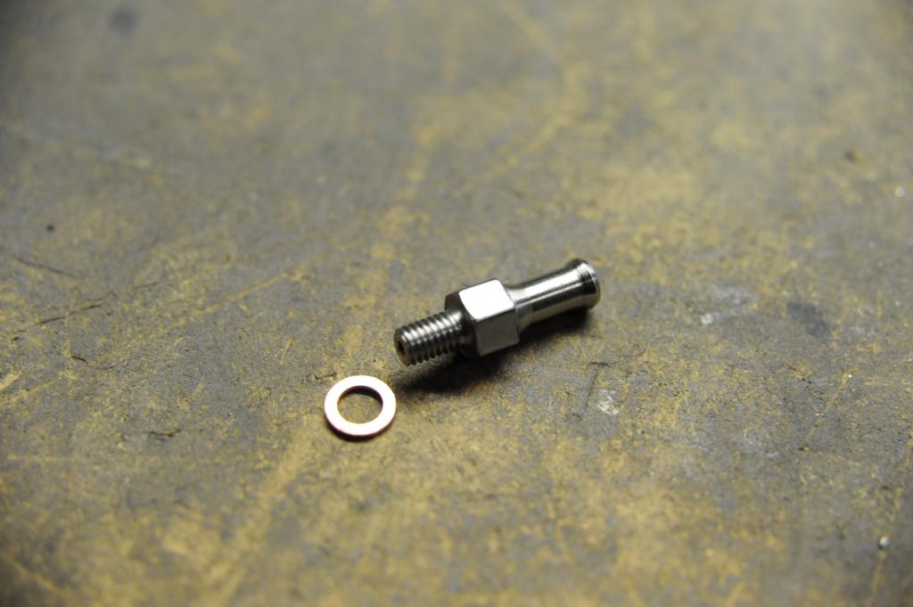

    The rear cylinder has a high point that bleeds to the header tank. I think it is a slightly different setup on a normal road bike, but this is what I am using. I made this little adapter this afternoon, from stainless 10mm hex:-
    And fitted. I guess a picture paints a thousand words:-
    These are the little clips that I'm using, very small and very tidy:-

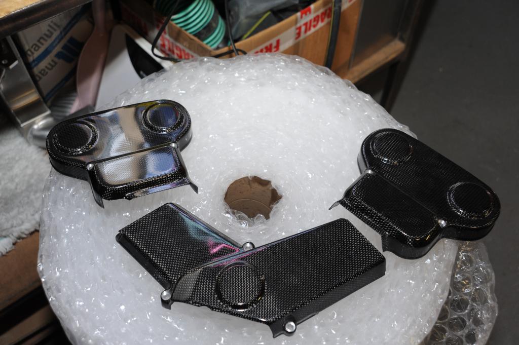

    In other news, I found these rather nice carbon cambelt covers on feebay. Purely bling, but they are fantastically light.

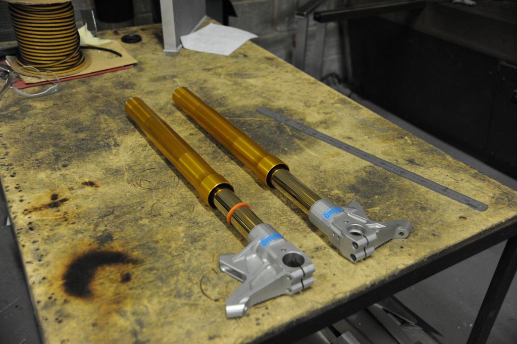

    The last few weeks have seen a little bit of a spending spree, possibly not on what I 'need' to be buying, but on what I 'want'. I have wanted to fit Ohlins forks forever, but rarely find any with 108mm feet. These turned up on ebay in europe a few weeks ago. A bit of negotiation with the seller saw them on their way here.

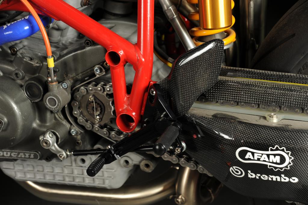

    Next to turn up was a set of rearsets. These are from 'bungibungi' on evil bay. They look just like the corsa ones from way back when, but with the added ability to run road shift pattern. Not enough mental capacity to safely learn race pattern at this stage...
    Ross and I took a trip over to jhp this morning, to drool over the stock, and to grab some spare parts. I needed the brake lever pivot bolt to get these fitted, and got some other bit n bobs while there.
    Still need a 56mm lower yoke and 1098 front axle to get the forks fitted. :)
