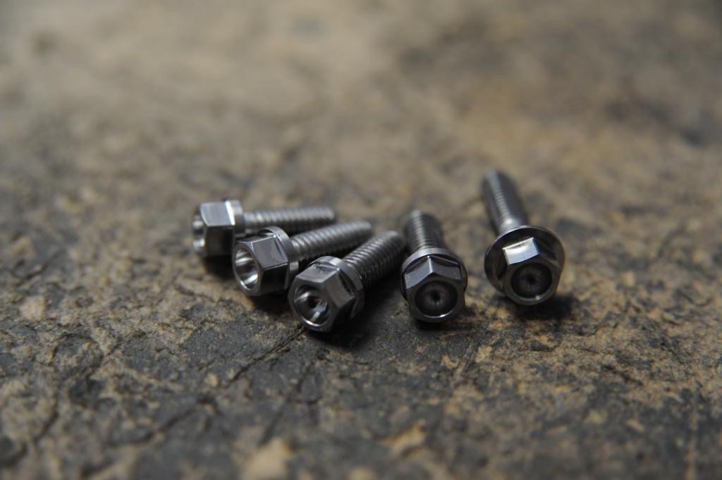

    Friday saw a visit to Probolt, I got a few bits for the duc, a few for my road bike and a few pieces for a mates gixxah. For the 748 I got a handful of m6 hex/flange bolts for the mudguard bracket on the forks. They have replaced socket cap heads, so I needed to turn them down a bit so they would fit in the small recess. You can see the subtle difference compared to a standard on on the rIght:-
    No pic of them fitted, you can hardly see them anyhow...

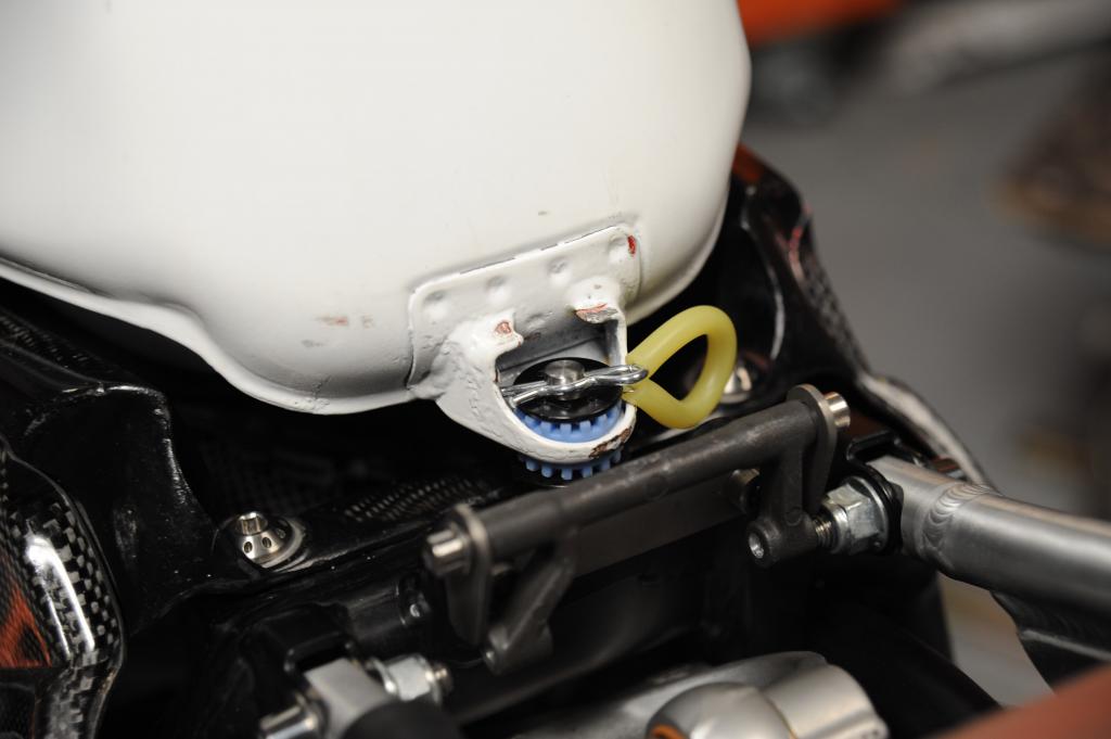

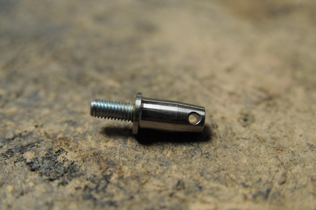

    Then yesterday I made up a little widget to lose the mounting bolt on the petrol tank. The bullet is made from titanium, naturally. [​IMG]
    And fitted:-

  3. ooooer nice piece if machining, if your ever bored and feel like making another tank pin I would buy one. :smile:
  4. I like that ... you can make me one as well ;)
    I keep meaning to order another rubber for the tank mount as I only have one between two tanks - one road, one trackday - but seeing your ingenious use of the exhaust mount rubber reminds me that I have a load of these kicking about so I can hopefully do the same :)
  5. Make me 2! :)

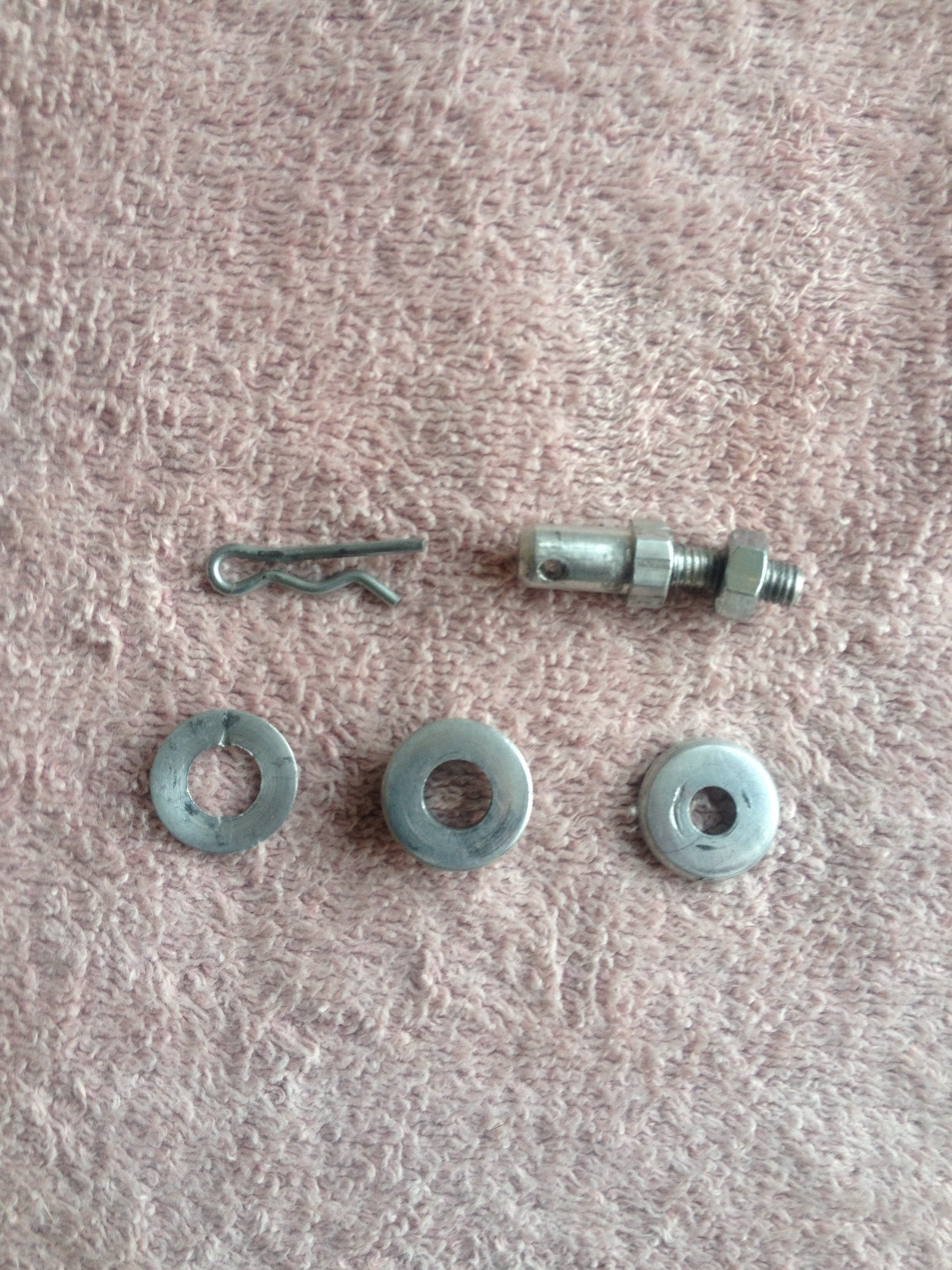

    I made this a few years back for my sons 748 Race bike as part of the preparation for the Maaxis challenge. The idea works well but if you crash, IMG_0461.JPG as he did!!! it puts a lot of sideways strain on the fitting. As you can see it bent although it still retained the tank in place.
  11. The one I have on my original tank is plain not castellated, or whatever you want to call it!
    I had a quick look through my "no idea what this is but I'm going to keep it because it may come in handy one day" box and found a grommet the same as yours in black. I know the same style is used on the exhaust can hangars but are blue, so maybe it is the right part and just a later version that is now used in loads of places rather than specific parts, and it helps keep the cost down.
    Any road up, it does the job ;)
  12. The original tank rubber is a grommet which has different sized flanges on it, a top hat washer goes through the centre of it with the washer side at the bottom. A large head allen bolt which is shouldered goes through the tank washer\rubber and provides the rear fixing. The setup allows a degree of movement with some degree of insulation from vibration.
    The washer allows the bolt shoulder to bottom out but still allow the tank to flex at the joint slightly and i guess this is to help prevent vibration causing the fuel to "foam" and slosh.
  13. Yes, that's the setup that I have, but only have one grommet with shouldered washer, and I'm too tight to buy another so swap them over when I swap between road (pretty) and track (scraped) tanks ;)
  14. I know what you mean!, I used one that was split for a long time, not sure why, but I never seemed to remember to order another one when I was buying parts, they are not expensive so I don't have an excuse.
    Having recently started work on rebuilding a Suzuki RGV 250 track bike for someone I am now more of the opinion that Ducati parts are almost reasonably priced compared to the insane prices that Suzuki charge for this model.
  15. Hmmm, I wonder why you have made the pin so tall? Surely the tank would sit too high on the bike? Its no wonder it bent, theres not enough support in shear.

  20. It was an experiment originally and the thread is quite long but the tank sat very tightly on the top fitting. However the crash pulled the thread up and out of it's mounting. I did notice more rocking when I made the pin, at first, but that may have been down to a worn grommet,they tend to split and rip with age and I think this one had seen better times. There may just have been enough movement when it went up the road, the tank stayed on though.
    Possibly a stronger piece of material was the answer regarding the pin.
