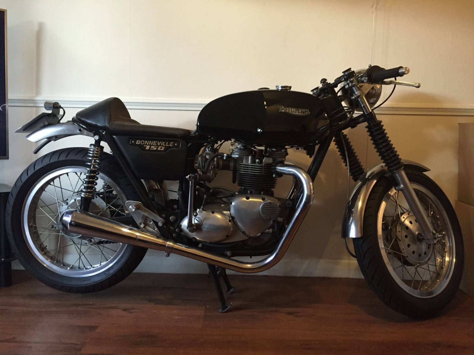

  1. My wood floor in my lounge has taken a proper beating over the last few years but my lounge is much warmer,crapper is 5 steps away and beer fridge is reachable when working on a bike without having to get up? Neighbours complain when I fire a bike up but as I've always said "fuck the neighbours" IMG_1861.JPG

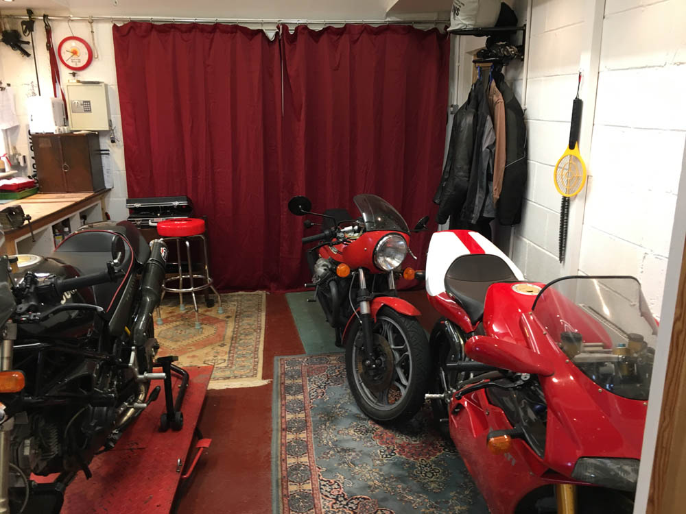

  2. I'm thinking this way too. My floor is painted but it chips & scratches easily so I have rugs under the high wear areas.

  6. I did it,it worked very well,then I carpeted that area,so long term I can't say! Carpets great,warm comfy and you feel ok when you get thrown out of the house for causing unrest (deliberate ) I've a fridge cooker and a dish washer in my garage,the dish washer is great for cleaning engine bits,cooker for baking paint, fridge?beer! Bearings prior to fitting,fresh rabbits!and a 90,s top of the range hi,fi! With remote for sound!neighbours?hes a biker to so life's good!

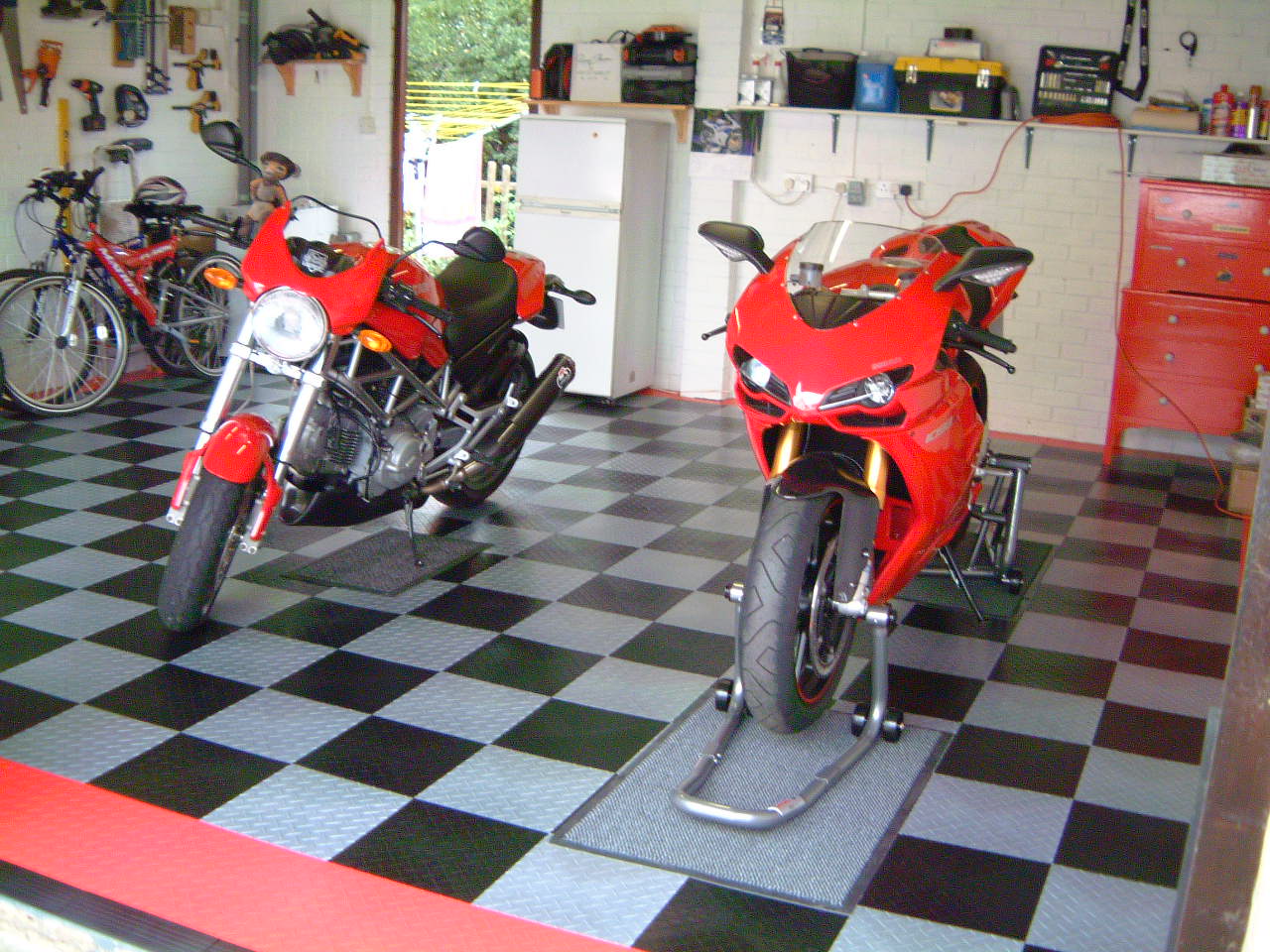

  9. Race Deck flooring. Eight years in and it still looks as good as the day I fitted it. This picture is fairly old but the floor tiles have not changed a jot.

  13. I notice you've a non-slip mat under each side-stand or paddock stand.
    Is that because the tiles mark easily, or to stop the stands sliding on the tiles?
    Do the bare tiles recover, dent wise, from a side-stand quickly or at all?
    Sorry for the questions, but I'm interested in them for my workshop.
    I also work on my 2.7Tn Land Rover Discovery 3 in the same workshop using stands and a BIG Trolley jack, so I'm wondering how they would stand half that weight spread over 4 small wheel contact points or axle stand feet.
