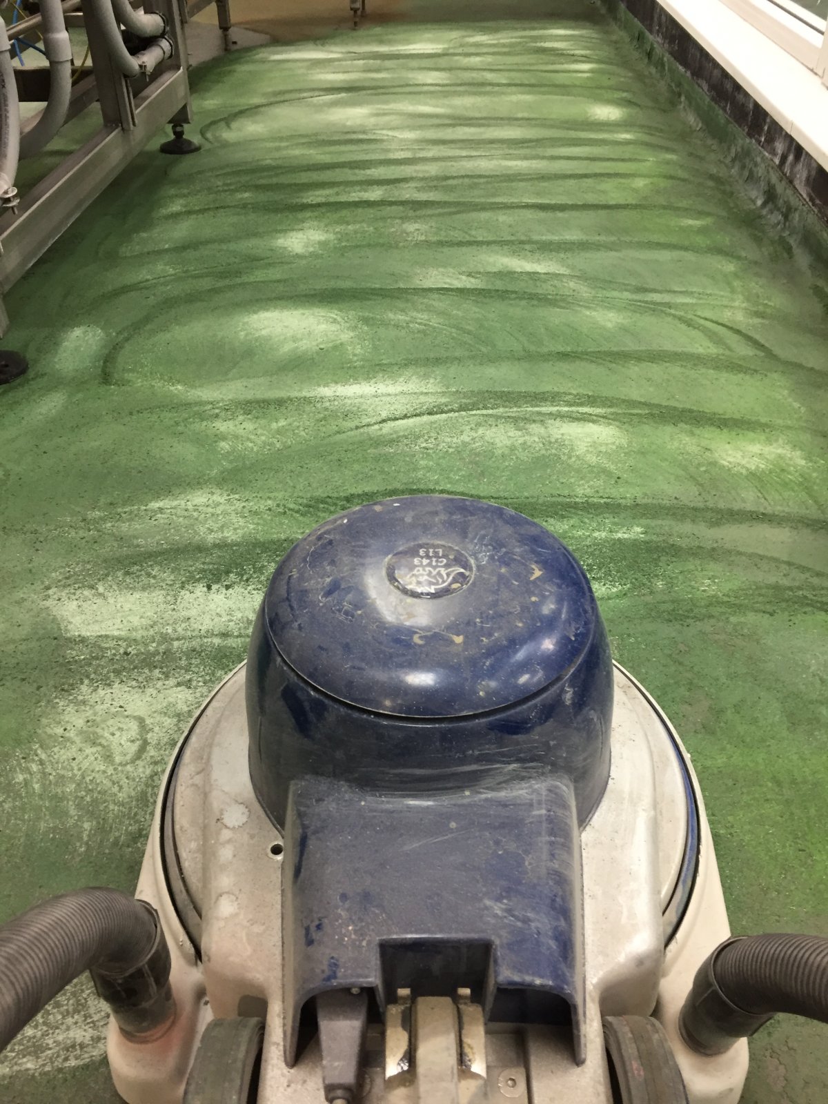

  4. As has been said already, a concrete floor has to have the laitence and any other coatings ground off first. Sorry guys, but PVA isn't a permanent or long term solution if you want a long term system. Acid etching is rarely used in the industry now with environmental concerns and the fact that you'd have to wash it off the floor, which means you then have to wait for it to dry. Moisture content should be under 6% and the temperature for the duration of cure and post cure should be above 5 degrees and ideally above ten. IMG_1488.JPG
    Depending on your budget, a two or three coats full solids two pack epoxy system is the best.
    Remmers, Sika, Resdev all do versions.
    A water based epoxy will be ok, but remember will only leave around 60% of the wet film thickness as the rest just evaporates off.

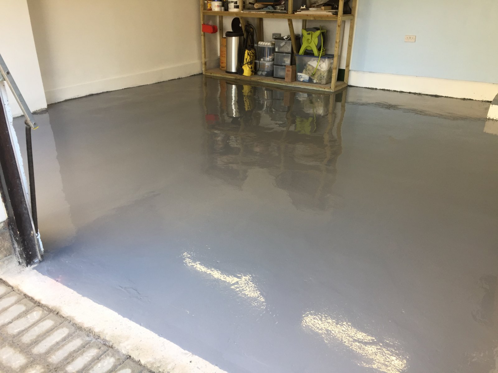

    If I was doing my own, I'd go nuts and put a resin screed or sandwich system down that looks much better and will last twice as long. IMG_0708.JPG

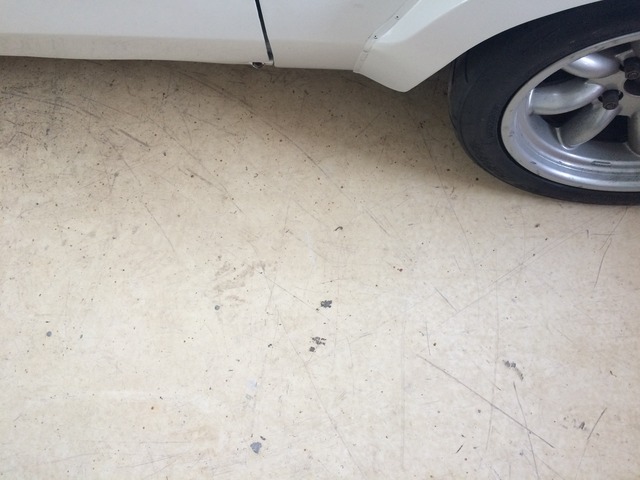

  10. who supplies the resin coat stuff,bluehawk,as this is what my gloss white epoxy looks like after 3 years,did start off looking like the pic above but doesnt wear well in a garage
    i now think ceramic tiles is the only long trem solution

  15. Remmers and Sika are two good German suppliers, personally I'd steer clear of white unless you're prepared to coat it every couple of years. Most epoxies aren't UV stable and will tend to yellow unless you want to apply UV stable seal coats. What you have there is a bit of abrasion which will always show on the light colours.
