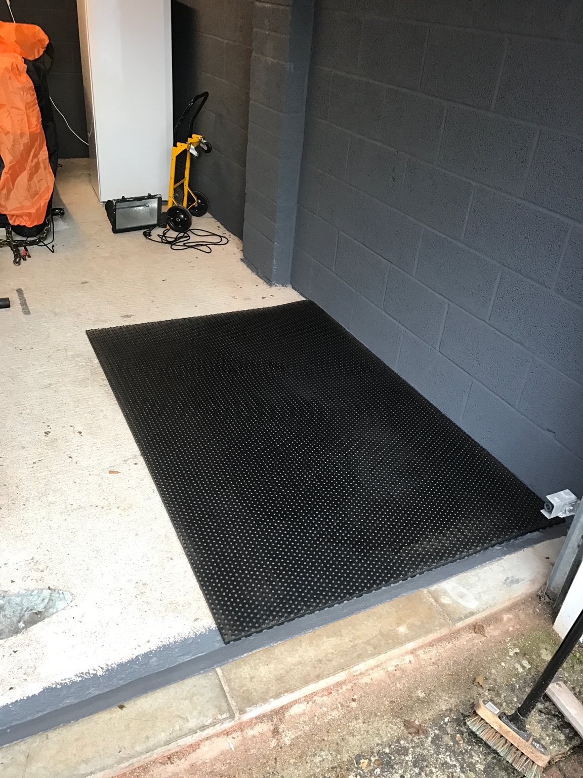

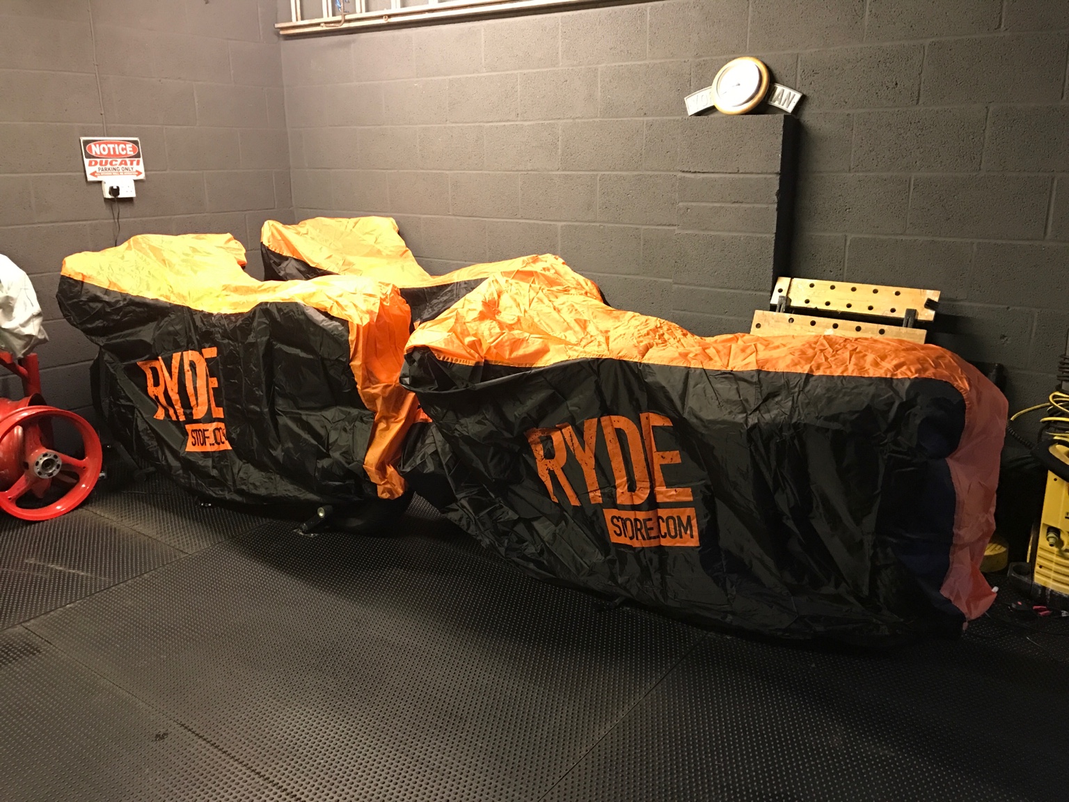

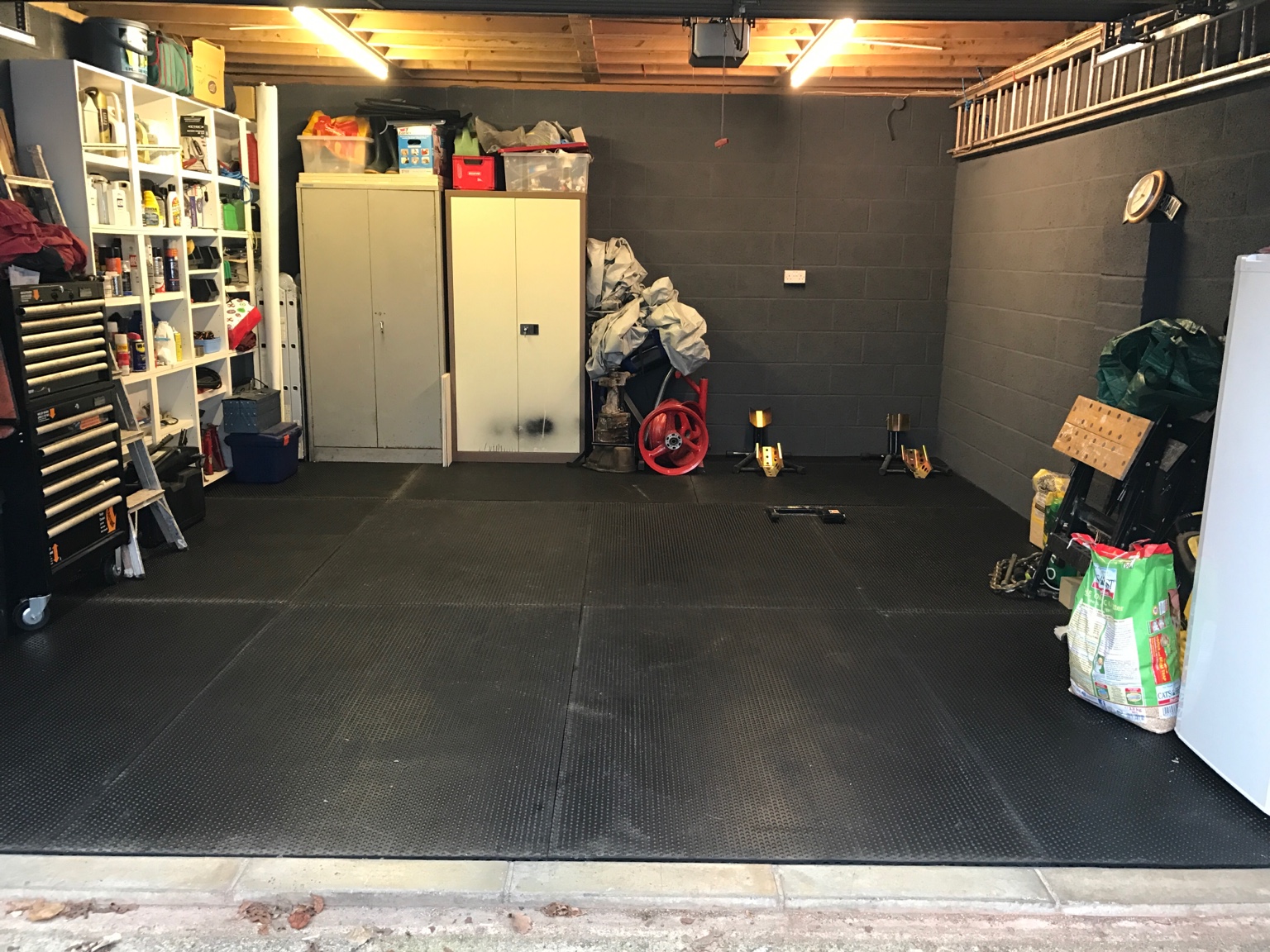

  3. Ive just finished this today.
    After getting a few samples of garage floor tiles and quotes etc I decided on a quirky solution.
    6x4 rubber stable mats available from your local country store. £34.80 each so cheaper and far thicker and robust than garage tiles.
    I'm really pleased with the results.
    First one down.

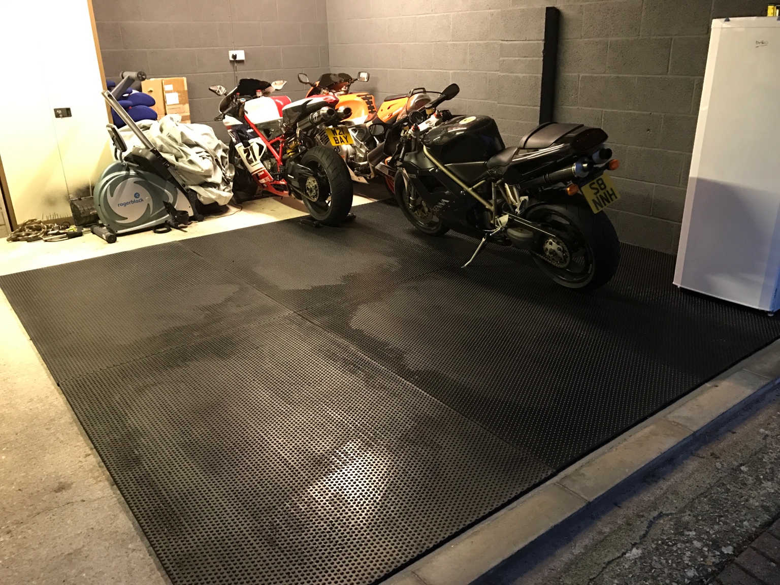

    First six down after being cut around ground anchor and wall support.

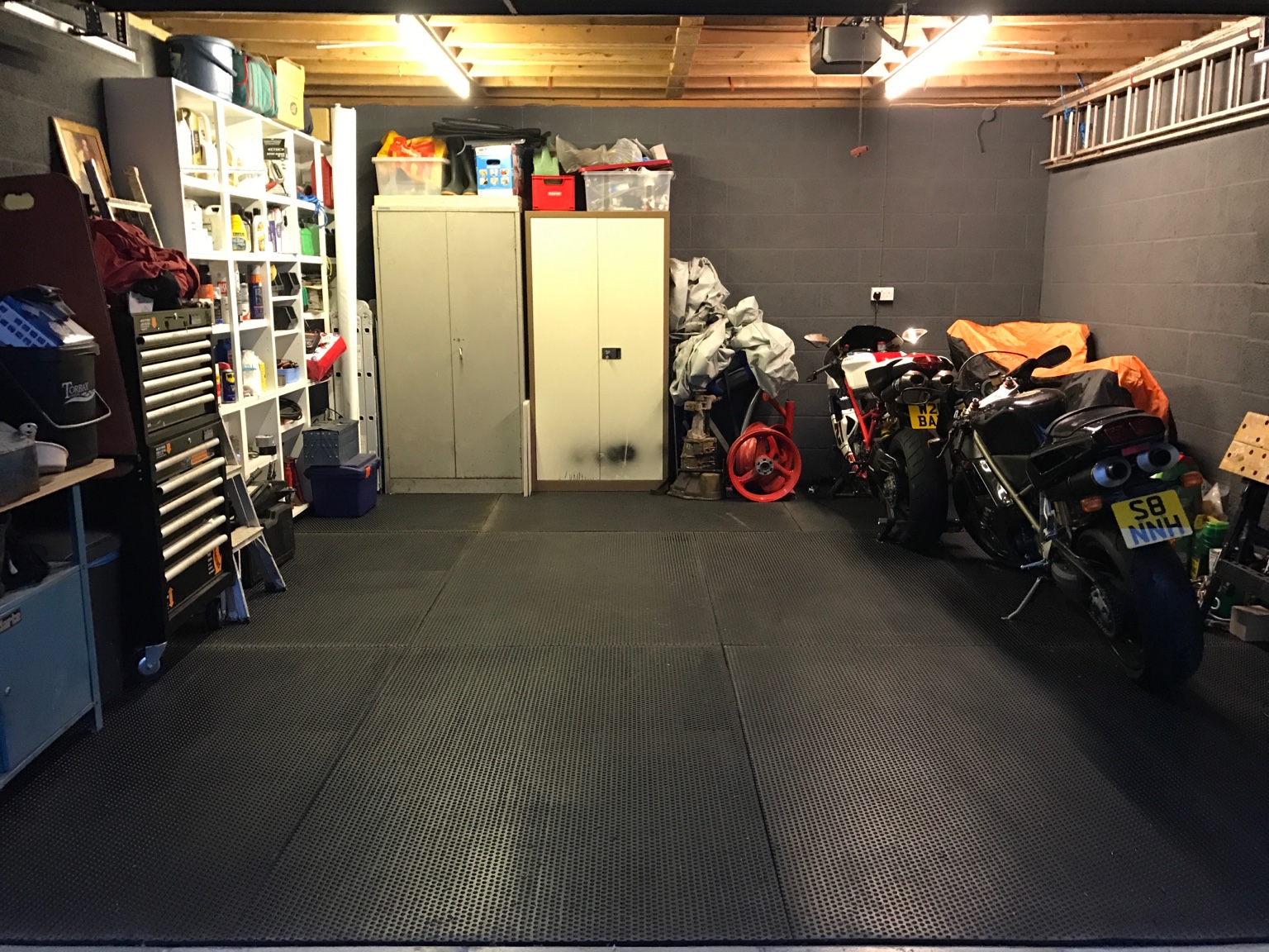

    All done with minimal cutting.
    Bikes back in.

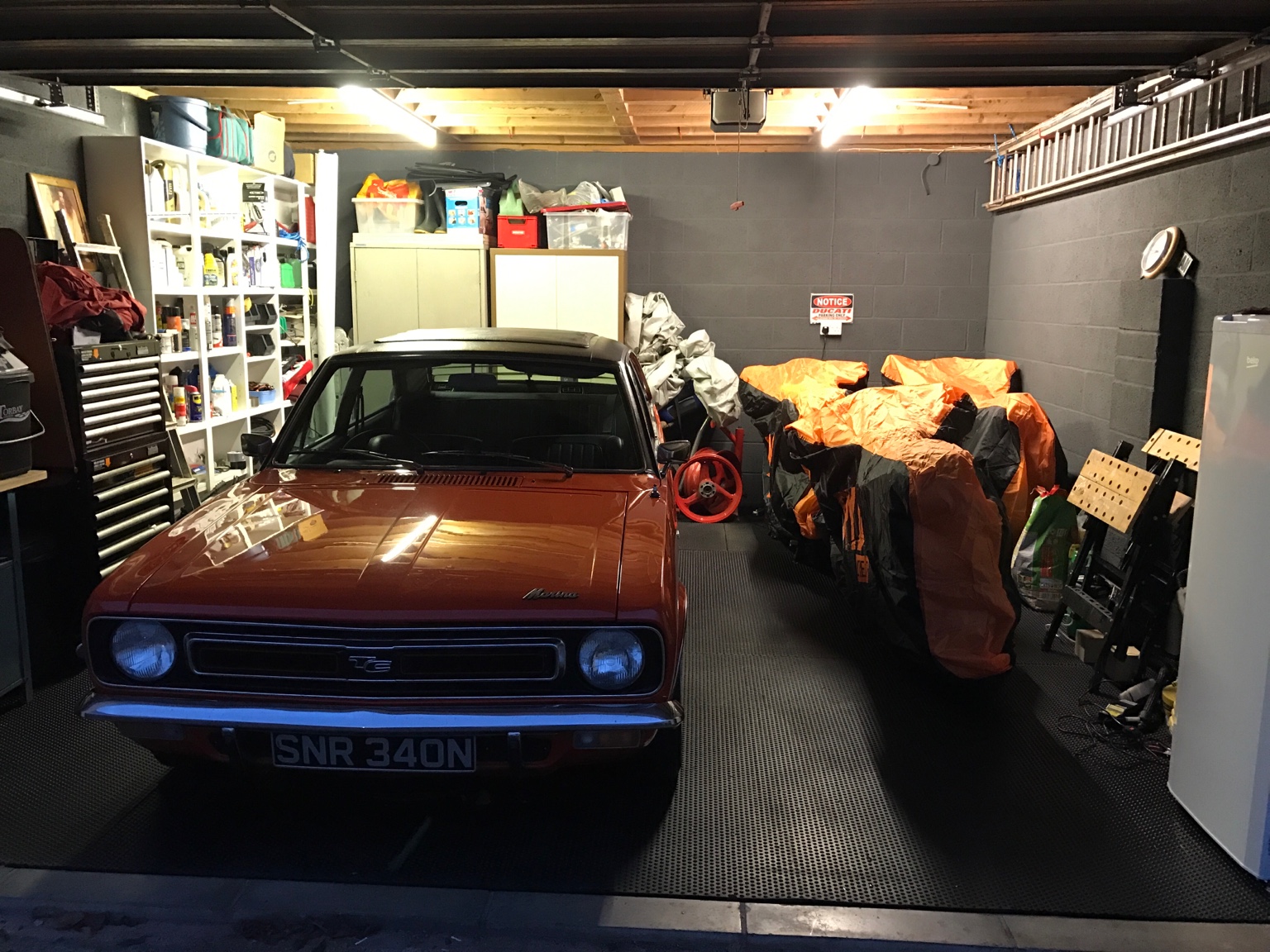

    Covered with new covers got for Xmas
    And finally all done.
  4. so it doesn't do exactly what it says on the tin then.

  5. Wow a TC Marina..... well I never
  7. Belongs to a mate of mine. Been off the road for awhile though.
    Sent from my iPad using Tapatalk

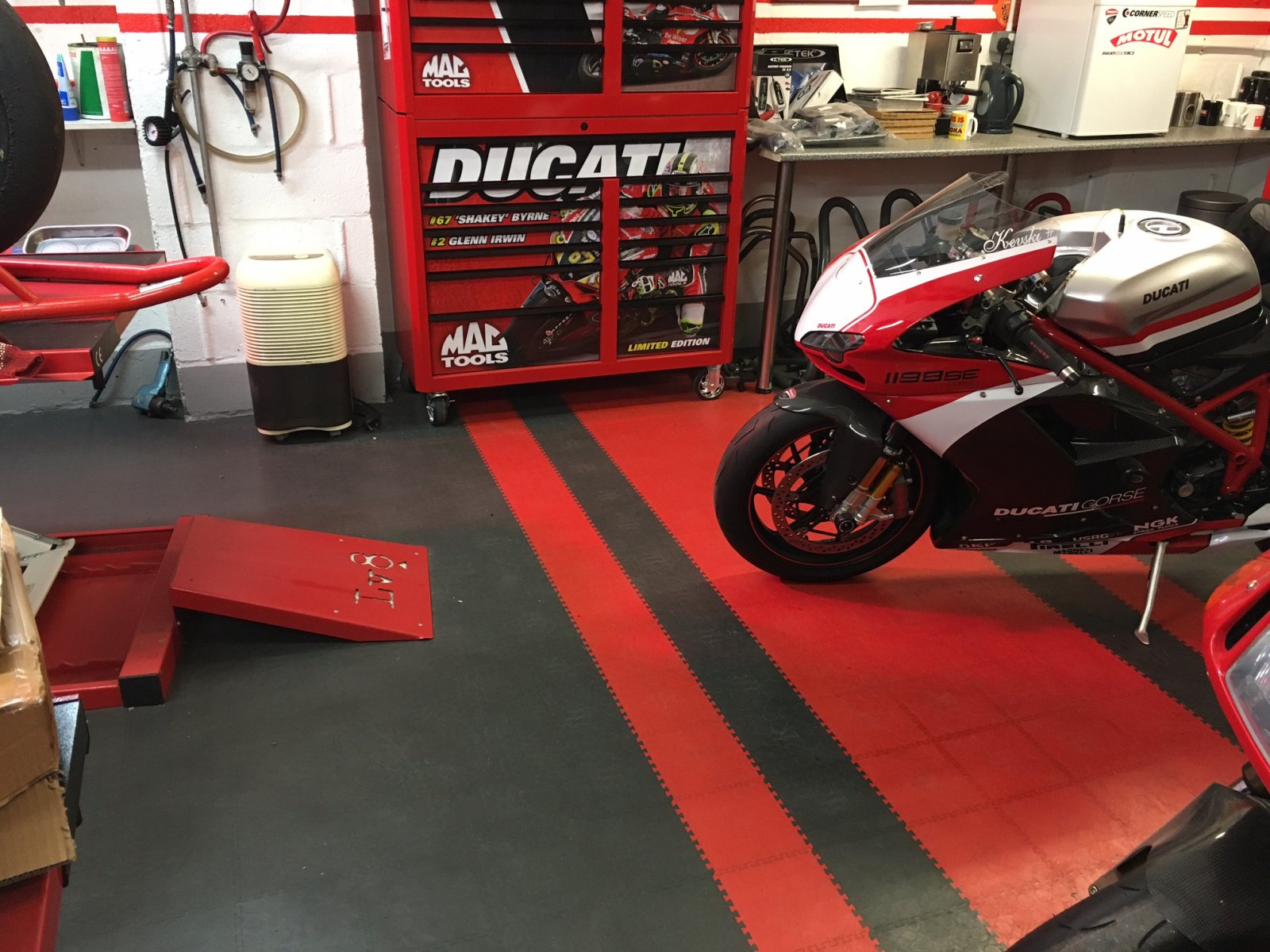

  11. It's really good stuff.. This is what we've done. This has done 12 months of daily, hard use and all it needs is a wipe over with the mop every couple of weeks.
  12. What dies the flor need to gd like? Billiard table smooth or can you get away with a few bumps?
  13. Just give it a good sweep. Knock any nibs off and lay the tiles. Because they are thin, bits of gravel need to be avoided as they cause small bumps but you can lift the tile and shift them if you miss any.
    I laid it over the old floor, paint and all. No adhesive as the tiles are heavy. Just leave 10-15mm gap around the edges to allow for expansion, more so if you lay it when the ambient is high. I have a lot of stuff sat mid floor and it's a fair old space so occasionally if we have the shutters up and get direct sun on it, it does sometimes expand and lift a little. As it's really heavy, it soon settles and becomes less prone.
    Beauty is to, that it can be lifted and moved around. I've just shuffled the workshop around and installed another lift. Took minutes to rearrange as I sit the lifts directly on the concrete. The tiles are 25 to a square meter so even small changes can be made easily as the tiles are smaller.

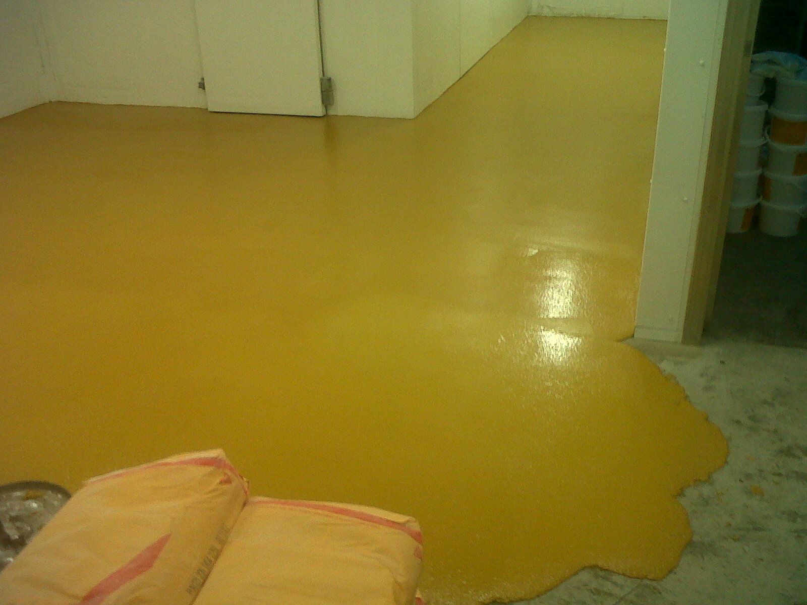

  14. It may seem an expensive option but has anyone considered a resinHas anyone tried the resin floor, the one that looks like tarmac but is far more resiliant and can be coloured?
    Like this?
    A 6mm PU Screed is fairly prohibitive as far as cost goes. If you don't want to touch it again, its the way to go, but expect at least £60-70sqm costs...
  16. I like the colour scheme. This would suit me quite well, so I'm getting tempted. And thanks for the link.
  17. Looks like someone has spilt custard
  18. Never thought of it like that. The food industry have some weird and wonderful ideas...
