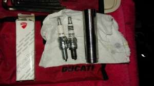

  13. Impact socket. Mate with a lathe. Sorted. See pic

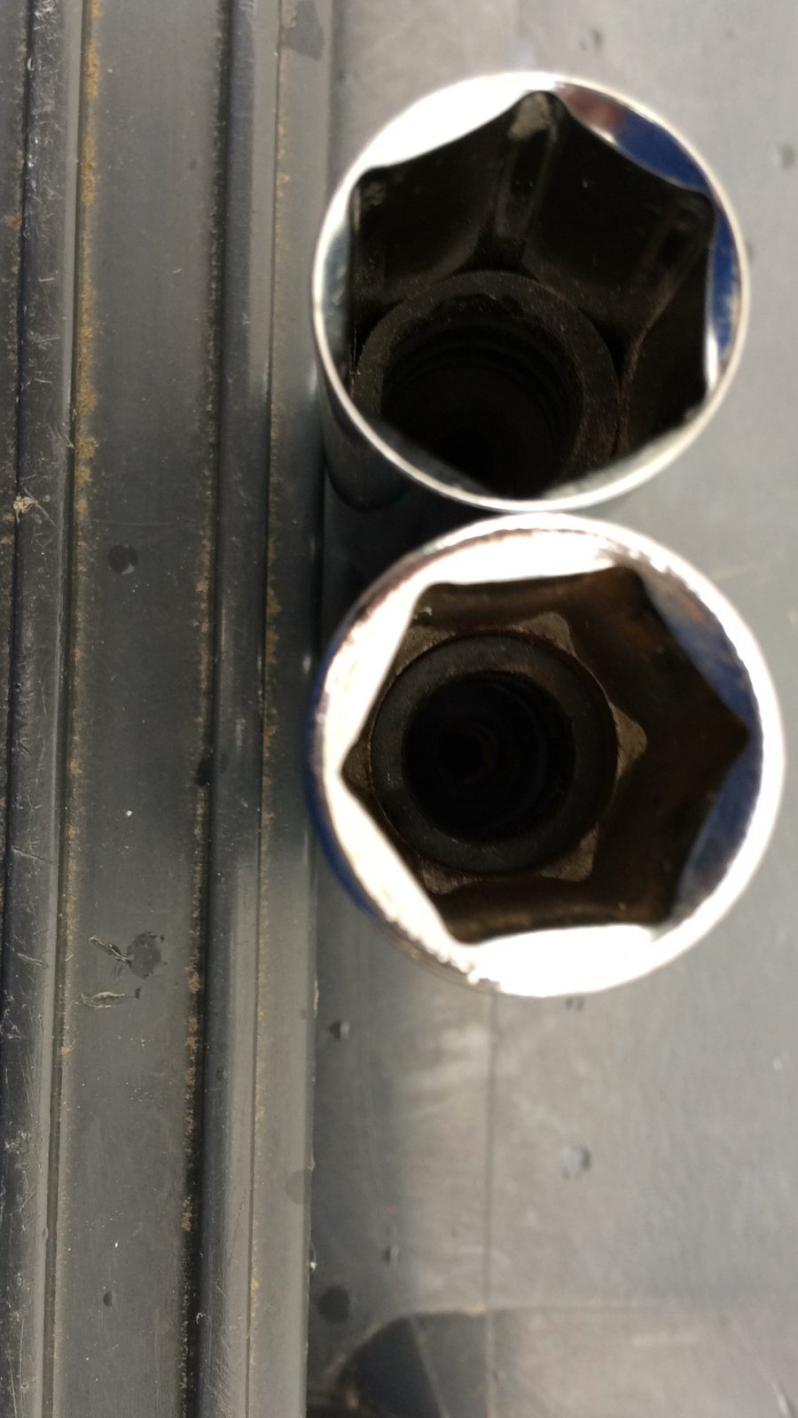

    Herewith side by side pic of Halfords Professional plug socket and the Sealey

  16. So what stops the Halfords one going down the hole - as mine does. Am I just good at getting big things in small holes? :innocent:
  17. The hole is tapered.
    The Halfords one is fine if you have Champion plugs but other plugs have the hex flats further down the plug body towards the electrodes than Champions.
    This means the socket fouls the taper and can't reach the flats properly

  18. Both mine must have Champion plugs then :)
  19. If a Halfords Professional plug socket reaches, then yes.
