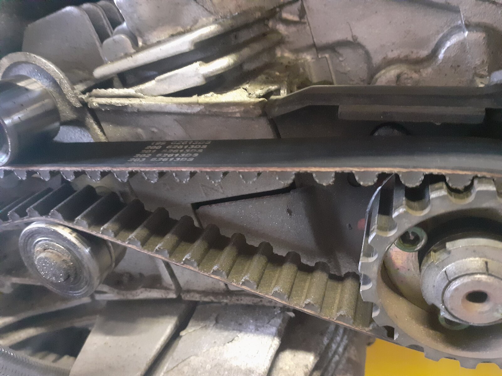

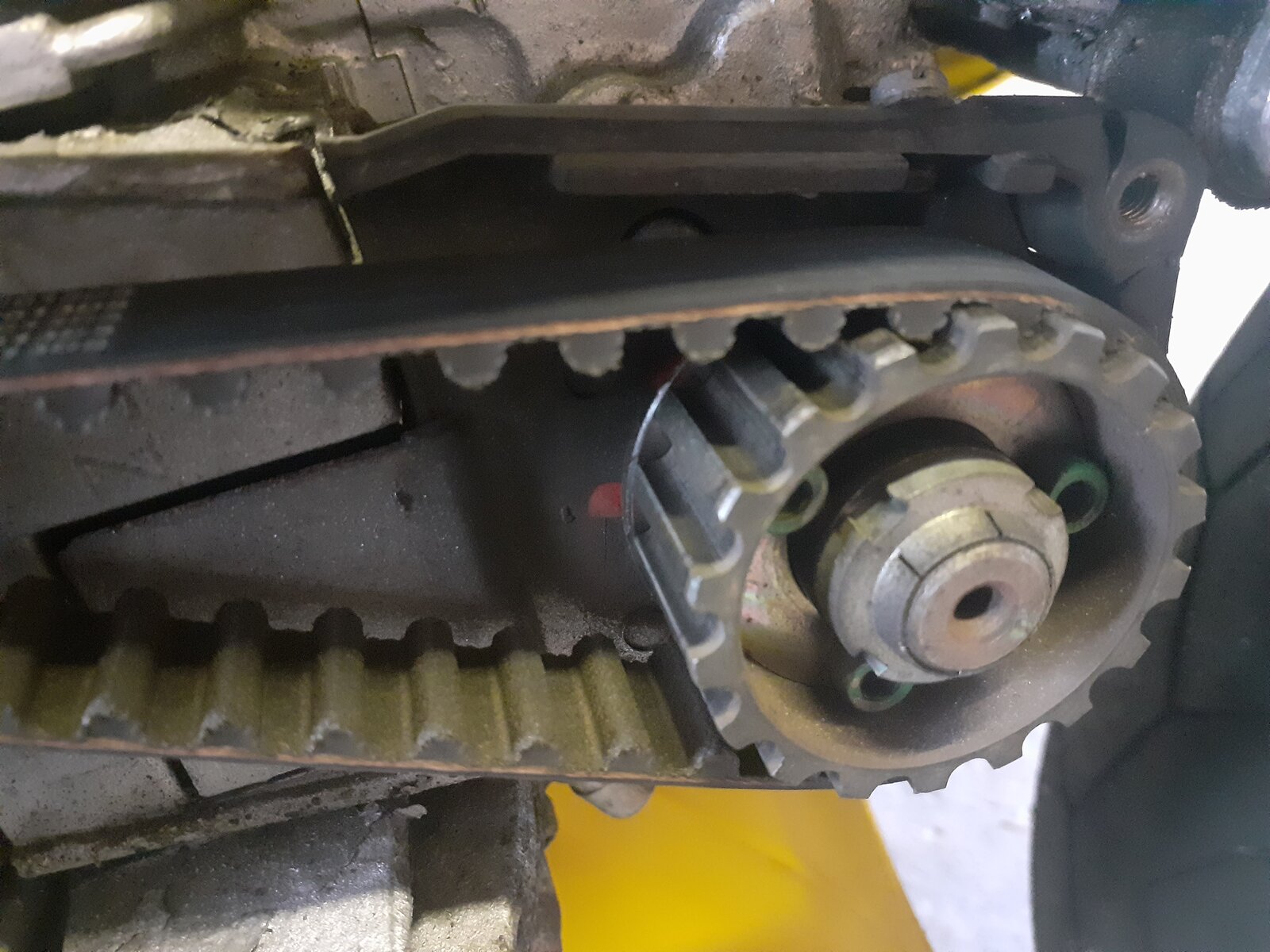

  17. Belts inspection today revealed that the belts are from 2003 or possibly 2004. They are like new however I have ordered up new belts from Ducati, not a bad price just over 80 quid delivered..and good for 5 years...good stuff...engine is in time and just awaiting the belts ..anybody doing this job, it's a piece of cake, there is nothing to it...
