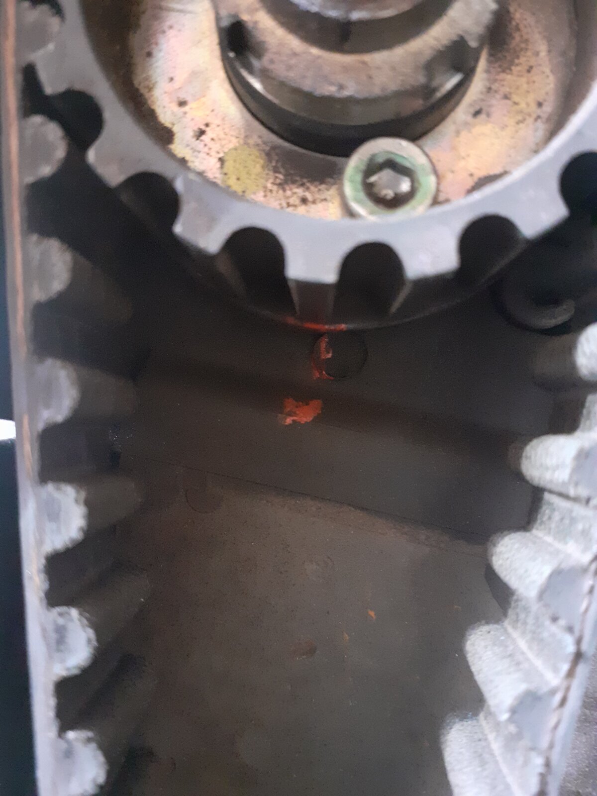

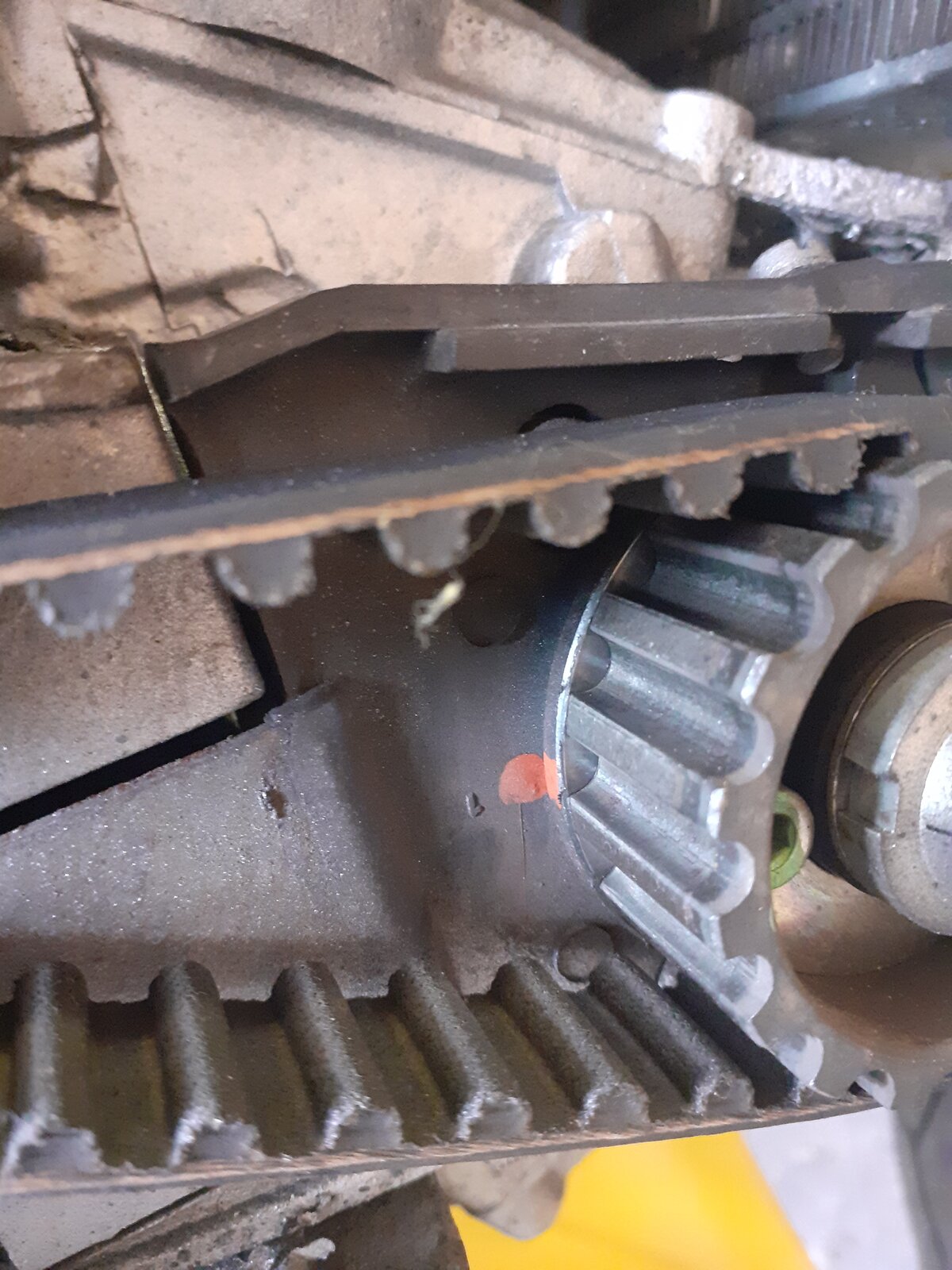

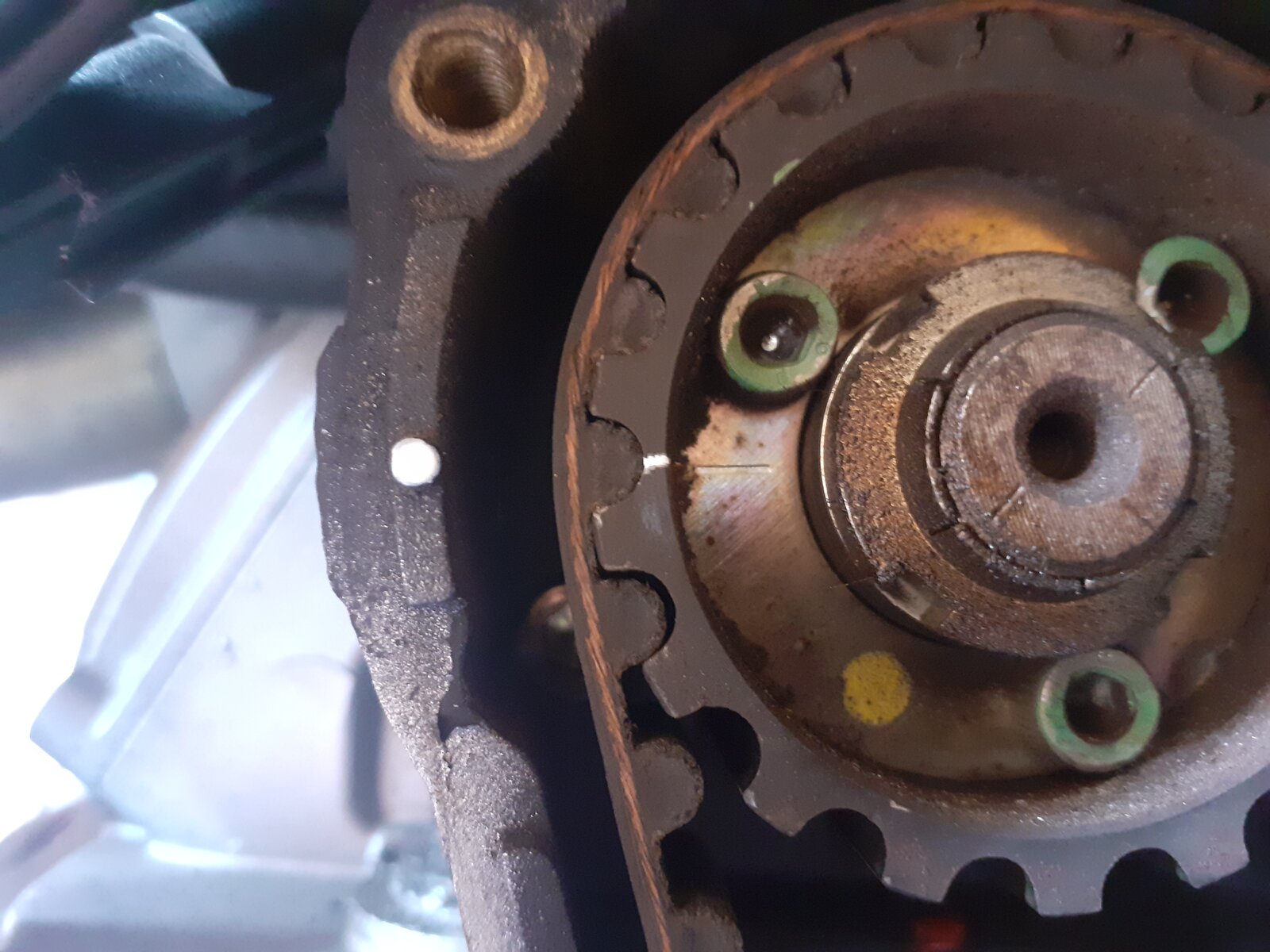

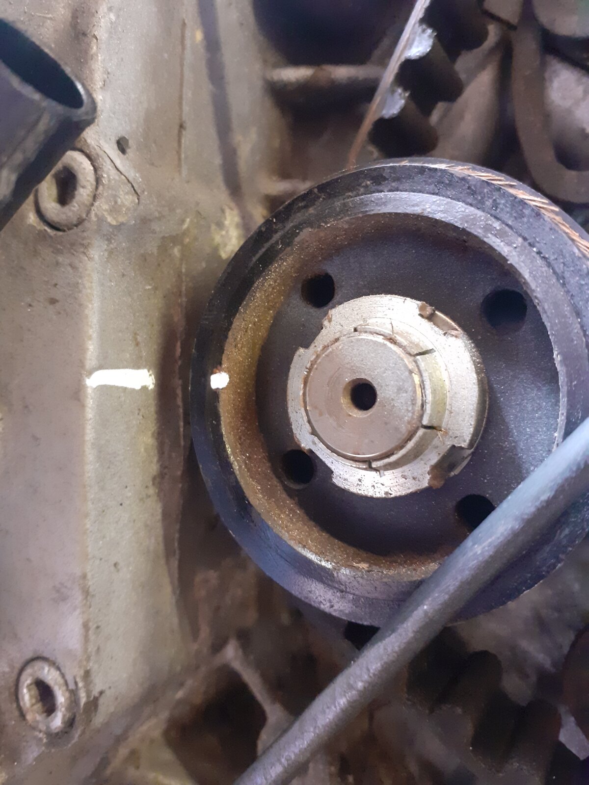

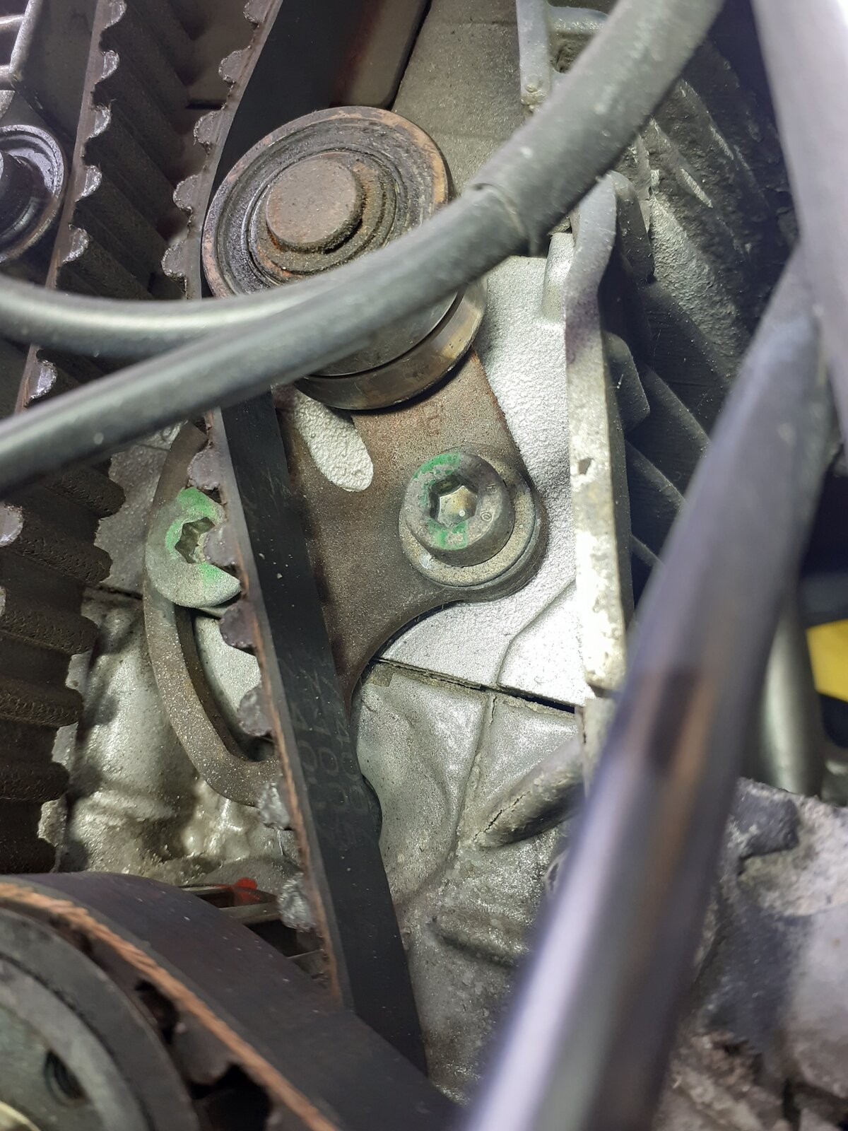

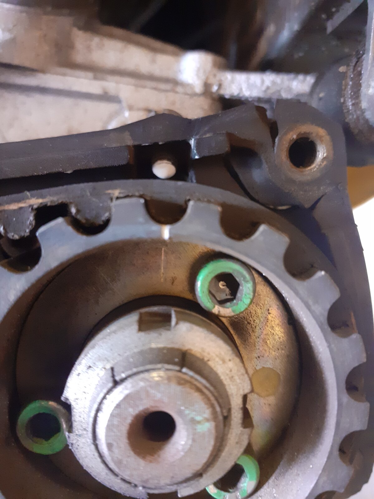

  8. Belts done today, no problems at all, the previous owner had them changed some years ago, there were some odd red paint tining Mark's in completely the wrong place, although the timing wasn't much out, probably about 5mm previously, I can say since I used the proper timing Mark's the bike runs so much better, it idle,s better as well, enclosed a few pics, the white timing Mark's are mine and the red blobs are somone else..

  10. Hi Wayne, yeah it was ok, no problems, actually if anyone wants to do this job I could probably talk them through it if they get stuck, I dont mind doing that if it helps somone out...obviously the 2 biggest things are, get the timing absolutely spot on and belt tension correct and if you want to do it as good as a Ducati tech torque the tensioners to 27NM. Bike runs good far better now, do t really understand the red blobs, it worked, but it wasn't correct, ...today I also replaced a rubber rear brake hose for a braided stainless one on a BMW K1200, bled the rear brake,...all ok...the old rubber one bulged when you put your foot on the rear brake pedal, never seen that before...hehe..reckon I might of caught it in the nick of time...
  11. I know this is a bit late but check your tensioner bearings, there is the tensioner bearings and a fixed bearing the tensioner is on the right of the last picture above and the fixed is on the left, nothing to panic about yet but my 900ss ie has done over 50,000 miles and i replaced all mine ages ago but worth checking in the long run.:upyeah:
  12. Hi mate, yeah they were ok, smooth rotation, no play...its got 18k on the clock...oil and filter tomorrow and that's it apart from tyres and maybe a set of rear pads, it should be a pretty well sorted bike, thing is I probably wont use it much, it's been like a project for me.
