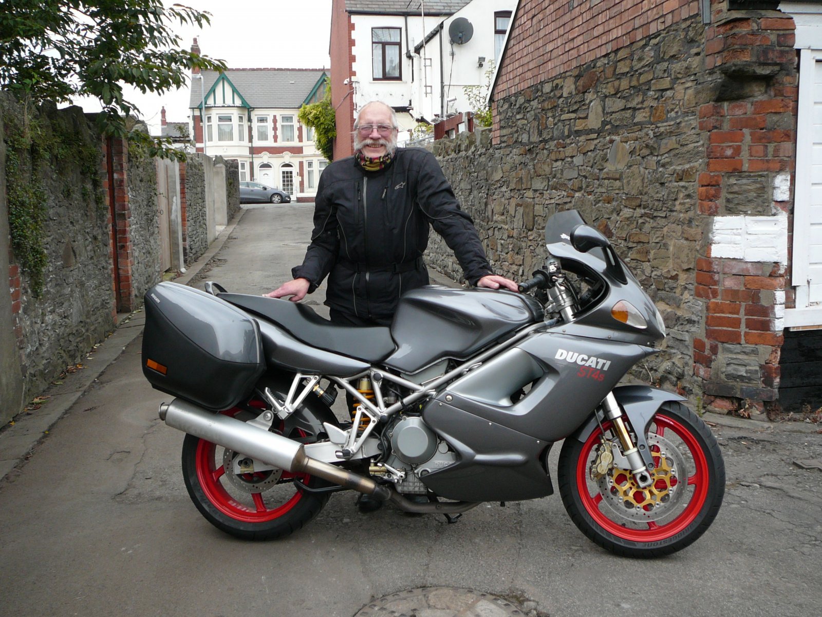

  1. Grey with red wheels. Never took a photo ....doh!
  2. Nice... I like the red wheels - I have them on my blue ST4...

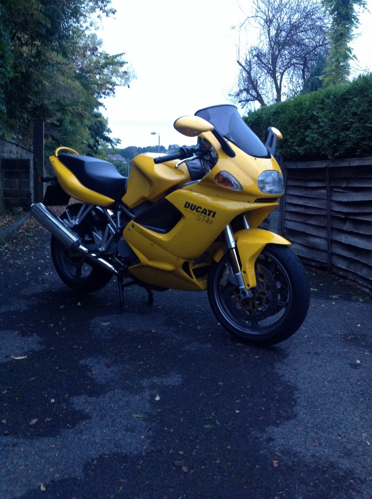

  12. Just back from a 250 mile run up to Kielder. Had a great time dodging the gravel and mud on the road. Bike never missed a beat.
  13. That's nice .... I like the yellow, reminds me of my late lamented 748sps.?
    Has it occured to anyone else that Ducati buy up surplus Ferrari paint? The colour choices are very similar.
    What are those silencers? And are they any lighter than the stock ones?
  14. Exhausts are Remus. Probably about half the weight of the originals and nice sound without being too loud ( still sets off the car alarm if I'm too close when I start it though ! ).
