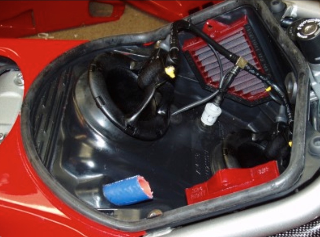

  1. The BMC filters shown in bootsam post above is a good design starting point. They slide up and out of a frame for cleaning.

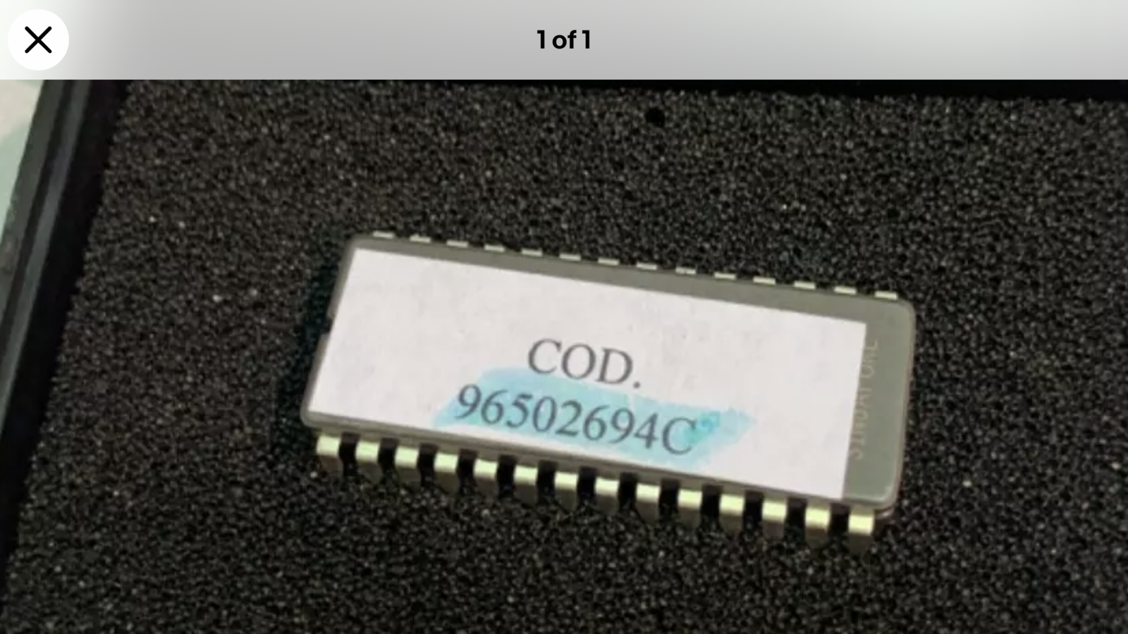

  2. BD1B3543-A9E1-4AC9-BDF2-ECB451234D33.jpeg The chip I got from Desmo Times ended being their own reflashed unit not an actual DP chip.
    Edit: The bad chip came from Desmo Market in Tombolo Italy.
    Wouldn’t even make the bike run. Key “on” gives a spastic fuel pump. I’m done with those guys!
    Who should I contact for a proper unit?

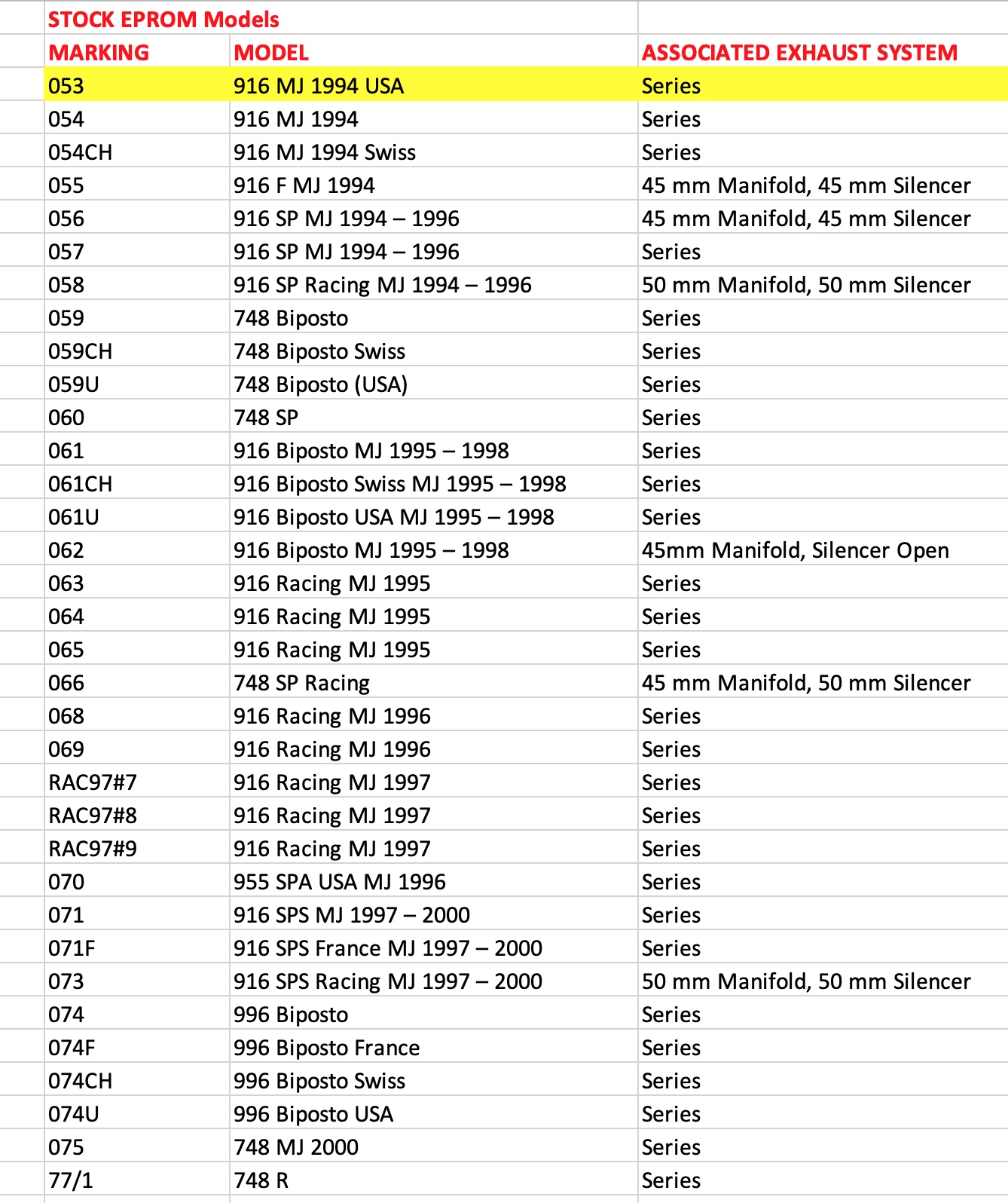

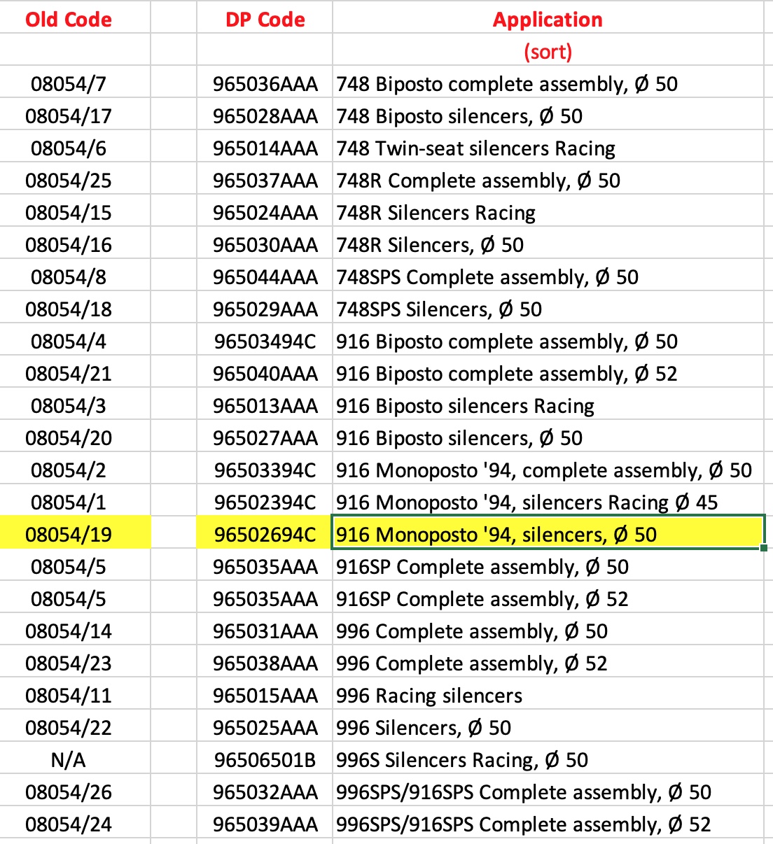

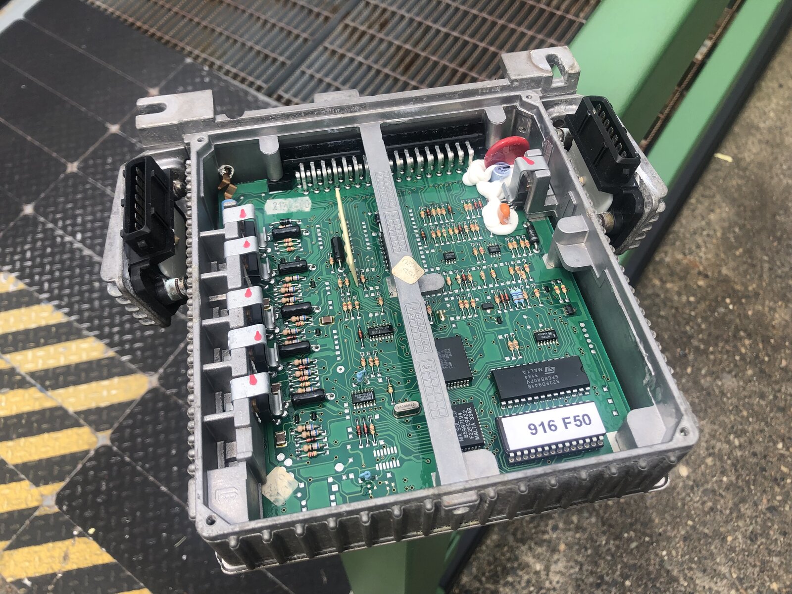

  4. The EPROM marked 053 is the stock USA 916 chip.

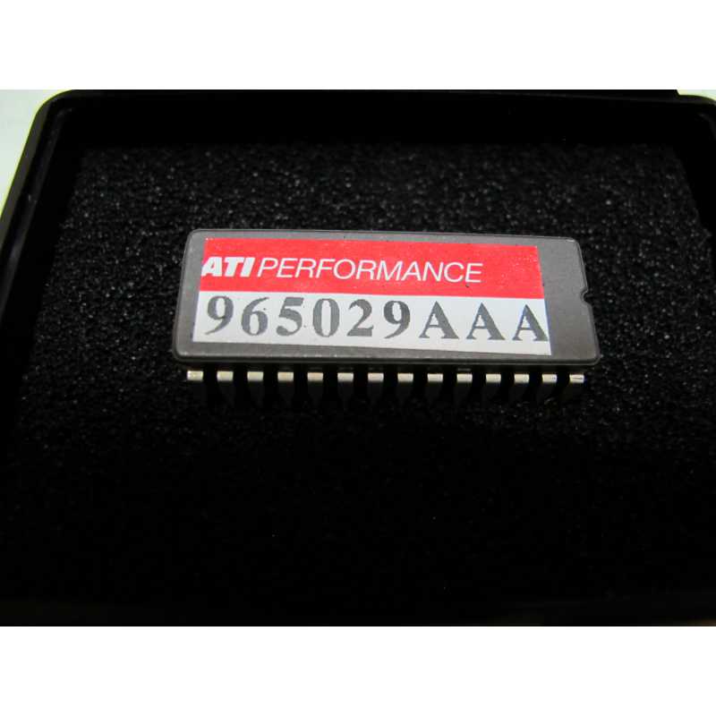

    You need to look for the Ducati Performance EPROM
    This does not look like a « genuine » (OEM/NOS?) Ducati or Ducati Performance chip to me. More like a copy of said map on a generic eprom.
    In my experience, « genuine » chips look like this:
    #29 Guillaume69, Jun 2, 2022

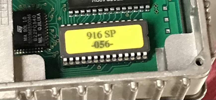

  8. Yep, the photo above is from my SP3 too.

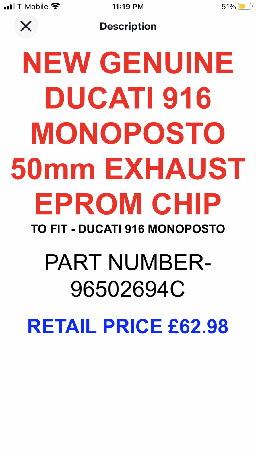

    The last one from Desmo Market the eBay ad had pictures of an oem chip but a generic chip showed up. And was total shite.
    This is a correction to before. The bad chip is from Desmo Market in Tombolo Italy. Not Desmo Times. Sorry for the confusion!
    This time around we’ve got pictures of a generic chip but an ad that clearly states it is a “new genuine” Ducati eprom chip. So I was hoping for better results.
    https://www.ebay.com/itm/2846869606...lDpFo9lRF-&var=&widget_ver=artemis&media=COPY
    The seller is HGB Motorcycles in West London. Perhaps I’ll have a better experience this time?
    https://www.hgbmotorcycles.co.uk/
  10. I must admit your negative feedback about Desmo Times and LT Snyder was very surprising. This guy has a pretty solid Ducati knowledge and speaks his mind quite openly about things (motorcycle related or else) he dislikes. He is definitely one of my go to businesses whenever I have an opportunity to have things shipped from the US.
    Again, may be this is a language thing, but doesn’t « genuine » mean « authentic », as in OEM? Because this UK eBay ad and the picture are in contradiction, in my humble opinion. The chip on the pic does not look like a « genuine » Ducati or Ducati Performance chip. Not that it matters at all in terms of what it’ll do for your bike, as the software is probably « genuine », but if you’re looking for OEM and pay accordingly (£60-ish!), then I would double check with the seller.

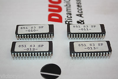

    Here’s an example of what could be « genuine ». And for a much better price, at that.
    https://www.ebay.fr/itm/275029771393?hash=item40090d4481:g:EsMAAOSwVaNhebsO

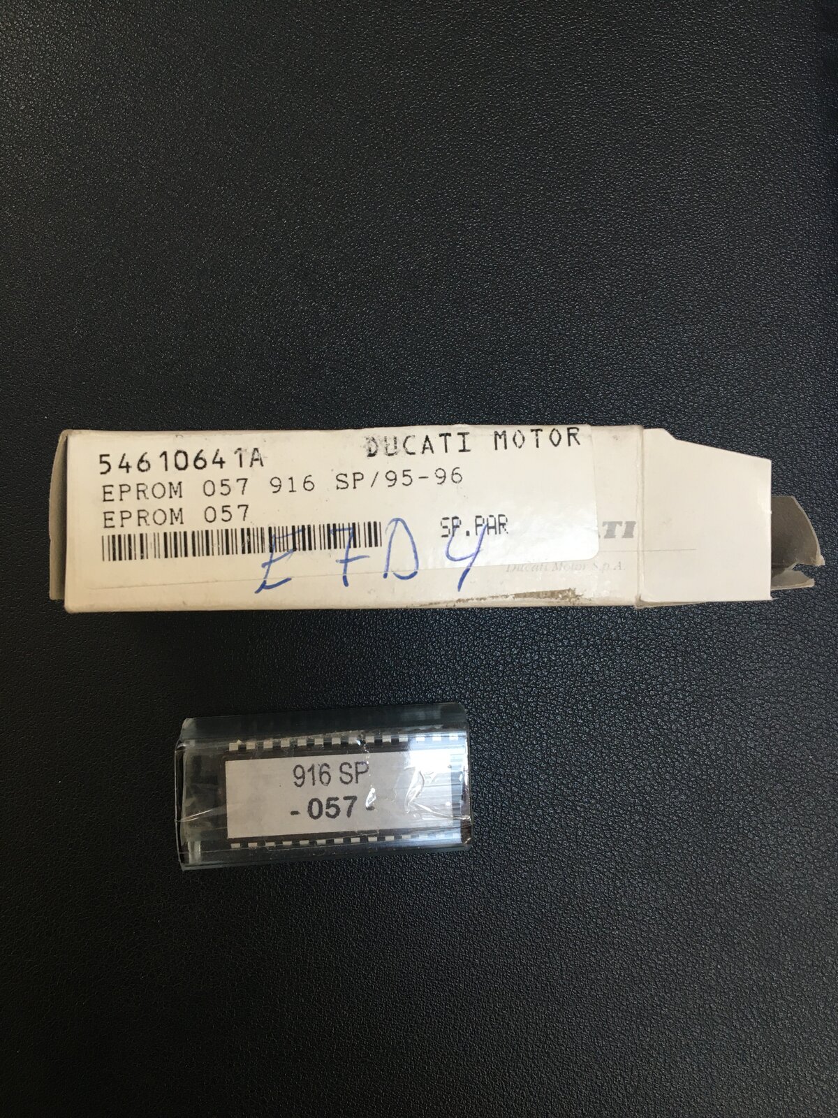

  12. Kev,

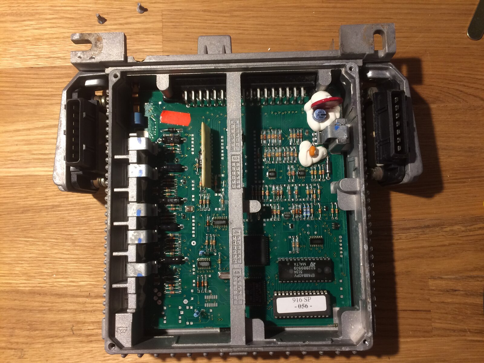

    I am actually looking for a #57. My SP3 came with #56 in the P8 and a NOS #58 on the side. I followed your search for a #57. Would you have a direction to point me towards for a NOS #57?
    Cheers!
    G
    #35 Guillaume69, Jun 2, 2022
  13. Hi G, I have had my SP3 from new so only have the OEM parts. The -57-, the standard part, is very hard to find as many were lost or not even delivered, I guess as most owners put the Termis on from new. There was a gent on the 851/888 forum, Haga40, who seemed to have wide range of OEM chips for both 888 and 916 bikes. It was a while ago, but he might be worth a try.
