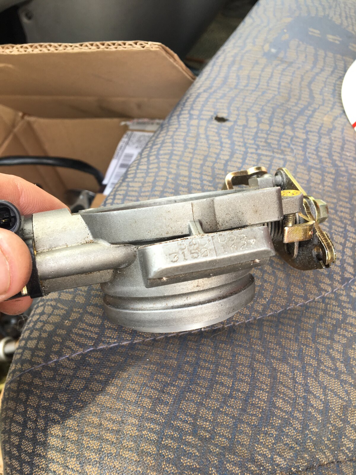

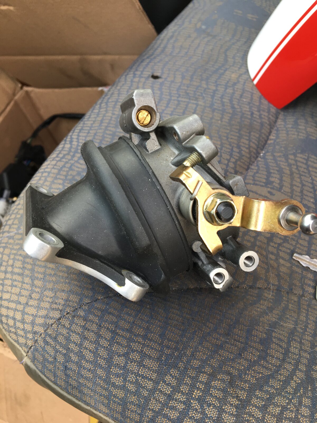

  3. Can Monster S4RS t/b's used to utilise the later, more reliable TPS?
  4. TBH I dont know. I personally hav'nt had any problems with the early TPS other that water ingress that has occoured due to spindle wear.
    The later TPS on this project is all new to me so we will see.

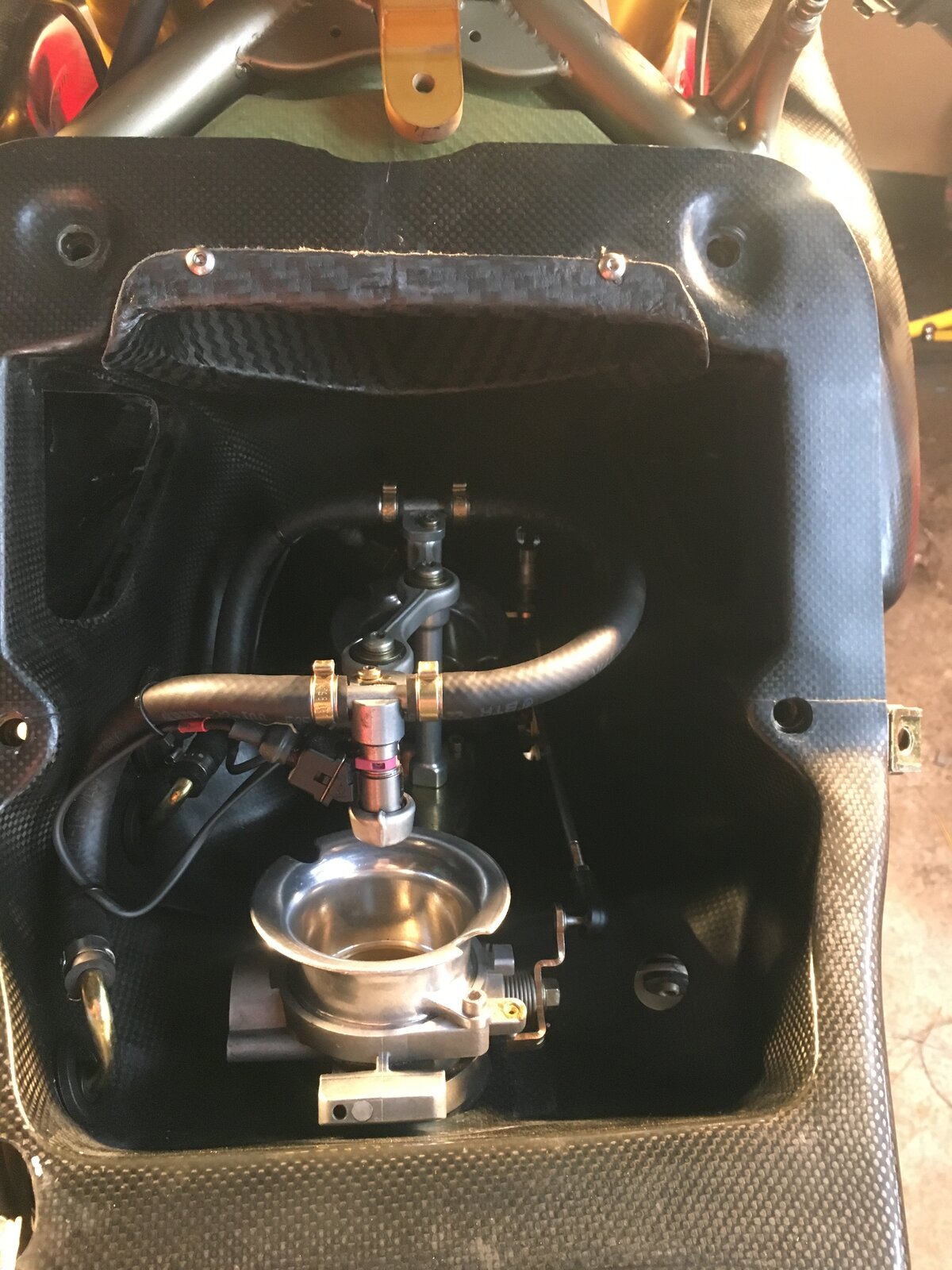

  6. Will get some pics of a s4rs ones fitted to a 888.
