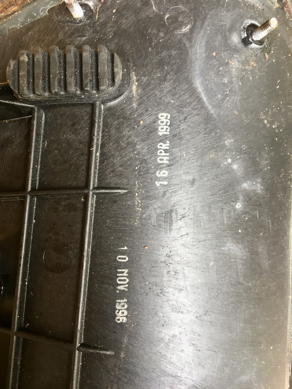

  12. The date can often also be stamped in ink in the format 11 Mar 1997, which ever it is they are easy enough to spot. It’s not necessarily detrimental if the date doesn’t match the bike just you’ll know if anything’s been changed and then ask the question, why. Also, be aware the dates may not always tell the full story. Eg I have a 748 I’ve had since new in 1999. On the underneath of the seat unit there’s an ink stamped date of April 99 but when I took the whole unit to pieces and removed everything there was a second earlier 98 date. The thing must have been hanging around in stock in the factory and was redated when it actually came to be used.
    @Exige ‘s description of the date will be the date it was actually moulded.
  13. Oh, and one more thing. You ain’t gonna be carrying a pillion anymore than the one time. After that first time they’ll be extremely reluctant to get on it again IME. You sit what seems 3 feet above the rider with nothing to hold onto.
  14. Indeed, the panels are usually 6 months older than the bike, sometimes much older - but never newer unless they have been changed after a crash or such like. Never seen the stamped dates and don't know what they signify :thinkingface:
  15. When it was taken out of stock perhaps:thinkingface:
  16. Never known that to happen :thinkingface: I was thinking a paint stamp date maybe - is it common for Ducati?
  17. The ones in the photo are on the underneath of a seat pad so no paint. I’ve a couple more dotted around the body panels as well. If I remember I’ll take some pics next time they’re off.
