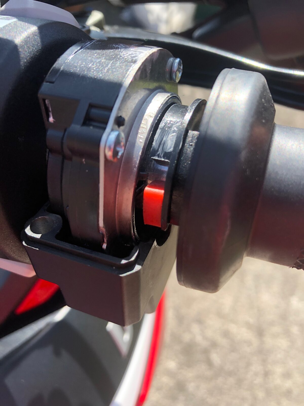

  6. Mine is the 1260 MTS which the spacers on ebay and shown here do not fit, the 1260 uses just one spacer that clips on, I really don't know about the Diavel
    The only way to check would be to take off the throttle body and have a look unless someone has already done it, I will post some photos later today so you can see what to expect.

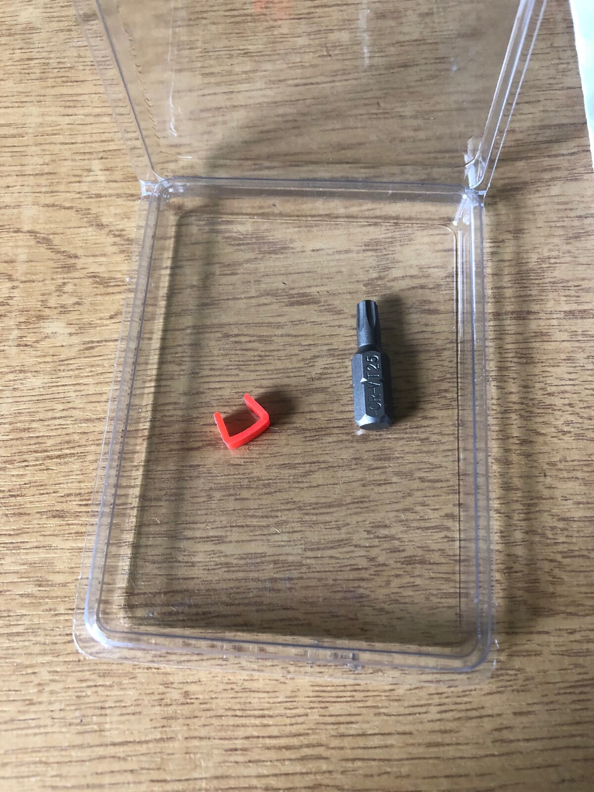

    I have had this spacer in now for a few weeks and it is a vast improvement, specially in sport mode where the throttle action is so much smoother, especially when coming off the throttle where previously is was very jerky as previously discussed by many others. I was a sceptic and its a lot of money for a little piece of plastic but for a solution to the problem its priceless :) so happy is the wife as I get to keep it in sport mode all the time now and enjoy the full fat setting woohooooo

  12. Here's a photo of the 1260 kit and the install, also have the two piece kit for the 1200 if anyone wants one cheap cheap cheap!!

  14. Welp, picked up the bike, a tonne of play in the throttle, got home, installed the spacer, went for a ride. Night and day! Best mod in my opinion.
