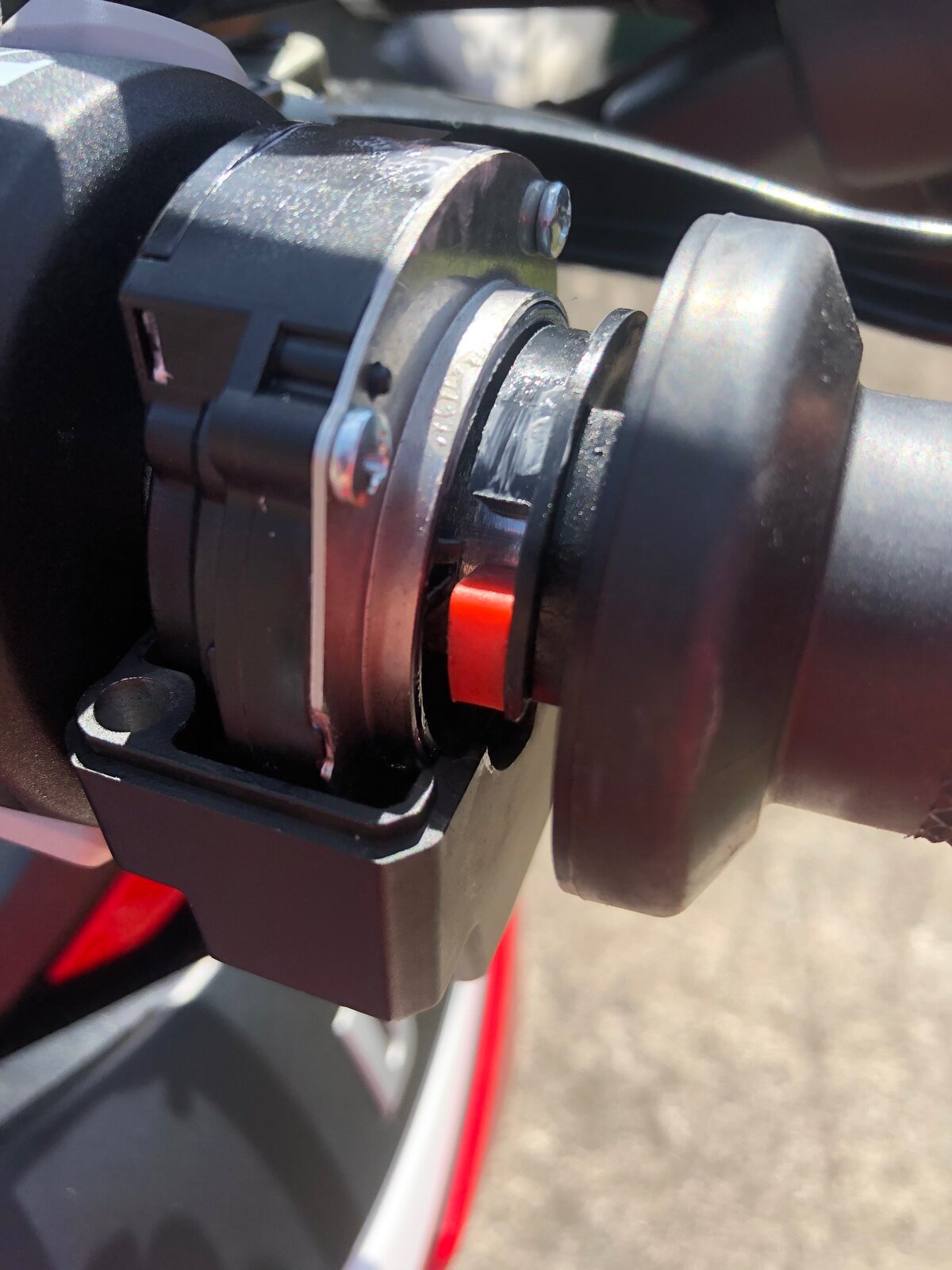

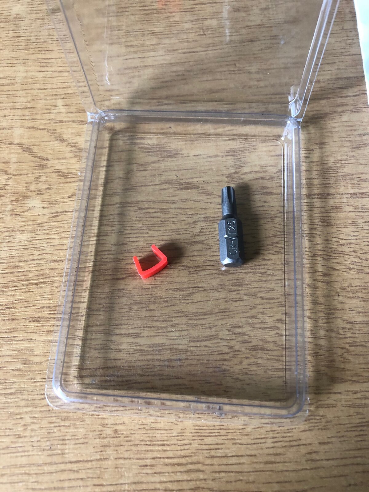

  2. All the spacer does is remove the 'slop' at the at the very begining of the throttle travel. It does nothing once that 'slop' has been taken up by you marginally twisting the grip. It has zero effect elsewhere in the range, how could it.
    Traditional cable operated throttles required a little of this free play/slop so that turning the bars didn't introduce extra tension into the cables and make revs inadvertently rise. I guess Ducati are trying to mimic this with their ride-by-wire throttles.
    At very low speed riding the on/off throttle response on my 1260 Mutley could be a little vague due to this, the spacer has eliminated this free play and for me was a worthwhile modification. Extortionately expensive for what it actually is but it works.

  9. I was out with @rotaxracer yesterday and we swapped bikes for a short test. Both have 1260's, both have throttle spacers but I felt mine had less 'on/off surging' when you close the throttle. The only other difference is Pete has removed the cat and has a Termi end can. Mine has the standard cat and end can.
    Yes it's a stupid price for a bit of plastic, but personally I think it really helps and is worth the money. And you will always be able to sell it to someone when you change bikes.
  10. As Twin4me said I have gutted my standard cat box and have the Termi slip on, we both have exhaust flap eliminators and throttle spacers, riding the bikes back to back there was a difference between the on-off throttle snatch. Chris’s bike felt much better as in smoother in transition from off to on.
    I will try to narrow down the cause by switching the gutted de-cat box for a stock spare that I have to see if that improves my issue.

  14. I just looked it up on the website in The States. The spacers do not fit a 1200 DVT.
    The twist grip body is different on older models. I have read that on a 1200 DVT you can pack out the area of slack with a tiny bit of plastic, basically acting like a shim to fill the void. Apparently if you trim a tiny bit off an A4 plastic folder it works. You fold it over to fill the void accordingly. I might even try it today.
    I certainly wouldn’t try it with the 1260/ Panigale throttle types. For the record I have fitted one of the aforementioned spacers on my Panigale and they are excellent. Taking away that on/off slop that hits you in the back of the neck.
