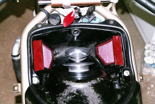

    * apart from small fire risk, it is true that these one-piece filters are an improvement on the original but best of all is the B MC type its just that these are horrendously expensive (over £100 the pair) for what they are

  5. BMC ones look trick though ! Best I can find on ebay is £150 ! [​IMG]

  9. I got my BMC filters from E Bay Italy. I cannot remember the exact price but they were not much over £100 including post. Twas a fair while ago though
