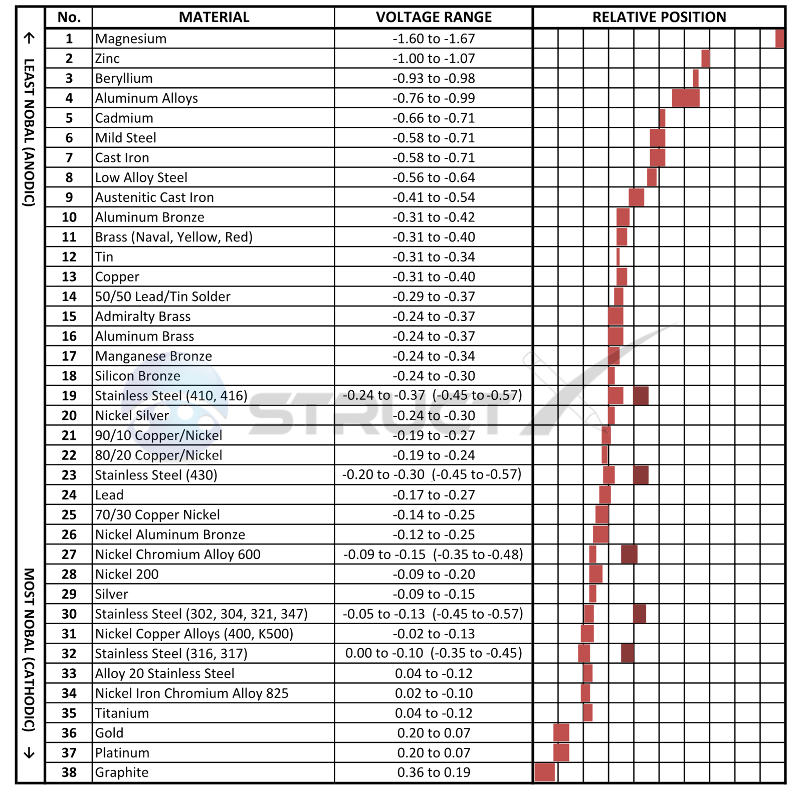

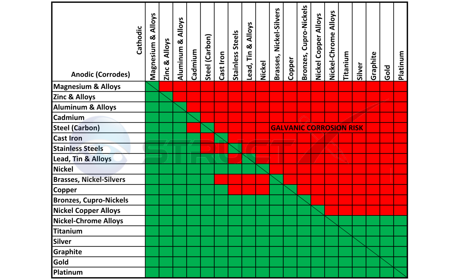

  15. Well every day is a school day - went down the rabbit hole trying to understand why this is such a difficult one and found out things I didn’t learn in a Chemistry class!
    Found some handy charts!
    Turns out Titanium and Magnesium are pretty as dissimilar as it’s possible to get! Although based on the info below - pretty much any other metal will corrode Magnesium. The aim of an anti seize compound is to create a barrier between the 2 metals - often by using another metal that sits between the 2 dissimilar metals on the chart. But as you can see - Mag is so different in voltage to all of the other metals this is difficult.
    So if you are going to do it - then ideally you need a none metallic anti seize and never get the bike wet - in fact according to the info below it’s kind of a miracle that Magnesium doesn’t just turn to dust on contact with air......
    Whenever different metals are positioned in an electrolyte within close proximity to one another preferential corrosion becomes an important factor to be aware of. Galvanic corrosion typically attacks junction areas of dissimilar metals and occurs when the following three conditions are met.
    • Condition 1: Metals must have a galvanic incompatibility (voltage difference - see below table).
    • Condition 2: An electrolyte must be present (water is a good example).
    • Condition 3: There must be an electrical conducting path between the metals.
    The galvanic series chart below shows metals and their electrochemical voltage range (relative activity in flowing sea water). A typical rule of thumb is that voltage differences of 0.2 Volts or more suggest a galvanic corrosion risk. Generally speaking the further apart the metals in the galvanic series the greater the risk of corrosion, with the metal being of least noble (Anodic) class typically corroding.”
    • Useful Useful x 2
  16. Good man - you found the galvanic series/dissimilar metals charts! This is why magnesium alloys are never used in commercial aircraft - they corrode to buggery on contact with anything +electrolyte!
