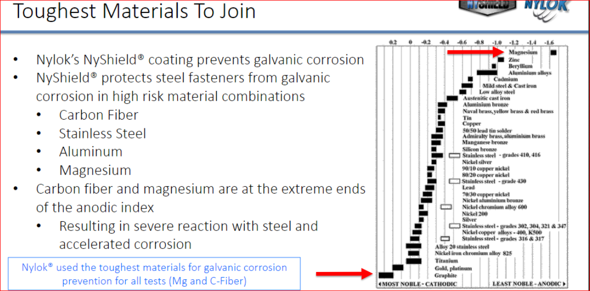

  11. Seeing as we're already here...
    Every day's a school day: Carbon Fibre material's galvanic-corrosion potential.
