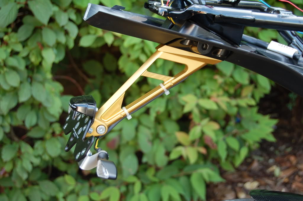

  1. similar story explains my bike :)
  2. I see it as a loan that I'll pay back in pain and irritance. ;)

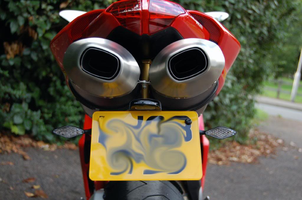

  3. the tail tidy on my 1098
    made by Melotti

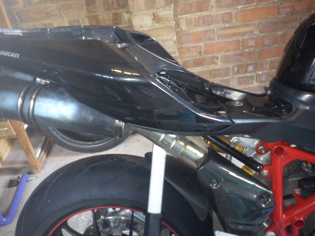

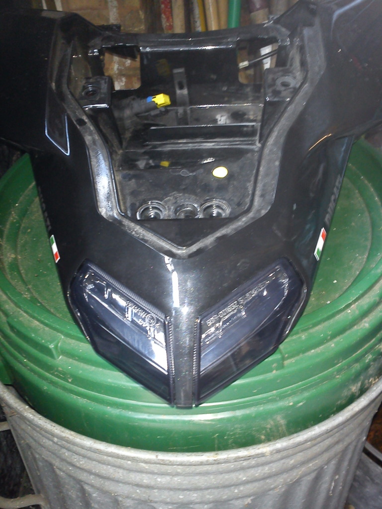

  13. Well I just went into the garage to fix the brake light on my Ninja when before I know it im taking the back of my Ducati apart.
    I got the tail off and replaced the rear light, with a dark smoke integrated model
    Took off the exhausts, replaced the number plate hanger, put the exhausts back on
    and that is where I stopped.

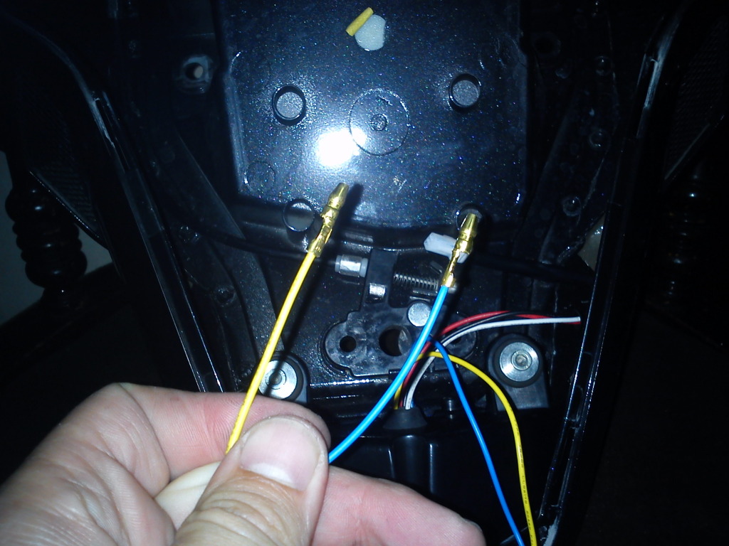

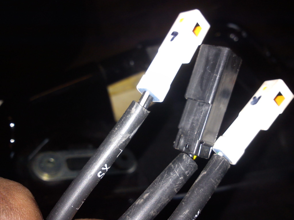

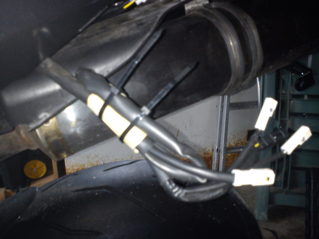

    I checked the wires from the loom that go to the rear indicators
    and noticed that that have double the wires for actual lights :eek:
    I wanted to get a second opinion as to join the wires I going to need to change at least one connector, but which one. If possible I'd like to have the white box connectors that are on the loom, but it may be easier to cut them off and replace them with some bullet connectors. Does anybody know what the two wires are from the loom, ie is one an earth, is so which one?

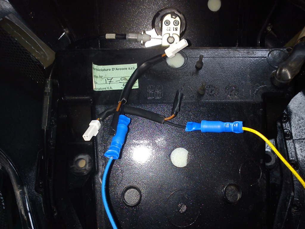

  14. The final part. I started by cutting the wires from the original indicators (to get the plugs), found the positive wire and grafted on some bullet connectors. I cut the wires from the new rear light down to a better length and joined it all up.
    Before it went onto the bike a surrounded them with some insulating tape, checked my photos to show where the original wires went and the cable tied what I could to the rear sub frame
    After a little bit of jiggery pokery I got the rear back on, making sure to test it all before I tightened everything up

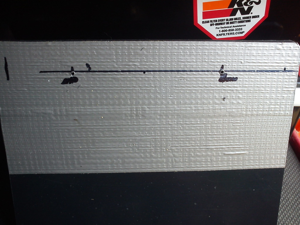

    Measured the back of the new plate with some tape and a Sharpie

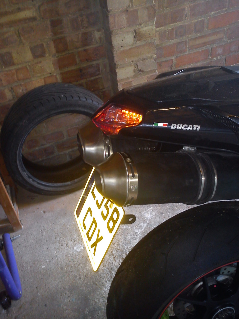

    and finally a nice tidy looking rear end
    Once I know the MOT man is happy, i'll cut off the indicator hangers from the side of the number player bracket. Job done :upyeah:
