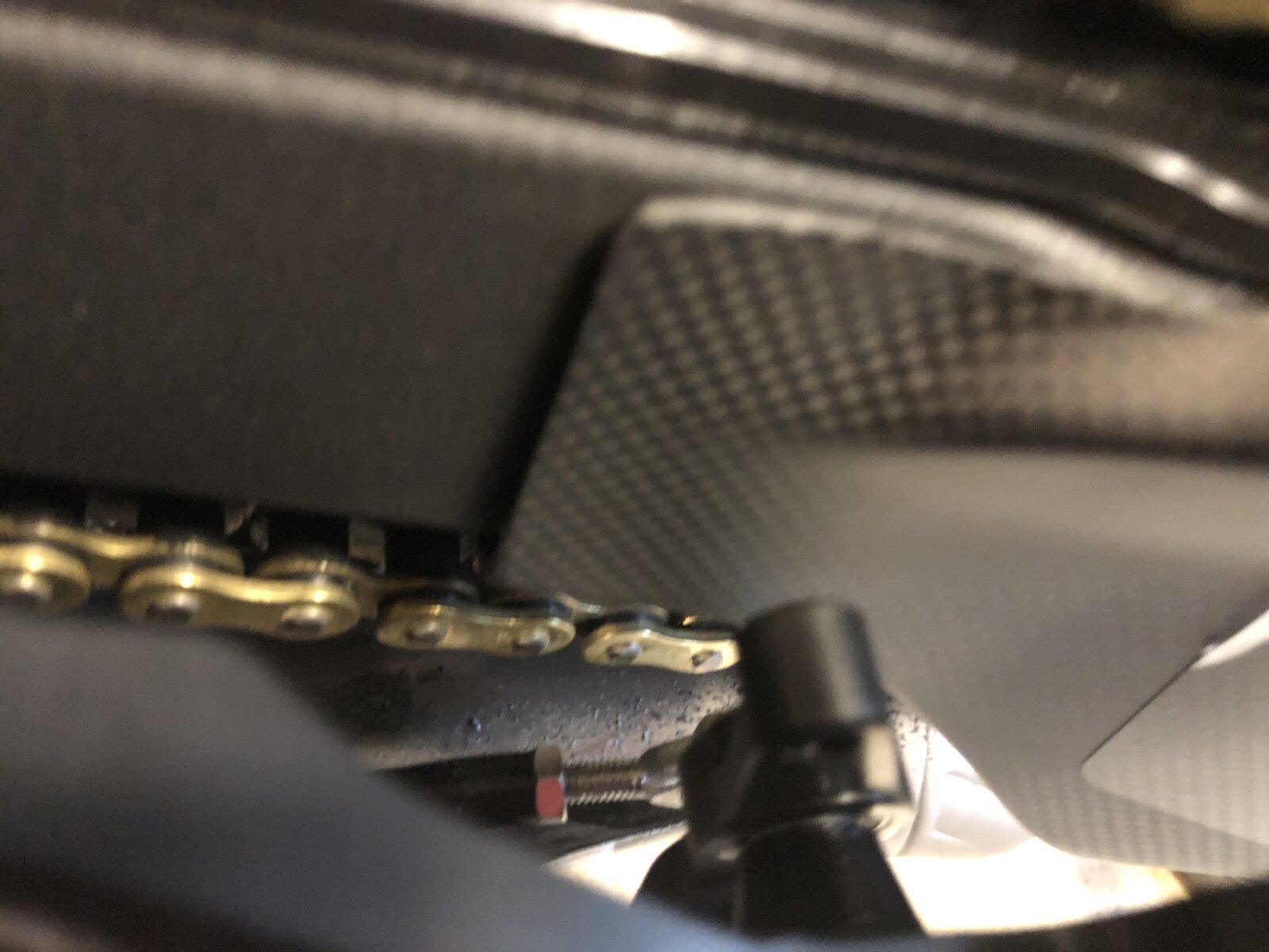

  10. Samey do a picture of your gear linkage rod and the qs position please
  11. Did you swap the whole rod 180 degrees or did you swap just the rear eye position please?
  12. On the STD rear sets, you swap positions upper to lower etc.
    Here Is a photo of my Light techs. The rod is connected to the bottom of the 2 connector points. Hope you can see this in the photo.
  13. No just swap the eye position and that's it, dead easy mate.
  14. And the down and up shift all good
  15. Yeh works perfectly as it's supposed to.
