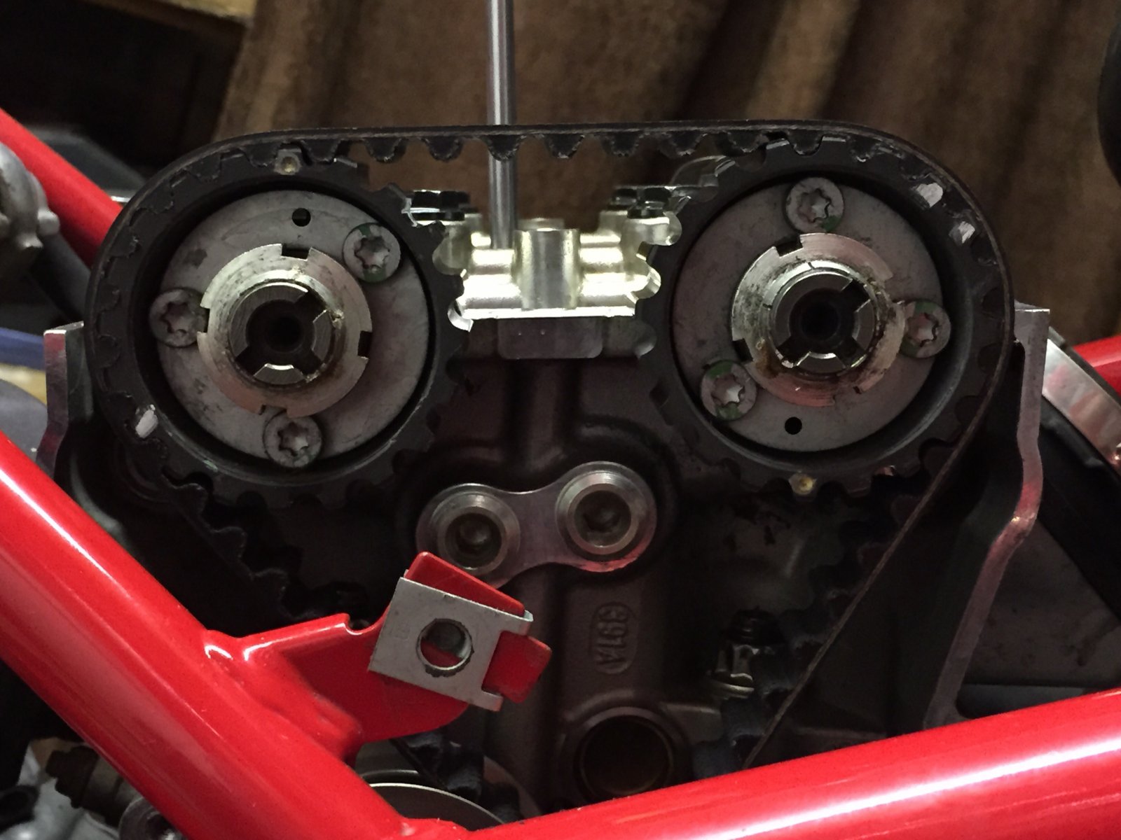

  1. I have turned the inlet side only and there did not appear to have any tight spots. Will be giving this a go tonight and if I can't sort it out, I think it's time to take the bike to the experts.
  2. Subscribed for interest
  3. So I have the cam cover off. The cams turn without any issues. The engine turns without issues. I connect cam belts and when the rear cyclinder comes up to tdc the exhaust stroke its as if the piston just touches the exhaust valve ever so slightly. The vavle is still closing when the piston is at almost at tdc.
    When I turn the engine backwards it perfect. No issues no tight spot. I actually beleive the tight spot is the piston just touching the exhaust valve.
    So possible verdic is the exhaust cam has slipped?? I definite don't have to experience and or tools to check all that.
  4. Well well well. Big thanks to Nelly. Was thinking about what you were saying about the 4o clock and was taking pictures of all settings and comparing each time and I then realised that I wasn't setting closer to 4 but 5 o clock set to 4 and bingo she turns beautifully again.

  7. Can't believe it took me that long. The key was well obviously Nelly and that I took pictures to make reference between the different positions.

    Well done to the very experienced and knowledgeable Nelly for pinpointing the reason for the tightness when turning over the engine and well done to the op for taking pics to help identify the cause and for bringing this to everybody's attention.
    Looking at the pic of the shredded belt, the belt seems to have come off the inside of the fixed pulley, which is very odd, given that the pulleys have lips on them. The lip on that pulley does look as though it might be damaged though.
