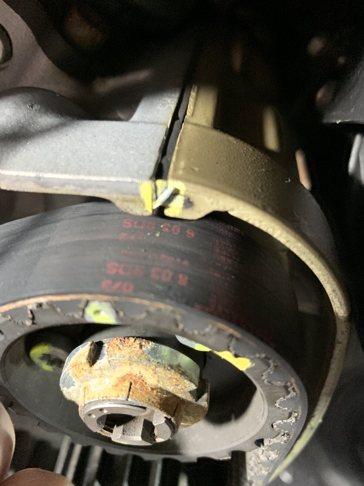

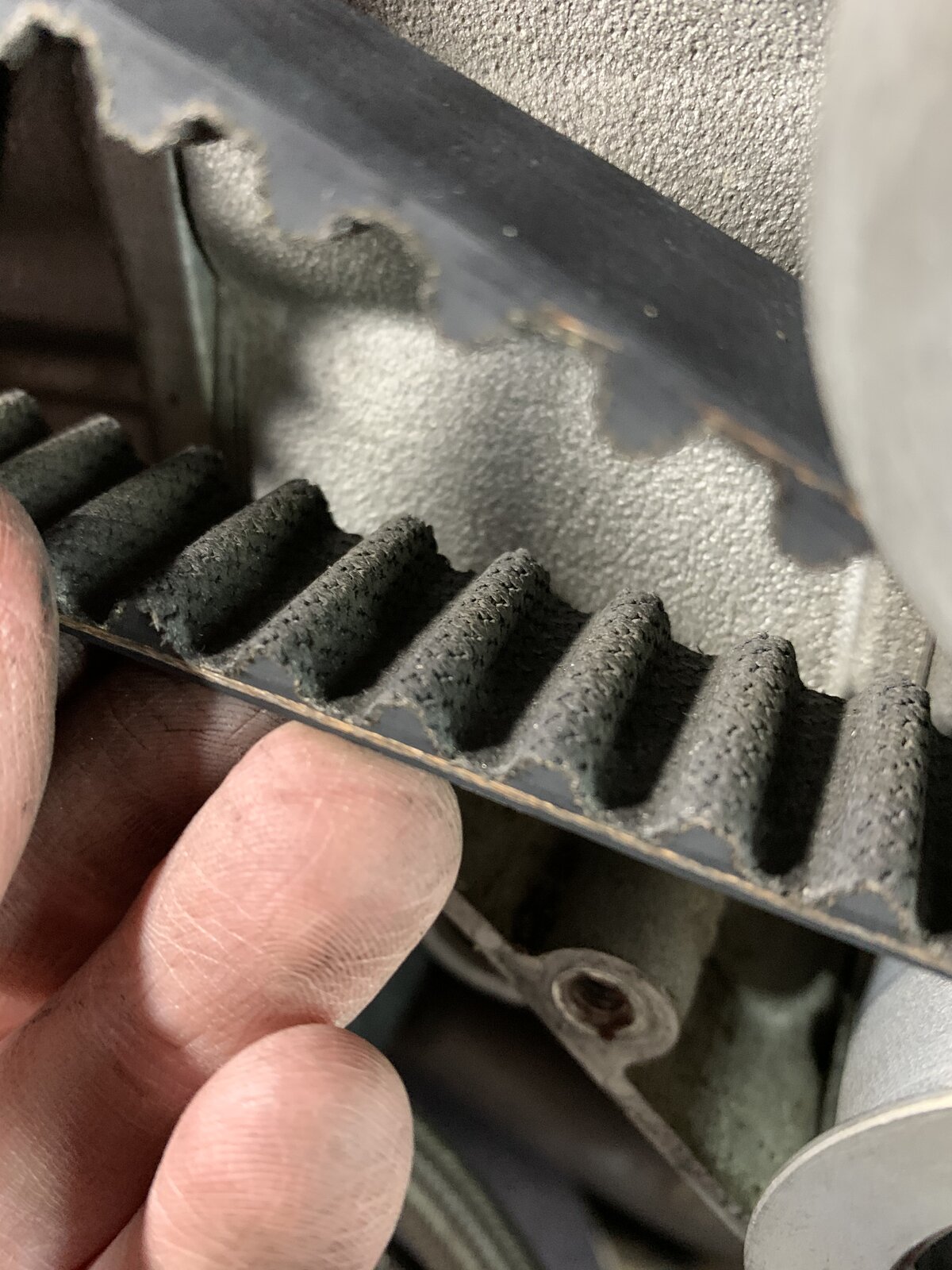

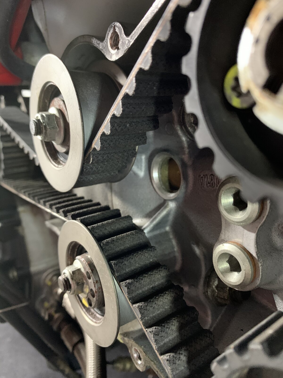

  7. 56A19691-0DC9-44DF-9376-29ABEAA63339.jpeg 1CCC8A8C-6C5C-4341-B310-92EC96922F82.jpeg So, personally I think its not just the stored bikes but where they are stored and what humidity. Ie hot dry places, versus cold and damp. My 848 was just over the 2 years Recommended but had only done 2k miles as I was actually storing it at my parents, I took the covers off to check the belts and tank they looked worse than I expected, like they were really dry and starting to show signs of having got really hot. I’d done 1 trackday
