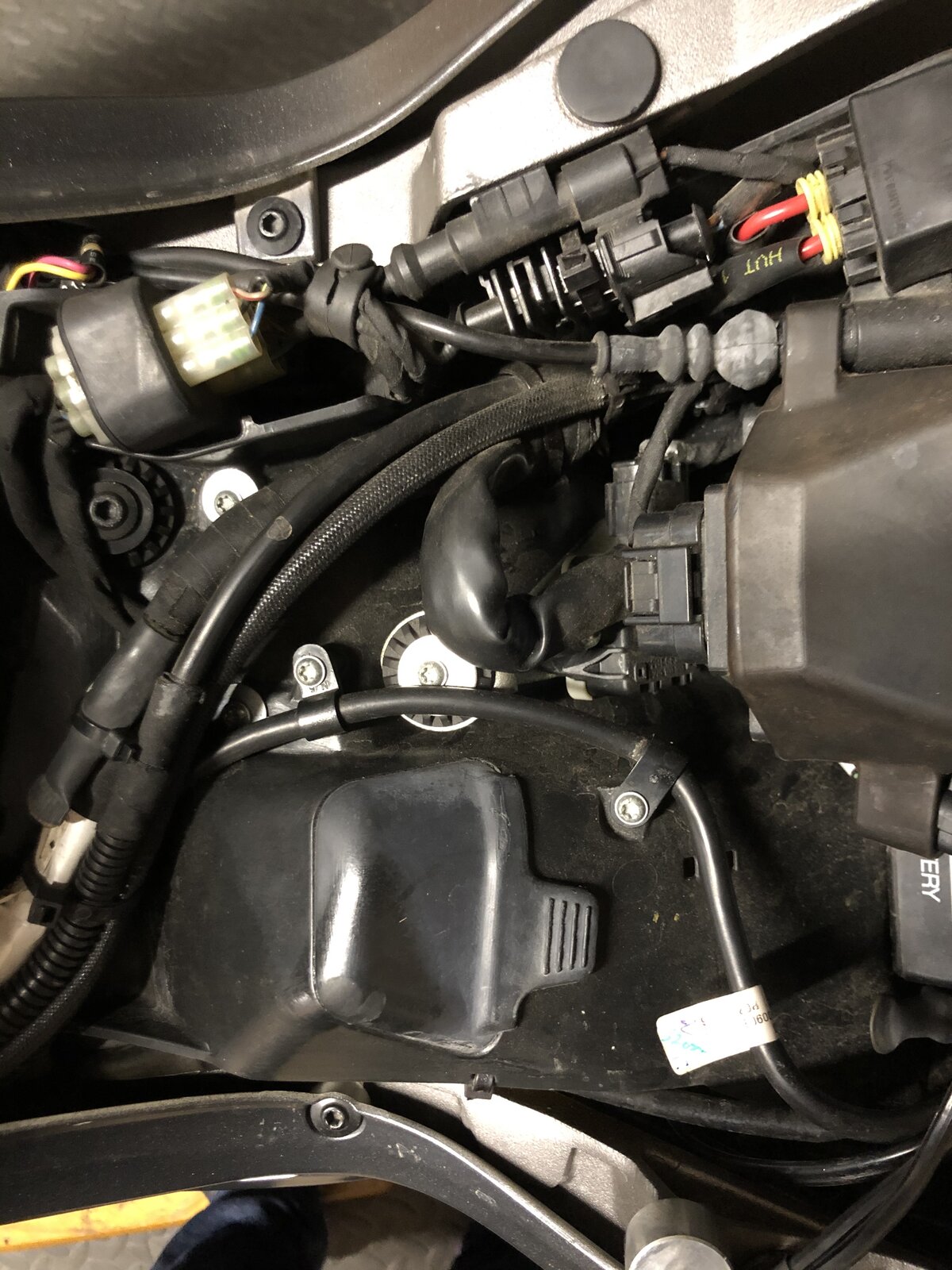

  15. Hi again guys. So I bought the Healtech exhaust valve eliminator for my 2018 Multi 1260s. Can anyone help me on where this connects under the seat? It’s all pretty compact in there as the pic

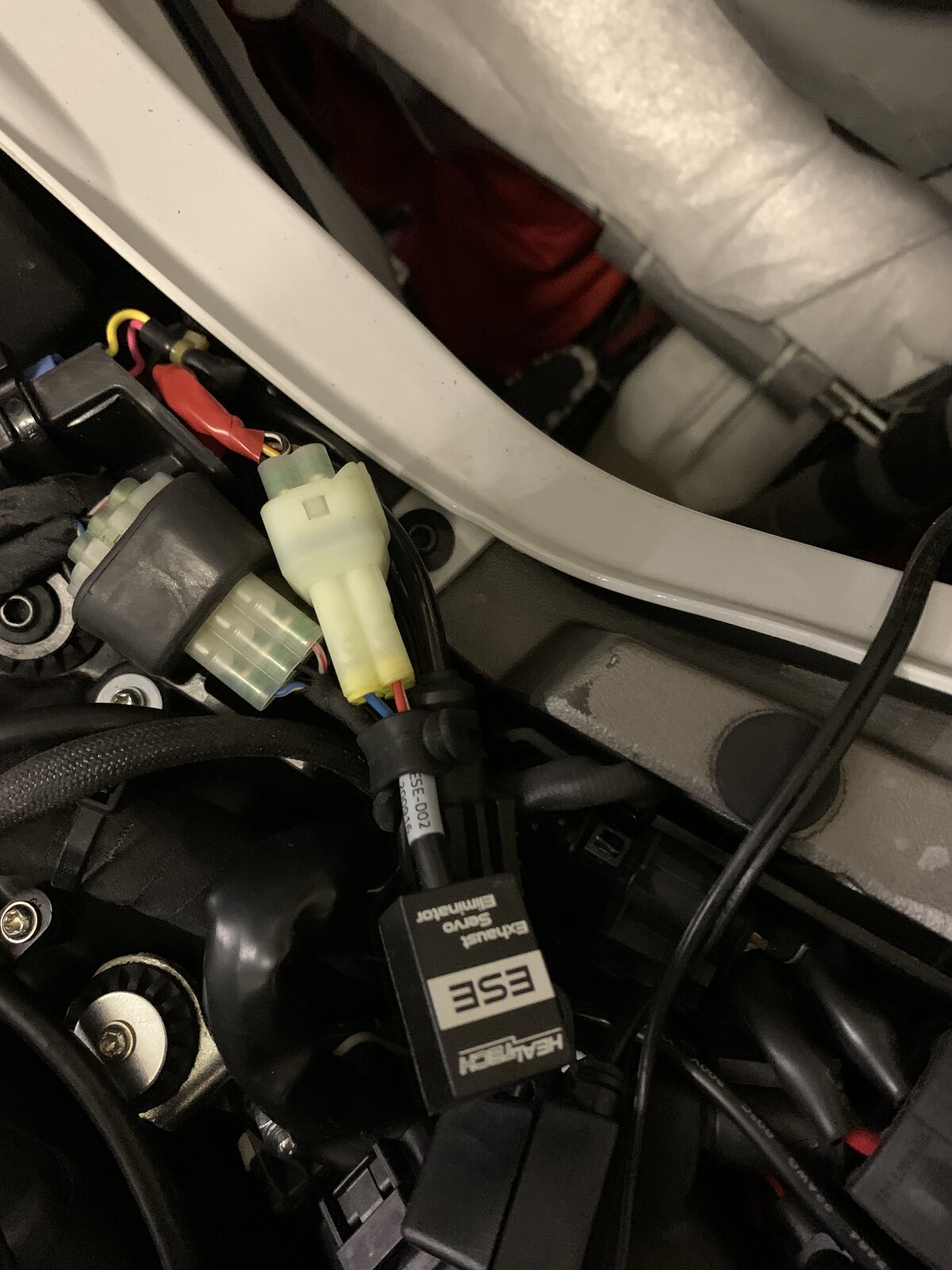

  16. Lift up the white connector, it's tucked down the side of the frame underneath this.
    Here's mine with it fitted, it's best to pull the connector up a bit so you can get to it. I also added a bit of tape as the wires seemed a bit exposed.
  17. Perfect thanks Twin - appreciated mate
  18. Yup, I lived with mine for quite a while. Mine was the center plug wire on the vertical cylinder. It was most likely damaged while I was removing it for the valve clearance check.
  19. So I managed to install the Healtech as the pic. Bit of a faff getting the connector up from the frame! The instructions mention to check that the valve is in the open position pulling on the cable. Do I need to do this on the multi? Or is it I the open position by default anyway?
  20. Yes it’s a bit of a struggle to get to.
    If the valve is open then you wouldn’t hear it cycle when you turn on the ignition. A sort of swish swish noise.
    if you take the end can off again you can see if the valve is open. Or you might be able to look down the exhaust with a torch.
