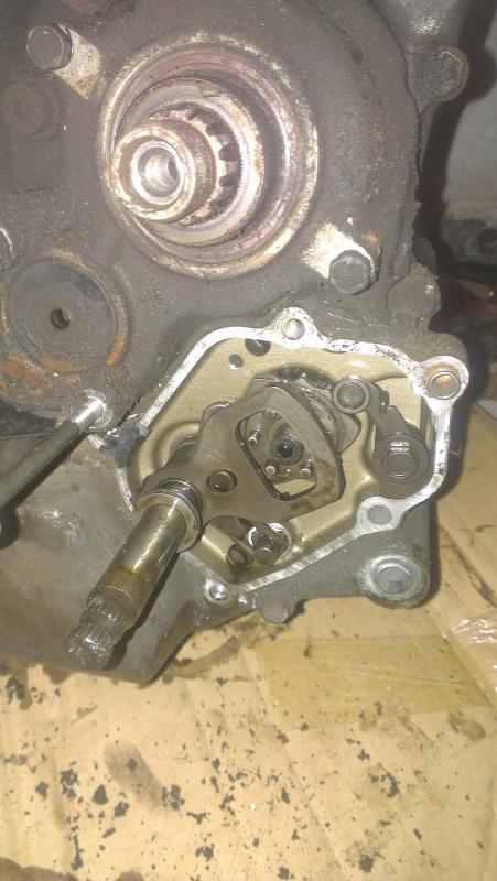

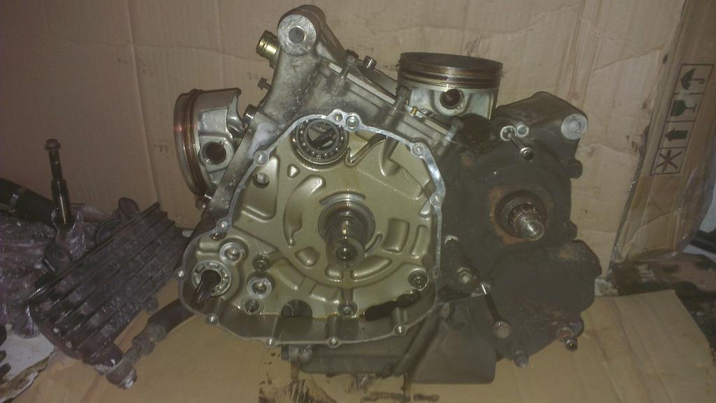

  4. Ok folks. So I ended up buying a flywheel puller (£21) but it's meant the flywheel pulled off, quite easily too:smile:, sp I pulled the cam chain drive shaft out while I was there.
    A nice big 36mm socket with a 2 foot long bar and the primary gear came off next.
    Then I thought great, nearly there, lets undo all the casing bolts, which I did. Before noticing the selector mechanism should come out.
    With that out I decided to take the oil cooler and starter motor out. Yeah I know, bit of a funny order to do things but I am all full of Christmas cheer right now. Anyway, while turning the engine to take a photo of said work, it fell over. Neatly popping the unbolted cases apart. Lovely :upyeah:
    So I pulled the right casing off to expose, well, not the horror I was expecting.

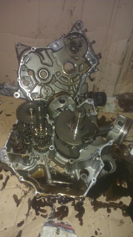

    So out the gear box came with selector forks and drum, all to be checked tomorrow.
    I'll let you know my findings soon. But I'm guessing the selector dogs will be buggered on the lower gears, along with maybe the selector forks. :frown:

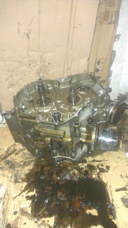

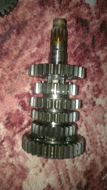

  6. Well, after working all the hours god sent to find the £700 just to replace the worn and damaged gears, I found a possible EBAY bargain. Below is half my old box, if you look at the dogs closley you should see the wear. Which I didn't think was too bad.
    Now, i found a complete TL R bottom end on fleabag starting at 99p but having a rod about to detatch itself from the crank. So i took a punt and won at, well, £21. I wasn't too hopefull of their being much savable in the gearbox but if i got 1 good gear out of it it would be worth it. When i finally got the thing apart, some nuts were alot tighter than my engine, look what i found.
    A mint gearbox. :upyeah: Every gear, on both stafts, absolutly fine. I don't normally get this type of luck. What a result :biggrin:

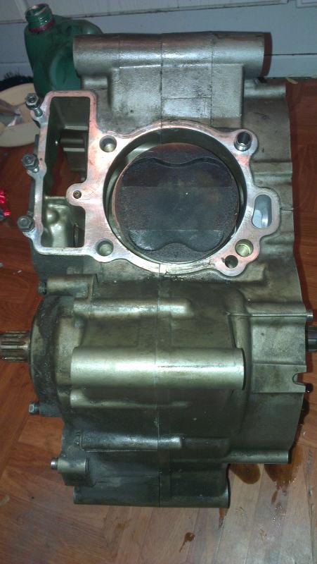

  16. So, with the gear box fitted,

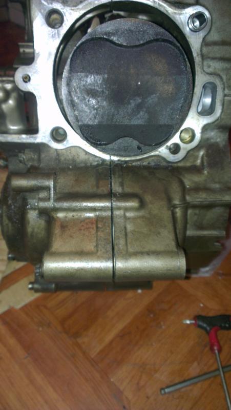

    a quick try of the right case seemed to fit quite easily. So I put i bit of sealant around the edge and drop the right casing into place. WTF!
    Now I'm sure that gap wasn't there before:eek:. So I take the right casing back off, remove the gear box, check everything, nothing obvious, fit the box, try agin, still a gap, so I take the right casing back off, remove the crank, check everything, nothing obvious, try agin, still a gap, so I take the right casing back off, remove the gear box, check everything, nothing obvious, fit the box, try agin, still a gap, repeat until my baby son, Vincent, saves me from having an engine shaped hole in my lawn and a window to fix. He's a good lad already that boy :smile:
  17. I may be complexly off base but isn't that gap for the lower skirt of the barrel to fit inside the crankcase?
  18. It's not the gap around the piston, you're right that's for the barrel skirt. It's the few mm gap between the cases that's the problem:frown:. I even went against all good practices and tried to pull the cases together by bolting it up:rolleyes:. No joy with that:frown::frown:, so a few more attempts at taking bit's out until it fits neatly has revealed it's just the output shaft and gears that are preventing the cases fitting together. I can have everything else fitted and they close perfectly:smile:. But even just the output shaft with it's gears and it doesn't go together so at least I've narrowed it down:smile:. It's not like a Ducati though. There's no shims at all in the gearbox:rolleyes:. Sort of one size fits all I guess. There are a couple of thrust washers but that's it. Got a busy couple of days ahead so it's just going to be one of those nagging problems on my mind until I can get back to it. Here we go again :rolleyes:

    It seems the bottom end i bought was a late TL R set and there are a few changes/improvements, but I really want to keep my numbers so had to keep my orignal cases. Anyway, didn't need to worry as toady, after getting up at 5am, riding 10 odd miles in whatever version of freezing it was this morning for work at 6. Then leave again at 8, ride back though rush hour to get ready for a funeral at 9:15, home 4pm ish and by 6 my TL cases were together. :upyeah:
    Now to pull it all apart to clean it, grease it up a bit then build for real. :upyeah::upyeah: Where upon it probably won't go back together. :rolleyes:
