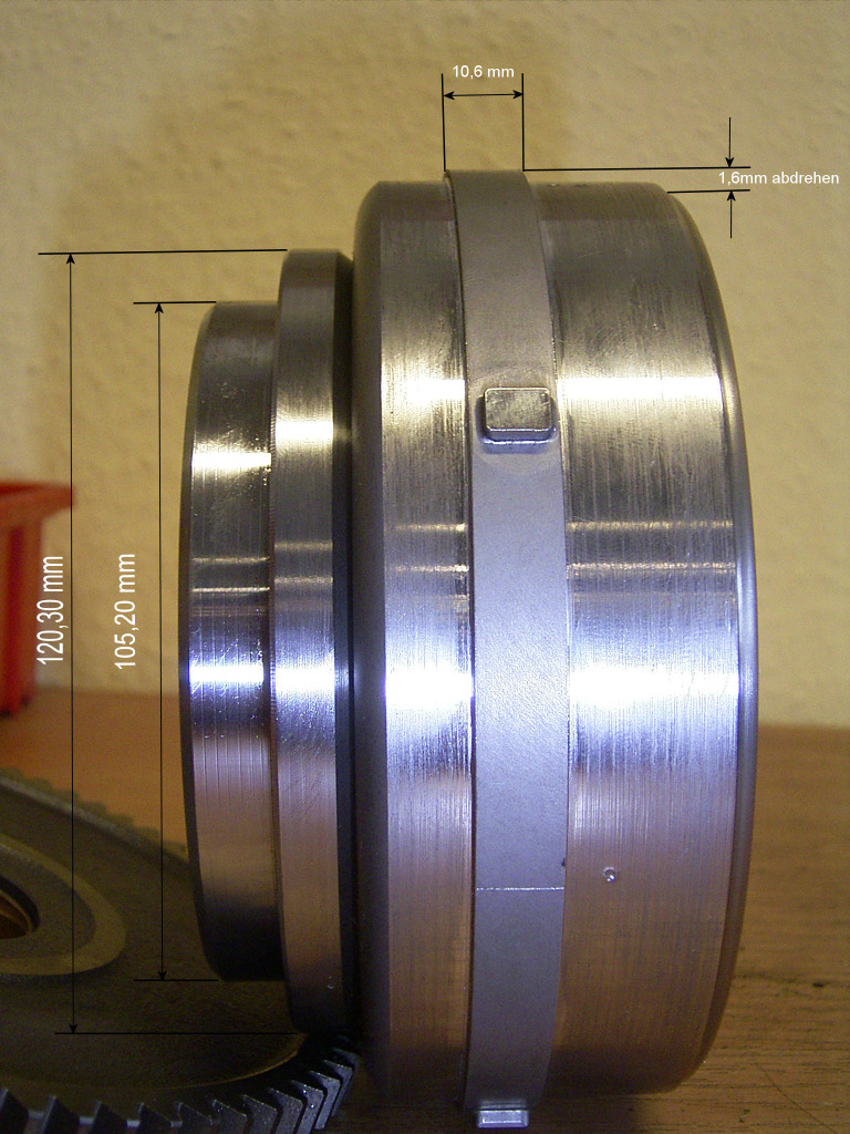

  1. Iv just rebuilt a tlr engine and fitted it in to my 748 frame. I removed all the scissor gears from the cams and primary gear that saved about 500 grams and took about 600 grams off the flywheel.
    Spins up nice and fast now.:smile:
    Iv got the specs for the flywheel if you are interested?

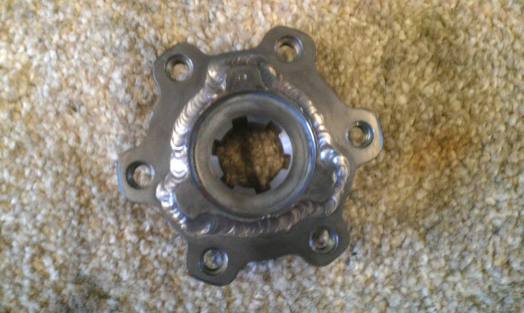

    also its a good idea to have the clutch center welded up to stop any clutch slip in the future, Sam can help you with this from TL ZONE.

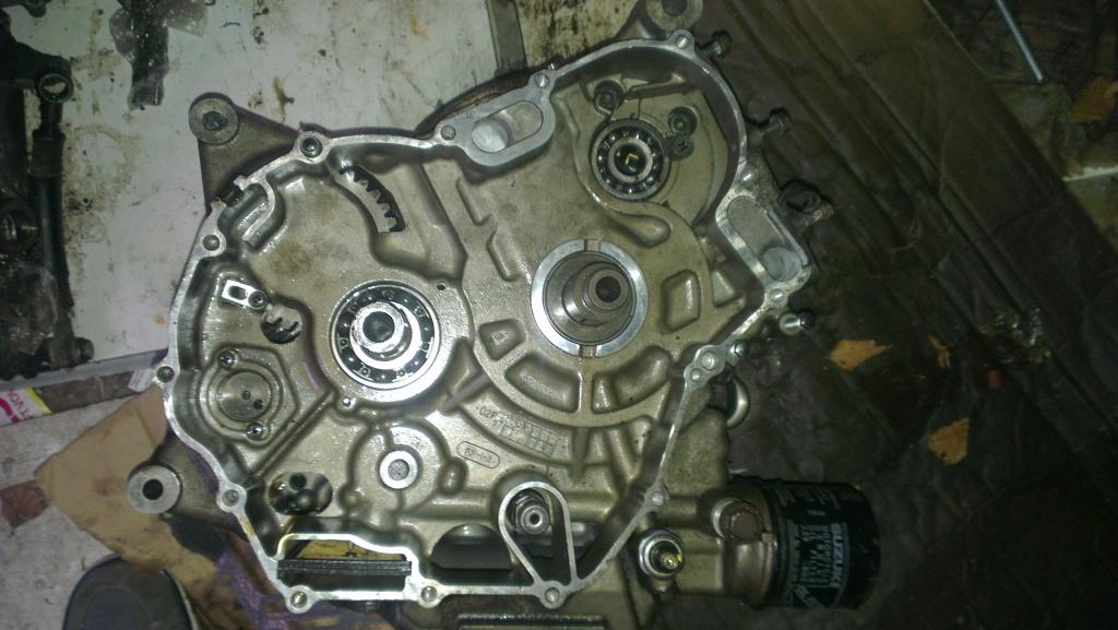

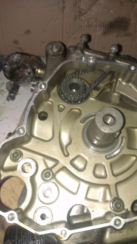

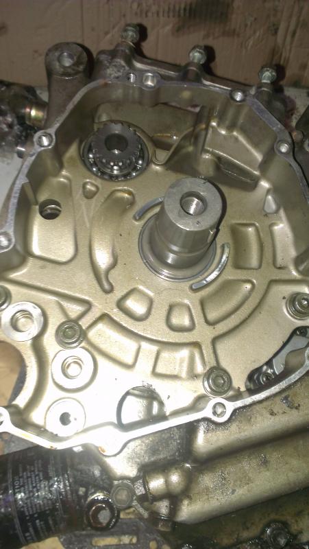

  6. Woo hoo. A day off :smile:. So lets start work :rolleyes:.
    I've already stripped it appart, oiled the bearings and sealed it all together so today I'm starting with this.

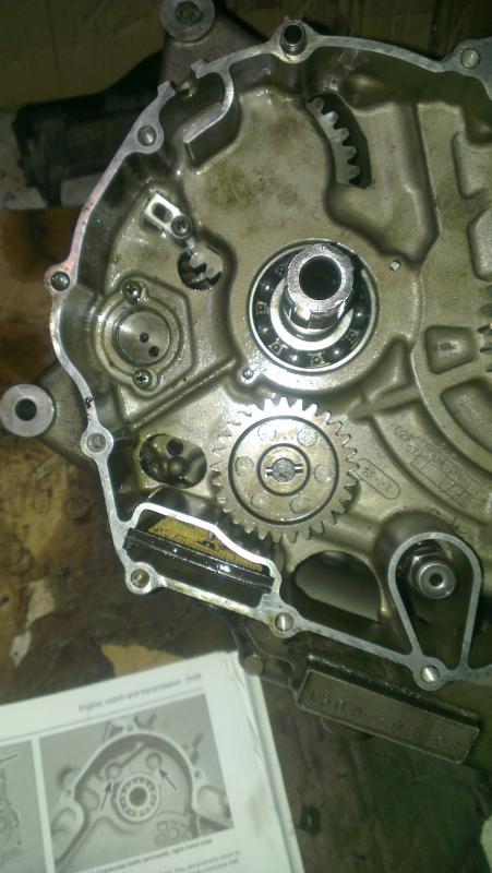

    I drop the cam drive chain shaft in first along with the vertical chain,
    and secure it the other side by fitting the woodruff key, horitontal cam chain drive and chain, then the washer and nut.

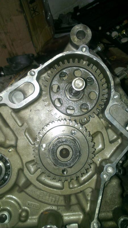

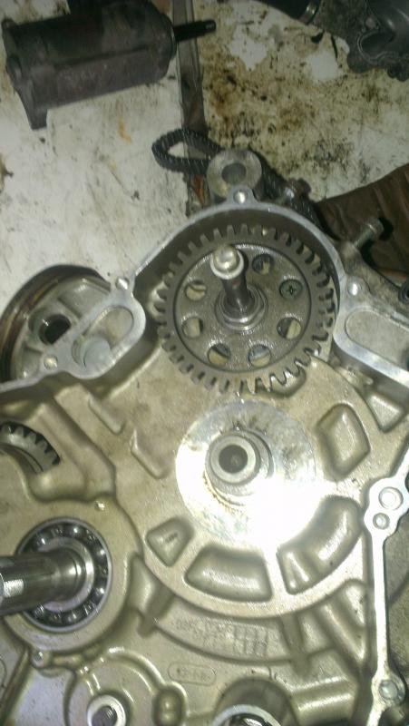

    Next was the thrust washer, woodruff key, primary gear, washer and nice big nut. Remembering to line it up as it was when I stripped it, having this thread certainly helped. While it's impossible to forget when doing it up, it's important to make a mental note that this is a left hand thread.
    Oil pump drive gear went on next,

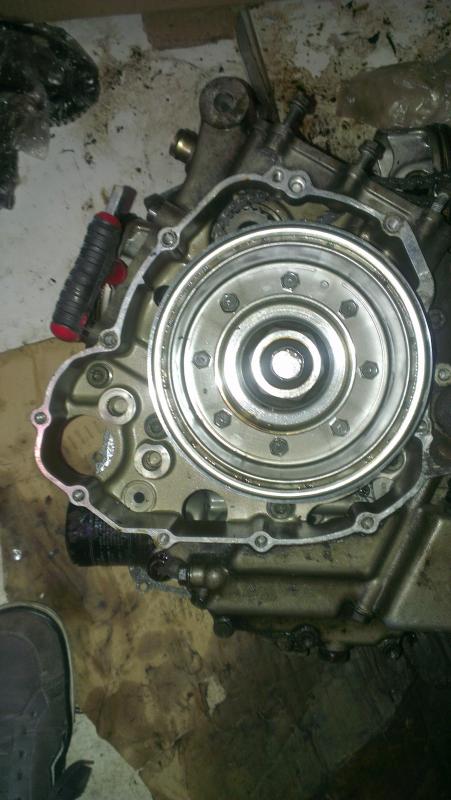

    before returning to the left side and fitting the flywheel.

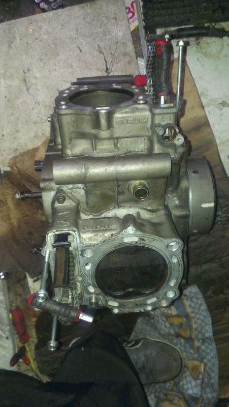

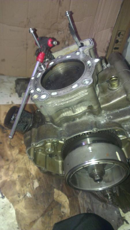

    Next, thinking I should've done it sooner, I decide to stop the pistons flopping about and put on the horitontal
    and vertical barrels, leaving me this :smile:.
    It's right now I realize I've been a bit premature :eek: (no comment from the misses). You see I've not tightend the primary drive gear nut, or the flywheel nut. Both of which need to be really tight and my usual method is to lock the crank by putting a big allen key through the small end bearing and rotate the crank until the allen key jams against the cases.
    Not a big deal, but sighs I'm thinking o fmy belly more than my work. DINNER TIME :smile::smile::smile:
