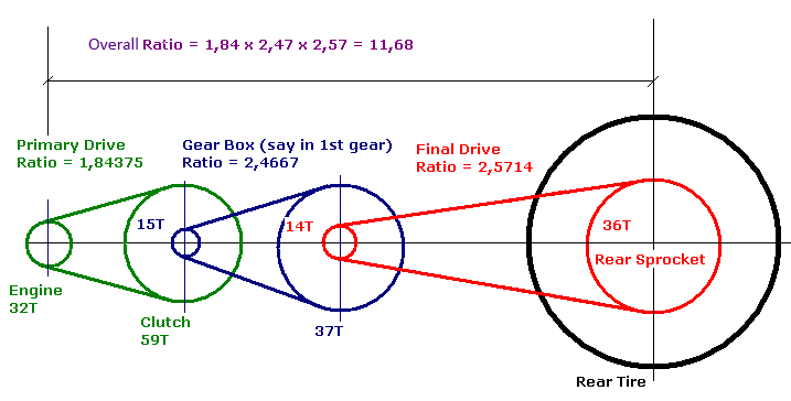

  7. Are you saying a larger front and smaller rear gives better acceleration?
  8. https://www.gearingcommander.com
    Gearing Explained
    The primary drive, the ratio between the engine (crankshaft) and the clutch or gearbox.
    • The gear box it self, depending on the amount of gears this part has an equal amount of ratio to choose from
    • The Final drive, (or secondary) ratio between the number of teeth on the Rear sprocket and the Front sprocket
    All these ratio combined results in the Overall Gearing Ratio of the power train: [​IMG]
    Changing any of these parts or changing the rear wheel tire's dimensions will effect speed and / or torque results. All of these changes can be simulated by using the GC by changing involved gearing fields. To be able to do this correct, all ratio, sizes and RPM's are necessary input.
    Top of page More info on Tire Circumference
    Back to Gearing Commander Main page
  9. No... the opposite. As I wrote.
