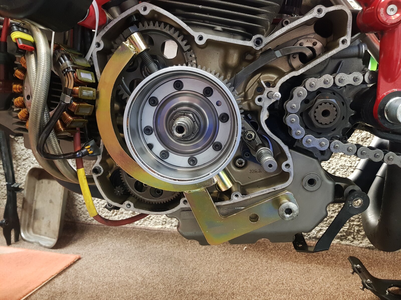

  9. Turning out to be the most long winded job ever...ordered the flywheel holder which, doesnt really fit....it was advertised as fitting a hypermotard, contacted the seller to see what he says. It kinda locks in but only on one side and only on one bolt....not sure if thats enough to hold it...

  11. You might get away with it but be careful when your hanging on that torque wrench.
    That tool is definitely not the correct one, it should be a good fit around the alternator.
  12. Yeah - it locks in alright....problem is, with the current climate sending it back and getting another one might not happen for a good long while as it all slows down....
  13. I would say it needs to locate both sides of the flywheel otherwise yoy risk bending the crank. If you undo it from the case can you get both flywheel location screws in equaly & use a drilled plate from the crankcase to the tool to hold it or re drill the tool arm to slign with the case hole?.
  14. It should have two screws that engage with the holes in the rotor. If you wind the one out that you have engaged, the angle of the crank will have to rotate anti-clockwise and you should be able to engage another screw ( if there is one) in the threaded boss at the 5 o’clock position.

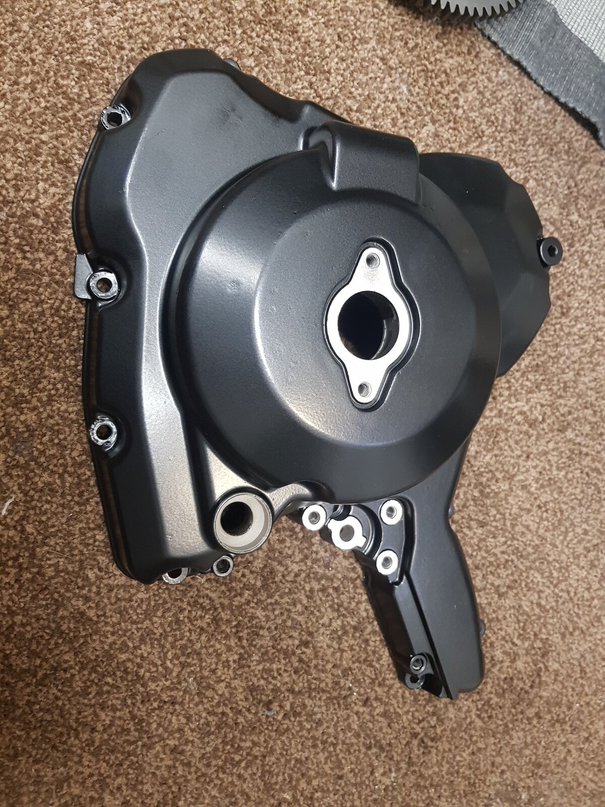

  15. Why did you remove the stator from the cover?
  16. cos im getting the cover re-coated
  17. Picked up the Uber torque wrench today, company i bought the flywheel holder from said there was one other size which i looked up which looked completely wrong so im a bit stuffed at the moment....find another or go with the half fitting one....

  18. Well, this has gone on from "how tight do those bolts go...?" Collected the powder coated generator case from Warren at RPA - absolutely amazing job....
  19. Andy, did you have this powder coated when you did the rebuild? What happened?
