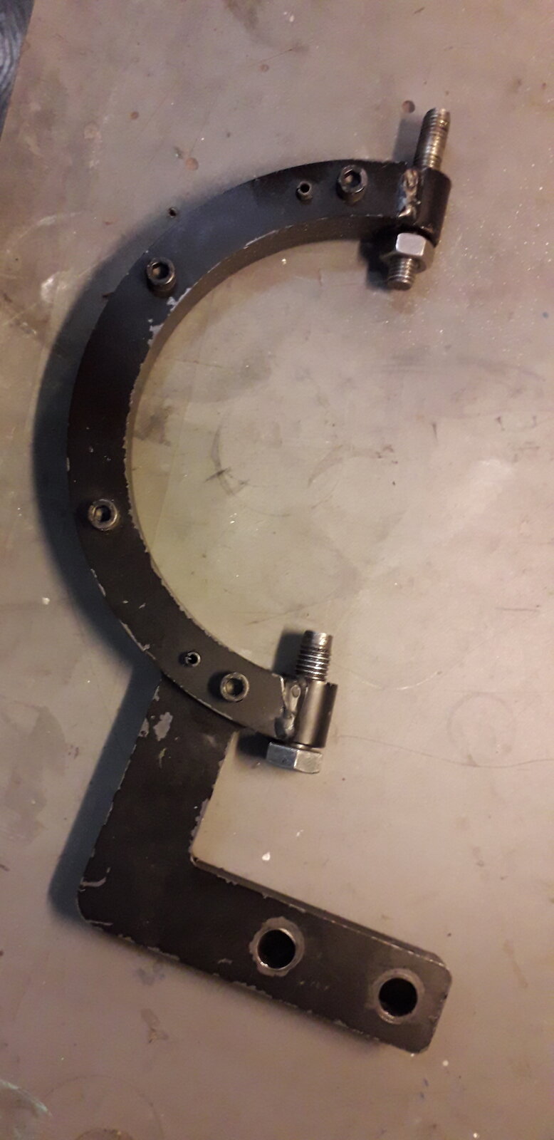

  2. Looking at the picture of the holding tool, does it not reach the rear bolt hole in the case if the bolt is backed out, & couldn't you get both screws in? I had to modify screws on the one i bought for it to all align.
  3. Yeah - i did - it was cerakoted but for whatever reason it reacted with the magnesium...no idea why as the other side is still perfect....
  4. I was looking at it this morning thinking just that....ill have a go at adjusting it tomorrow...thankyou sir for confirming what i was thinking...

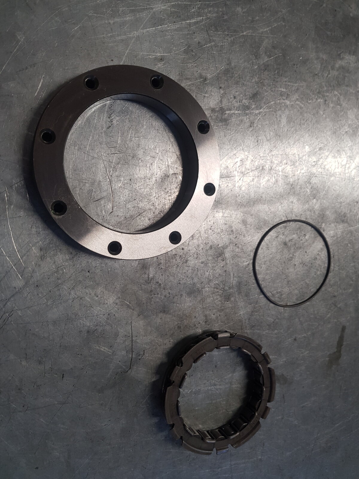

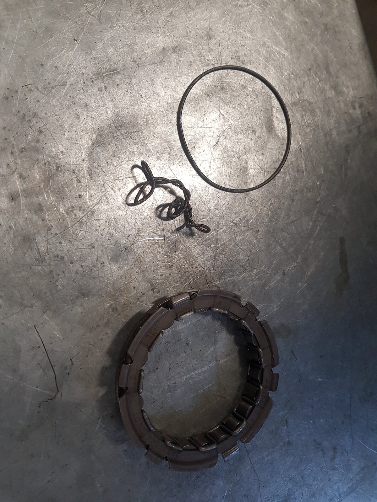

  6. Got back from Rich's (louigi moto) just had a bit of a lesson from the master....took the clutch sprag apart again....watching him doing that - now i know how to do it...! - heres some pics of the upgrade - apparently he does this to all engines he pulls apart...the sprung band is removed...
  7. And this is what happens to the metal band....where the engine heats up and cools down apparently the band stretches and goes baggy...like this...the rubber band (a ducati part from somewhere else on the bike) fits perfectly..and, so Rich says, lasts indefinately...!

  10. Interesting, as the 'rubber' band will heat cycle as well. Wonder how long they last?

    What im dreading is the 300+NM ive gotta put on that flywheel nut! the torque wrench i borrowed from the lad at work is about 2 1/2 ft long....
  12. Rich says he not had to change one yet...

  19. Be interesting to know what the rubber band comes from, it looks a bit like the viton fuel pump seal from the 748/916 bikes.
